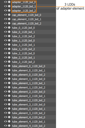

  1. Create several meshes for different LODs of your model: a detailed mesh for the closest LOD and a number of less detailed meshes for farther LODs.
    When naming the meshes, add a postfix to specify the LOD each mesh represents. For example: _lod_0 for the 1st LOD, _lod_1 for the 2nd LOD, etc.

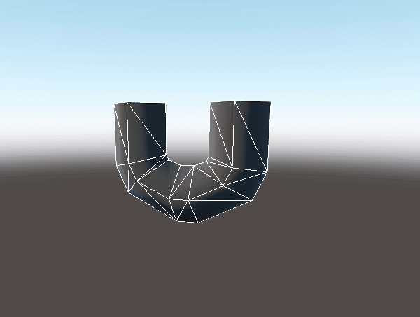

    For example, for each mesh representing an element of the tubes constructor (10 meshes), there are 3 meshes representing LODs:

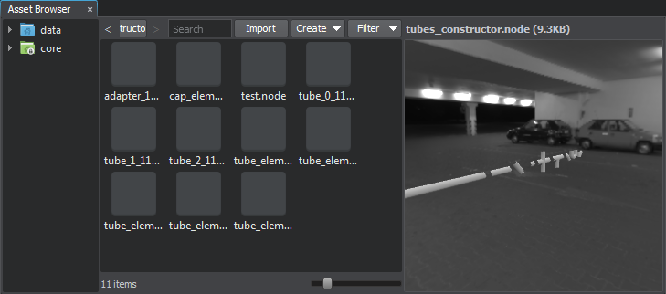

To import the model into UNIGINE, click Import in the Asset Browser and choose the exported FBX file. In the Import FBX window, perform the following to automatically create LODs based on the name postfixes:

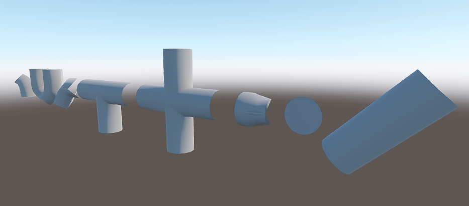

Add an exported model into the world as described here. All LODs will be already created and set up according to the specified import values:
Imported Tubes Constructor with LODs
FBX Added to the World

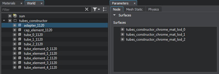

If required, adjust the LODs surfaces in the Node tab of the Parameters window:

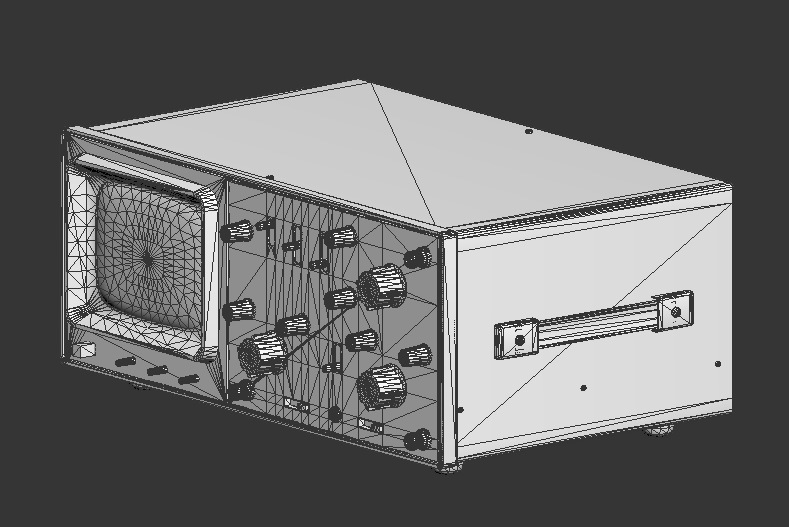

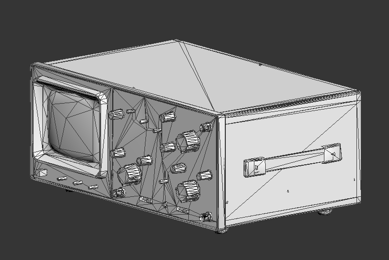

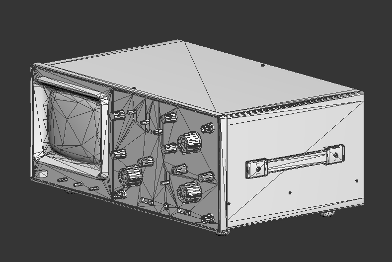

    As an example, we will use the model of an oscilloscope from Superposition benchmark (available via UNIGINE SDK Browser). This model already contains 3 LODs.
    10109 polygons 5004 polygons 2583 polygons
    LOD 0
    LOD 1
    LOD 2

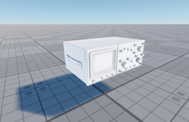

Add an exported model into the world as described here. By default, all surfaces (LODs) are visible at the same time:
Oscilloscope Model

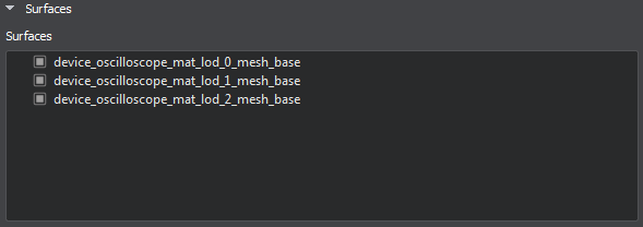

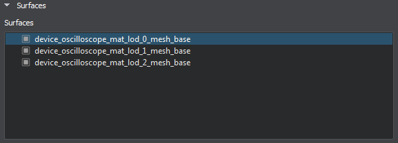

The surfaces of the exported model that represent LODs can be found in the Node tab of the Parameters window:
