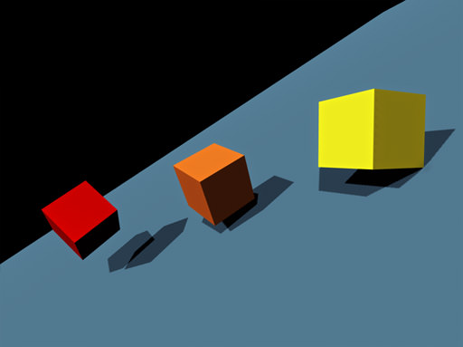

For example, the following illustration shows three boxes with different inertia tensors. The yellow box has very high inertia:
100         0         0
    0     100         0
    0         0     100
Because of that, it can only slide down when falling upon the tilted plane. The red box, on the contrary, has the lowest inertia and rotates most eagerly.
Different Inertia tensors
Different inertia tensors that override shape-based parameters
