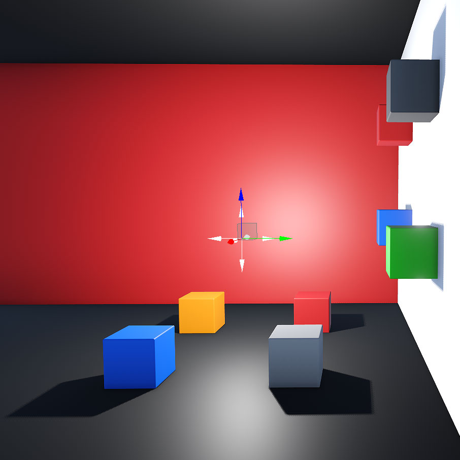

LightOmni (omnidirectional point light) | ![]() |
Emits light from a point source in all directions. | Emits light from a point source in all directions and uses a prebaked shadow cubemap for static objects lit by the Omni Light. |

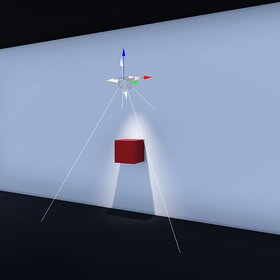

LightProj (projected light) | ![]() |
Emits light from a single point forming a focused beam aimed in a specific direction. | Emits light from a single point forming a focused beam aimed in a specific direction and uses a prebaked 2D depth texture to store shadows of static objects lit by the Projected Light. |

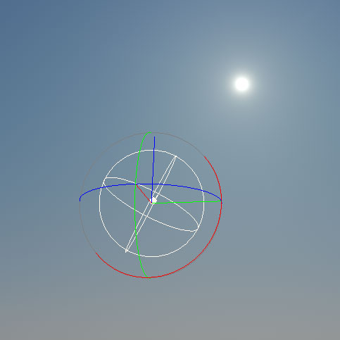

LightWorld (sun light) | ![]() |
Casts parallel beams onto the scene from an infinitely remote point. | - |

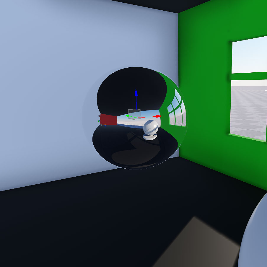

LightEnvironmentProbe (environment probe) | ![]() |
Grabs a cubemap each frame thus providing objects in the scene with dynamic reflections from a point source in all directions. | Uses a prebaked cubemap to provide objects in the scene with reflections from a point source in all directions. |

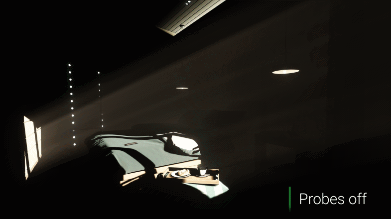

LightVoxelProbe (voxel probe) | ![]() |
- | Provides volume to bake lighting. Uses a prebaked voxel map to provide objects in the scene with indirect lighting from any light source. |
