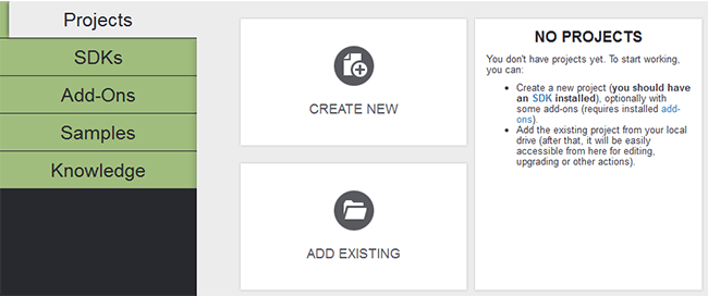

  1. Open the Projects tab in the SDK browser.

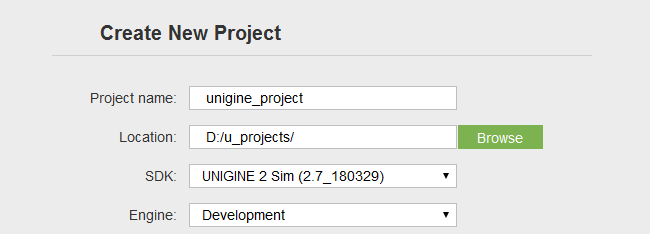

  2. Click Create New. The new project creation window will be opened.
  3. Define the name of the project, choose a path to store project files, specify the SDK and UNIGINE Engine build to be used.
    You can choose the Development or Release build of UNIGINE Engine:
    • The Development build includes additional features that can be useful for project's development (Microprofile, etc.)
    • The Release build allows checking the final performance of the application.
    The project will be created in the <project path>/<unigine_project> folder.

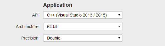

Application Settings#
The project can be created with the following application settings:
API Programming language to be used for project creation. The following APIs are available:
  • UnigineScript only - UnigineScript will be used to implement the project.
  • C++ - C++ API will be used to implement the project. Depending on the OS, you can choose the following project templates:
    • On Windows:
      • C++ (Visual Studio 2013/2015)
      • C++ (Qt-based) - Qt Creator, QMake or CMake is required for building the project.
      • C++ SDL2
    • On Linux:
      • C++ GNU Make
  • C# - C# API will be used to implement the project. The Visual Studio will be used to compile a project.

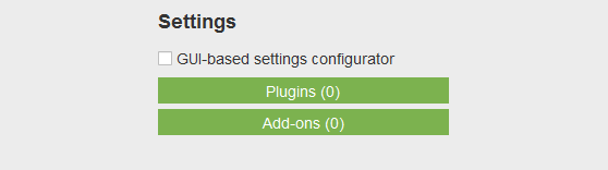

General Settings#
The project can be created with the following general settings:
GUI-based settings configurator Create a project with the launcher.
Click Plugins to specify the following:

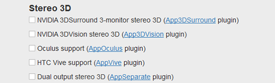

NVIDIA 3DSurround 3-monitor stereo 3D (App3DSurround plugin) Render the application across 3 monitors using the NVIDIA 3D Vision technology and multiple GPUs.
The App3DSurround plugin is available on DirectX 11 only.
NVIDIA 3DVision stereo 3D (App3DVision plugin) Render the application onto 1 monitor using NVIDIA 3D Vision technology.
The App3DVision plugin is available on DirectX 11 only.
Oculus support (AppOculus plugin) Create project with the Oculus Rift virtual display support.
HTC Vive support (AppVive plugin) Create project with the HTC Vive output support.
Dual output stereo 3D (AppSeparate plugin) Output 2 separate images for each eye.
The AppSeparate supports DirectX 11 only.

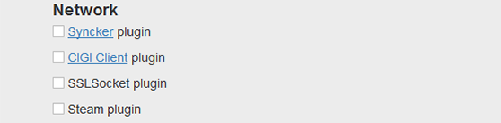

Syncker plugin Create a project with the Syncker plugin for multi-channel rendering synchronization.
CIGI Client plugin Create a project with the CIGI Client plugin.
SSLSocket plugin Create a project with the SSLSocket plugin.
Steam plugin Create a project with the plugin for Steam integration.

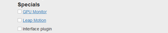

GPU Monitor GPU frequencies and temperature monitoring.
Leap Motion Tracking hands and fingers with Leap Motion
Interface plugin Create a project with the Interface plugin.

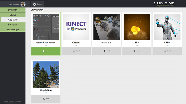

Add-Ons#
The project can be created including any add-on available in the Add-Ons tab. All of the required add-ons can be added both on and after project's creation.

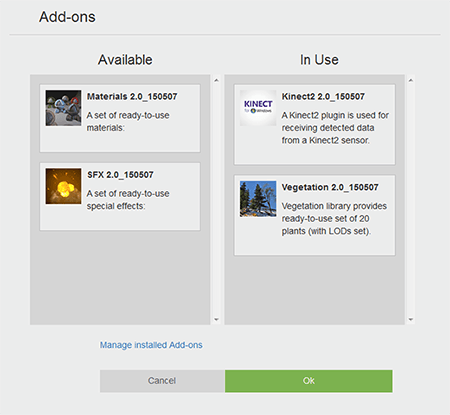

Specifying Add-Ons on Project's Creation#
To create the project with an add-on, you should do the following:
  1. Download the required add-on in the Add-Ons tab by clicking Install.
    Any amount of add-ons could be added to a project afterwards.
  2. On project creation, specify the add-ons to be included by clicking the Add-ons (0) button.
  3. Drop the required add-ons from the Available field to In Use. You can add any amount of add-ons to the project. After all add-ons are dropped, click Ok.
    If you haven't downloaded the add-on, click Manage installed add-ons. You will be redirected to the page with available add-ons.
  4. Click Create New Project. To enable added add-ons in the project, you should follow instructions on each add-on.

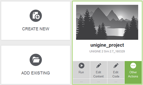

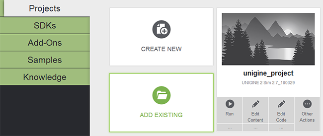

Adding Existing Project#
To add an existing project to the browser, do the following:
  1. Click Add Existing in the Projects tab.
  2. In the file dialog window that opens, specify the path to the project folder and click Import Project. The project will appear in the projects list.

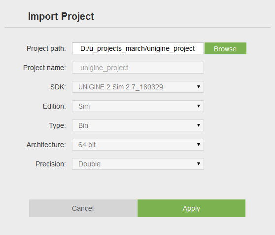

    If the project is created on UNIGINE 1, you will have to specify the following information on the project:
    Project name The name of the project.
    SDK The version of UNIGINE SDK used to create the project.
    Edition The edition of UNIGINE SDK used to create the project.
    Type The type of UNIGINE SDK used to create the project.
    Architecture The version of the release version of an application (32 or/and 64 bit).
    Precision he coordinates precision used to create the project.
    This information is required to create the .project file containing metadata associated with the project.

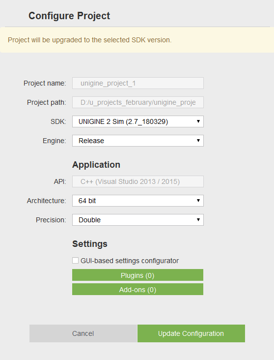

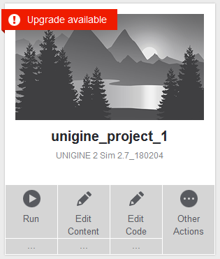

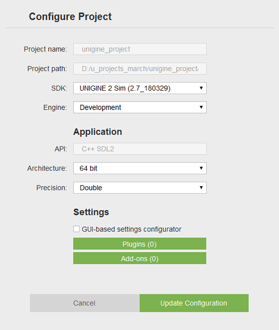

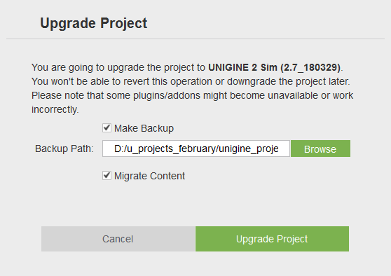

Upgrading Existing Project#
Projects that require upgrade are marked with the Upgrade available label:
To upgrade your project to the newest installed version of UNIGINE SDK, do the following:
  1. Click this label or Other Actions -> Configure Project. The following form will open:
  2. Choose the newest installed version of the SDK and click Update Configuration.
  3. Specify a path to the backup folder into which the original project will be copied. Leave Migrate Content checked and click Upgrade Project.
The project will be upgraded automatically. You can also manually upgrade the project by running the upgrade script. In both cases, the same script will be used.
The source code should be upgraded manually by using the Migration Guide.

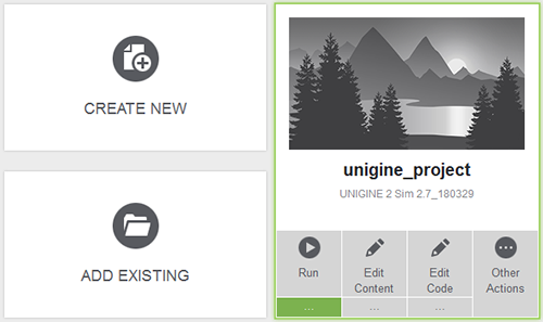

Running Project with Default Settings#
There are several options of running project with default settings:

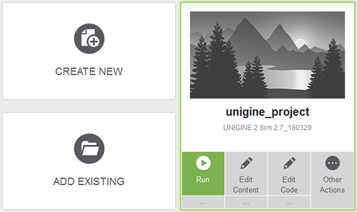

  • Run the project without the loaded editor by clicking Run:
  • Run the project with the loaded editor by clicking Edit Content.
Clicking Edit Content will only launch the Editor, you will have to load the world manually: via the console, via the File -> Open World in the Menu Bar of the UnigineEditor or by double-clicking the *.world file in the Asset Browser.
You can also use launchers created by default in the project folder:
  • launch_debug - the launcher of the project's debug version.
  • launch_editor - the launcher of the project's with the loaded editor.
  • launch_release - the launcher of the project's release version.
  • launcher - the startup file for the launcher that provides a GUI to configure application options and run the application. This launcher can be customized and used in the release version of your project. To create a project with the launcher, check the GUI-based settings configurator box in the project's creation window.

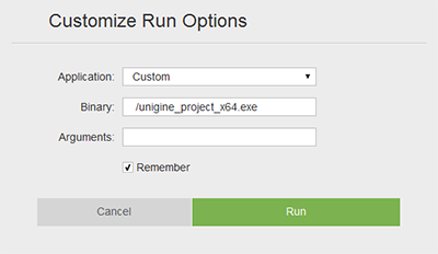

  • Run the project without the loaded editor by clicking an ellipsis under the Run button:
    In the Customize Run Options form that opens, set the required values and click Run.

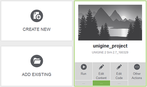

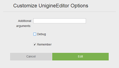

  • Run the project with the loaded editor by clicking an ellipsis under the Edit Content button:
    In the Customize UnigineEditor Options form that opens, set the required values and click Edit.
Clicking Edit Content will only launch the Editor, you will have to load the world manually via the console or via the File -> Open World in the main menu of the UnigineEditor.

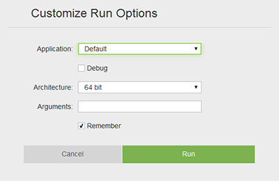

Customize Run Options#
Via this form the project without the loaded editor can be run with the custom settings.
Depending on the value of the Application option, different sets of options are available:
  • Default - the default main application (<project_name>_x*.exe) will be run:
    The default main application should be used when only UnigineScript is used to implement the project. In this case, the following options can be customized:
    Debug Indicates whether debug or release version of the application should be run.
    Architecture The version of the main application to run. Available values:
    • 32-bit - the 32-bit version of the main application.
    • 64-bit - the 64-bit version of the main application.
    Arguments Start-up command-line options.
    Remember Indicates whether to remember the specified custom settings for future run or not.
  • Custom - a custom main application will be run:
    This option should be chosen if the C++ or C# API is used to implement the project (besides UnigineScript). In this case, the following options can be customized:
    Binary Name of the custom main application. Here the name of the compiled binary executable located in the bin folder of the project should be specified. If the binary executable is located outside this folder, a path to it relative to the bin folder should be specified.
Customize UnigineEditor Options#
Additional arguments Start-up command-line options.
Debug The editor version (debug or release) that will be used for project's editing.

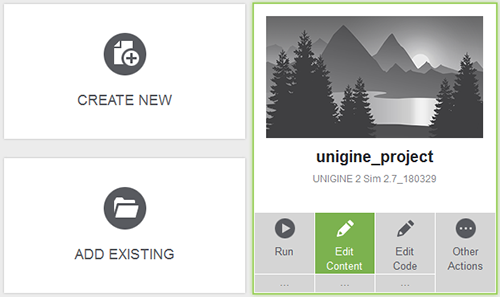

Editing Project#
To open the project for editing:

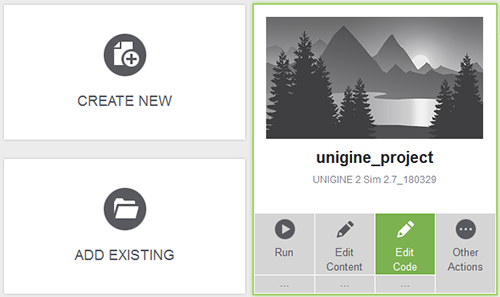

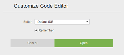

  • On Windows, click Edit Code:

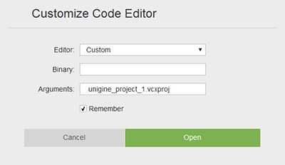

    The project will be opened for editing in an associated tool. To change a tool, click an ellipsis under Edit Code. By default, the following form will open:
    Choose Custom in the drop-down list and specify a path to a custom tool (e.g. IDE or editor) with required arguments:

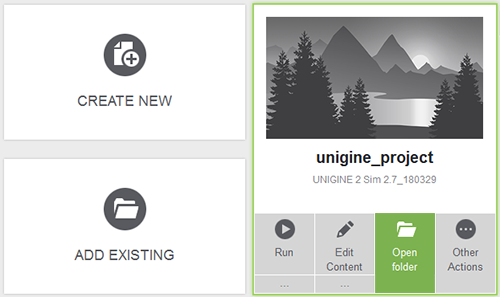

  • On Linux, click Open folder and then edit the code in an associated tool:
See the articles in the Programming Overview section to learn how to edit the opened project.

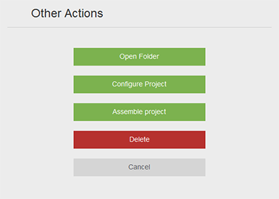

  1. Click Other Actions:

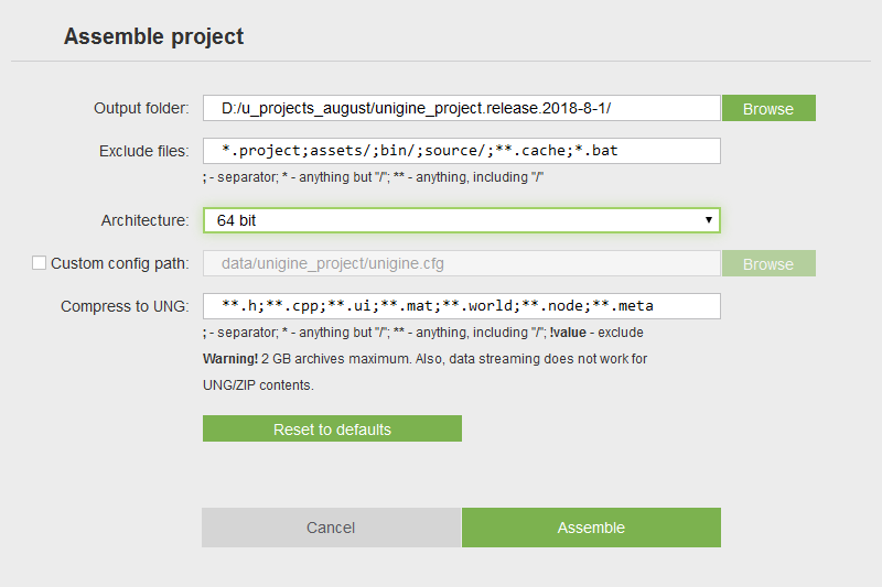

  2. Click Assemble project. The following form will open:
  3. Specify the required settings (see below) and click Assemble.
By default, the final build will include the following:
  • The data/.runtimes folder with all its contents.
  • The guids.db file stored in the data folder.
  • The source assets from the data folder with the valid *.meta files that have no generated runtime files.
    The *.meta files of such assets aren't included in the final build.
  • The *.umount files (mount points) that refer to the external directories.
    Keep files in the external directories unchanged to avoid issues in the assembled project.
    If you exclude the *.umount files, the referenced content won't be available in the final build, and the project will be invalid.
The source/, bin/ folders, the *.project and *.cache files, launchers are excluded from the final build by default.
The bin folder from the project folder is excluded. In the final build, there will be the bin folder storing the release version of the binary executable and the libraries.
Assembling Settings#
Output folder The release build destination folder.
You shouldn't create this folder inside your project folder, as it may significantly increase its size.
Exclude files Files and folders that should be excluded from the release build. Use the wildcards patterns to exclude the required items. By default, the following files and folders are excluded: *.project, *.cache, *.bat, *.sh files, bin/, source/ folders.
Files and folders stored in the data folder won't be excluded.
Architecture The release build architecture type.
Custom config path The path to the custom configuration file for the release build (optional).
Compress to UNG Types of files that should be compressed to reduce hard drive memory usage. This won't influence the engine performance much. Use the wildcards patterns to include/exclude the required items. The maximum size of the archive is 2 GB. By default, files of the following types are compressed: *.h, *.cpp, *.ui, *.world, *.node, *.mat, *.meta.
Data streaming doesn't work for UNG/ZIP contents.
Strip binaries
This option is available on Linux only.
Delete all debug information from the build binaries. This will reduce the binaries size without any performance cost.
Other Actions#
When clicking the Other Actions button, the following form opens:
Configure Project Change project settings.
Assemble Project Specify settings to be used for assembling the project.
Open Folder Open the project folder.
Delete Delete the project.
Updating Project Configuration#
When clicking Other Actions -> Configure Project, the following form opens:
Via this form you can change settings of an existing project: the UNIGINE Engine build used for the project, the version of the release application, the coordinates precision and the general settings. Also this option should be used when you need to upgrade the existing project to the newest version of the SDK.
Moreover, you can restore the project's files that were corrupted, missed or mistakenly modified. For this, you should leave settings in the form unchanged and press the Update Configuration button. In this case, the following files of the project will be restored (they will be copied from the SDK):
  • Binaries
  • core.ung, editor.ung and scripts.ung
  • Launchers
If some of the files listed above are changed, the .modified postfix will be added to names of such files. At that, the files from the SDK will also be copied.
