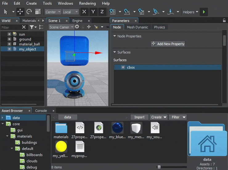

Let us use an example to illustrate this workflow.
Usage Example#
In this example we are going to manipulate nodes and assets linked to certain node using a property via C++, C# and UnigineScript.
Let us create a simple MeshStatic object named my_object, inherit a material from the mesh_base to assign to the surfaces of our object, and add some audio file (.mp3 or .oga) to our project.
So, we link a *.mesh file, a material, the material_ball node from the default world and an audio file using the property file described above.
In our code we will:
  • rotate the linked node
  • modify linked material and mesh and save changes
  • play a linked audio file

	// getting the node to which a property with links to assets is assigned
	my_node = engine.editor.getNodeByName("my_object");
	// getting the property, that will be used to acces all necessary files
	property = my_node.getProperty();
	// getting a material from the corresponding property parameter
	material = property.getParameterMaterial(property.findParameter("some_material"));
	// modifying the material
	material.setParameter("albedo_color", vec4(engine.game.getRandomFloat(0.0f, 1.0f), engine.game.getRandomFloat(0.0f, 1.0f), engine.game.getRandomFloat(0.0f, 1.0f), 1.0f));
	//saving modified material
	material.save();
	// getting the path to the mesh file from the corresponding property parameter
	string mesh_file_name = property.getParameterFile(property.findParameter("some_mesh"));
	//  creating and modifying a mesh by adding a box surface to it
	Mesh mesh = new Mesh(mesh_file_name);
	mesh.addBoxSurface("box", vec3(0.3f, 0.3f,2.0f));
	// saving the modified mesh back to the file
	mesh.save(mesh_file_name);
	// getting the path to the sound file from the corresponding property parameter
	string sound_file_name = property.getParameterFile(property.findParameter("some_file"));
	// getting a linked node from the corresponding property parameter
	param_node = property.getParameterNode(property.findParameter("some_node"));
	// creating and playing a sound from the file
	sound = new SoundSource(sound_file_name);
	sound.setMaxDistance(100.0f);
	sound.setLoop(1);
	sound.play();
	// reporting results to the console
	log.message("Path to mesh file: %s\nPath to sound file: %s\nNode ID: %d\n", mesh_file_name, sound_file_name, param_node.getID());
