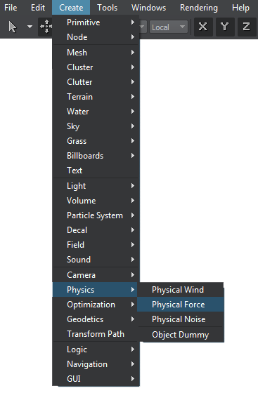

Adding Physical Force#
To add a physical force to the scene via UnigineEditor:
  2. On the Menu bar, click Create -> Physics -> Physical Force.
  3. Click somewhere in the world to place the physical force.

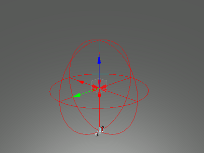

The new physical force node will be added to UnigineEditor and you will be able to edit it via the Parameters window. By default, the radius of the node is 1.

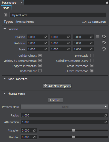

Editing Physical Force#
In the Physical Force section (Parameters window -> Node tab), you can adjust the following parameters of the physical force:

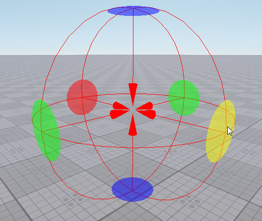

Edit Size Toggles the editing mode for the physical force node. When enabled, the radius of applying the physical force can be changed: each axis is highlighted with the colored circle. To change the radius along the axis, drag the corresponding circle.
Physical Mask Physical mask. The physical mask of the physical force must match the physical mask of the physical object. Otherwise, the physical force won't affect the object.
Radius Radius for applying the physical force in units.
Attenuation Attenuation factor indicating how much the physical force decreases when the objects move away from the force center.
Attractor Attraction force applied to objects in the physical force radius. If a positive value is provided, objects will be pulled away from the force point. If a negative value is provided, objects will be pulled up to the force point.
Rotator Rotation force that is applied to objects in the physical force radius. If a positive value is provided, objects will be rotated clockwise. If a negative value is provided, objects will be rotated counter-clockwise.
