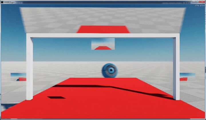

This example covers some aspects of using viewports and cameras as well as demonstrates 2 different ways of implementing mirrors:
  • Using the planar reflection option of the standard mesh_base material.
    Planar reflections don't reflect each other and miss post-effects.
  • Using the Viewport class to render an image from a certain camera to the TextureRender interface and then setting the texture as albedo texture of the mirror material.
Key features:
  • 3 rearview mirrors implemented using viewport texture rendering
  • large top rearview tilted mirror implemented using the planar reflection option of the mesh_base material.
  • 2 modes:
    • Single viewport for multiple cameras
    • Separate viewport for each camera
  • Keyboard control of car movement.

This approach is implemented here in the create_top_mirror() method, that creates the top rearview tilted mirror.

This approach is implemented here for all three small rearview mirrors.

		direction.z -= DELTA_ANGLE*ifps;
int Car::render()
	ViewportPtr viewport;
	for (int i = 0; i < 3; i++)
		MaterialPtr material = mirrors[i].mesh->getMaterialInherit(0);
		if (VMODE == MODE_VIEWPORT_MULTIPLE)
			// using a separate viewport for each camera
			viewport = mirrors[i].viewport;
		else if (VMODE == MODE_VIEWPORT_SINGLE)
			// using a single viewport for all cameras
			viewport = mirrors[1].viewport;
			// skipping post effects when using a single viewport for multiple cameras
			viewport->appendSkipFlags(Viewport::SKIP_POSTEFFECTS);
		// rendering
		RenderState *render_state = RenderState::get();
		// saving current render state and clearing it
		render_state->saveState();
		render_state->clearStates();
		// enabling polygon front mode to correct camera flipping
		render_state->setPolygonFront(1);
		// rendering and image from the camera of the current mirror to the texture
		viewport->renderTexture2D(mirrors[i].camera->getCamera(), mirrors[i].texture);
		// restoring back render state
		render_state->setPolygonFront(0);
		render_state->restoreState();
		// setting rendered texture as albedo texture for the material of the current mirror
		material->setTexture(material->findTexture("albedo"), mirrors[i].texture);
int Car::shutdown()
	car_frame.clear();
		mirrors[i].mesh.clear();
		mirrors[i].texture.clear();
		mirrors[i].camera.clear();
