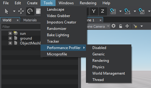

Activate Profilers#
To turn the profiler on, click Tools -> Performance Profiler and choose the required profiling mode:
You can also set a hot key (or a key combination) that will run the profiler in the Hotkeys section of the Settings window. However, you will have to create a custom preset. Then you can press this hot key for several times to cycle through profiling modes.
The following profiling modes are available:
  1. Generic profiler shows only the general statistics block.
  2. Rendering profiler shows the detailed rendering statistics and the timeline chart.
  3. Physics profiler shows the detailed physics-related statistics (within the Physics radius) and the timeline chart.
  4. World Management profiler shows the statistics on the whole loaded world.
  5. Thread profiler shows the statistics on loading threaded resources.

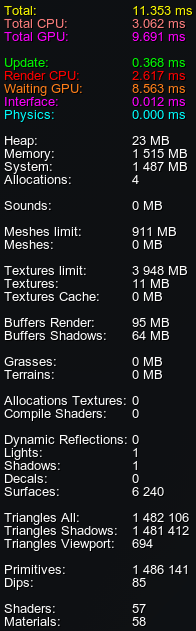

Rendering Profiler#
Rendering Profiler Enabled
The following statistics is displayed in addition to the generic one:
Sounds Memory amount, currently used for sound samples, in megabytes.
Meshes Limit Maximum amount of VRAM memory that can be used for mesh geometry, in megabytes.
Meshes VRAM m amount currently used for mesh geometry, in megabytes.
Textures Limit Maximum amount of VRAM memory that can be used for textures, in megabytes.
Textures VRAM m amount currently used for textures, in megabytes.
Textures Cache VRAM memory amount currently used for textures cache, in megabytes.
Buffers Render VRAM memory amount currently used for rendering buffers (Gbuffer, post-effects, etc.), in megabytes.
Buffers Shadows VRAM memory amount currently used for shadows maps, in megabytes.
Async Buffer Memory amount currently used for the async buffer, in megabytes. Intermediate buffer to which resources are asynchronously loaded during the streaming process.
Available for OpenGL only.
Async Buffer Indices Memory amount currently used for mesh indices buffer, in megabytes. This buffer is used to store indices of meshes asynchronously loaded during the streaming process.
Grasses VRAM memory amount currently used for grass nodes, in megabytes.
Terrains VRAM memory amount currently used for terrains, in megabytes.
Allocations Textures Number of memory allocations for textures during the frame.
Compile Shaders Number of shaders compiled during the frame.
Dynamic Reflections The number of dynamic reflections drawn per frame. In case of cubemap reflections, if all six faces are updated, six reflections are rendered each frame.
Lights Number of light passes rendered per frame. This means that the counter displays the number of all light sources that are currently seen illuminating something in the viewport. This value also includes additional passes for rendering lights in the reflecting surfaces (if dynamical reflections are used). Plain 2D reflection will multiply the number of rendering passes by two, while cubemap-based reflection with six faces updated each frame will multiply the number of rendering passes by six.
Each light redraws mesh polygons it illuminates. That is why the higher the number of light sources, the higher the number of polygons the graphics card has to render, and the lower the performance. For example, using two omni lights will as much as double the rendered geometry they shine on.
Shadows Number of shadow passes rendered per frame. Each light requires a shadow pass to calculate the shadows. Again, if there are reflecting surfaces with shadows drawn reflected, this will increase the number of shadow passes.
Decals Number of decals rendered per frame (in all rendering passes).
Surfaces Number of surfaces rendered per frame (in all rendering passes). Each light source doubles the number of surfaces if they are lit.
Triangles All Total number of triangles rendered per frameincluding all polygons that are currently visible in the viewport as well as the ones rendered in the process of shadows rendering.
Triangles Shadows Number of triangles rendered per frame in the process of shadows rendering. Each light source has to redraw the geometry it illuminates, increasing the overall count of rendered triangles. In order to avoid GPU bottleneck, keep the number of dynamic light sources and their radius as low, as possible.
Triangles Viewport Number of triangles rendered per frame. This includes all polygons that are currently visible in the viewport (geometry).
Primitives Number of geometric primitives rendered per frame. This includes points, lines, triangles, and polygons. The visualizer and the profiler itself also add to this counter. The value differs dramatically if tessellation is used. In this case, Triangles reports the number of triangles in the coarse mesh, while Primitives shows statistics on the number of tessellated primitives.
Dips The number of draw calls. The higher the number of identical mesh surfaces with the same material, the more effective the instancing is (enabled by default). This means, the number of draw calls is minimized offloading both the CPU and the GPU.
You can compare the number of surfaces ( Surfaces) and the number of DIPs used to render them. For example, if there are 30000 surfaces and 1000 DIPs, it means that 30 instanced surfaces of meshes are rendered per only one draw call (Surfaces/Dips). Thus the instancing provides performance boost.
Shaders Number of shaders set per frame. (Shaders are set in each of the rendering passes; hence if only one material used, its shader still needs to be set several times. When nothing is visible and the screen is black, even in this case the composite shader is still used.)
Materials Number of materials set per frame. (Materials are set in each of the rendering passes.)
Values less then 1 Mb are displayed as 0.

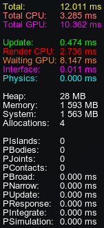

Physics Profiler#
This profiler shows statistics within the Physics radius.
Physics Profiler Enabled
To show valid information on
  • PUpdate
  • PResponse
  • PIntegrate
the physics simulation should be run in the single-threaded mode ( physics_threaded console command should be set to 0 or 1).
PIslands Number of physical islands within the physics radius that could be calculated separately. The lower this number, the less efficient multi-threading is, if enabled.
PBodies Number of bodies within the physics radius.
PJoints Number of joints within the physics radius.
PContacts Total number of contacts within the physics radius; this includes contacts between the bodies (their shapes) and body-mesh contacts.
PBroad Duration of the broad phase of physic simulation when potentially colliding objects are found.
PNarrow Duration of the narrow phase when exact collision tests are performed.
PUpdate Duration of the update phase when objects are prepared for their collision response to be calculated.
PResponse Duration of the response phase when collision response is calculated and joints are solved.
PIntegrate Duration of the integrate phase when physics simulation results are applied to bodies.
PSimulation Duration of all simulation phases added together.
