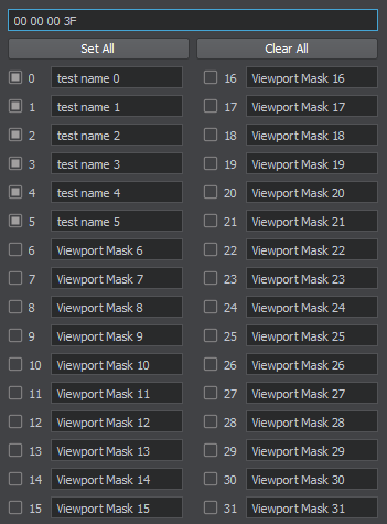

To specify the mask, click the corresponding mask button (Viewport, Shadow, Intersection, etc.) and enable required bits of a 32-bit mask. Enabling a bit means setting the value of 1 (when disabled, the value is 0). The resulting mask is displayed as hexadecimal characters on the top of the context menu window. The name of selected bit or bits is displayed on the mask button.
To collapse the context menu, click the mask button once again.
The material mask stores 24 bits. All other masks store 32 bits.

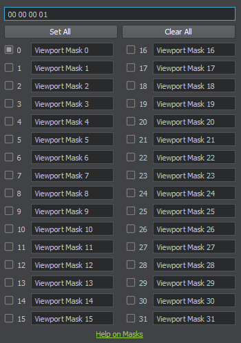

Surface viewport mask
Bit mask with the first bit turned on
  • Set All turns on all the bits in the mask
  • Clear All turns off all the bits in the mask
Default names of bits can be changed. The name entered in a field is assigned to a selected bit in all masks of this type. For example, if you assign a name to the first bit of the Viewport Mask of a surface, the same name is displayed for the first bit of the Camera Viewport Mask. Bit masks names are assigned locally and stored in the <Project Name>/data/default.bitmasks file, which is created when you open your project in UnigineEditor for the first time.

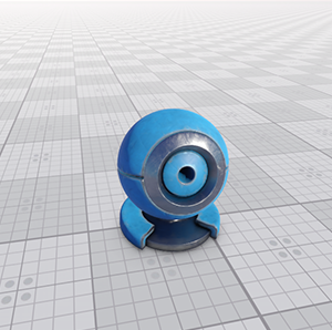

Suppose, we have two objects with the same material. To make one of them to be rendered into viewport and the other one — not to be rendered, we should change the viewport mask of the second object.
In the surface viewport masks of both objects, the same bit Viewport Mask 0 is enabled (00000001)
For the first object, all bits of the surface viewport mask are disabled (the mask is set to 00000000)
See the demonstration of how to set rendering into viewport and one more usage example in ourvideo tutorial on bit masking.

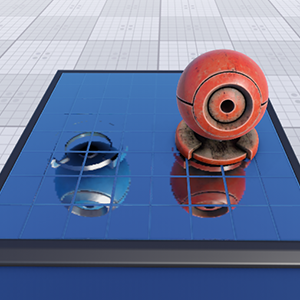

Usage Example#
Suppose, you have a reflecting surface and two objects reflected in this surface.
  • To render an object without a reflection, either its viewport mask or its material's viewport mask should have no matching bits with the planar reflection's viewport mask or the camera's reflection viewport mask.
  • To render a reflection without an object, the object's viewport mask or its material's viewport mask should have no matching bits with the camera's viewport mask.
In the example below, masks are given in the binary representation. For convenience, let's assume that objects and their materials have identical viewport masks. For masks to match, they should share 1 in the appropriate bit position. You can convert these masks to the hexadecimal number representation and set the obtained values via UnigineEditor.
An object without the reflection
A reflection without the object

In the first example, the object's viewport mask doesn't match the camera's reflection viewport mask. However, it matches the camera's viewport mask, so the object is rendered.
In the second example, the object's viewport mask doesn't match the camera's viewport mask. However, it matches the camera's reflection viewport mask and the planar reflection's viewport mask, so the reflection is rendered.

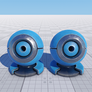

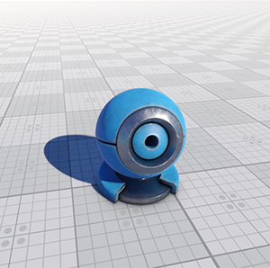

The example below demonstrates the difference. On the left, the shadow masks of the surface and its material have all bits enabled, thus they have one bit matching the shadow mask of the light source, and the shadow is rendered. On the right, the shadow masks of the surface and its material don't match the shadow mask of the light source, so the shadow isn't rendered.
Shadow mask of the surface and its material
Shadow mask of the light source
