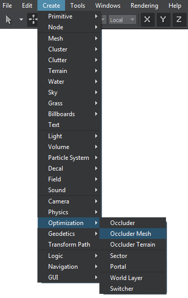

When the mesh is prepared, you can add the occluder mesh to the scene via UnigineEditor:
  2. On the Menu bar, click Create -> Optimization -> Occluder Mesh.
  3. In the file dialog window, choose a mesh (*.mesh) on which the occluder will be based.
  4. Place the occluder mesh in the world and specify the required parameters for it.

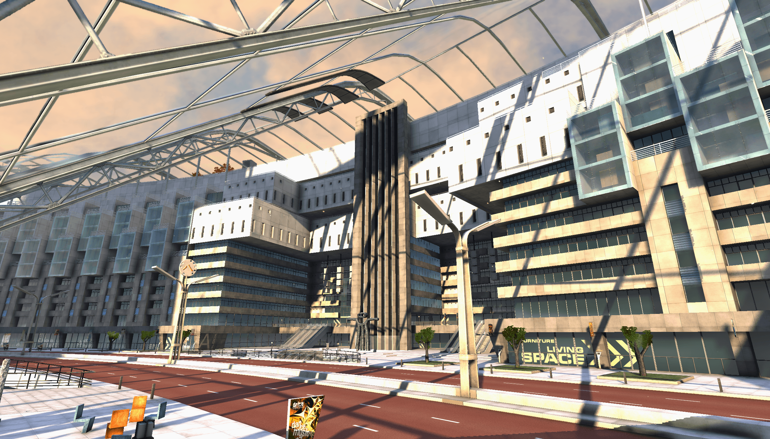

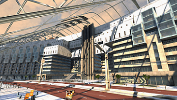

A mesh that represents a building and contains a lot of details

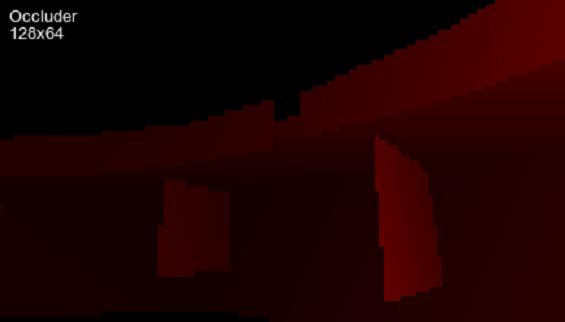

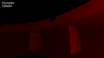

An occluder that is based on the simplified mesh and is rendered into a separate buffer with a low resolution

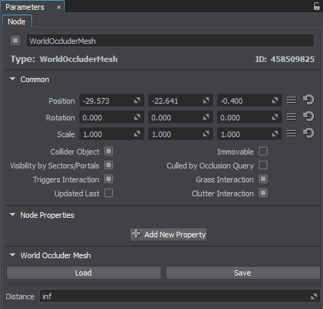

In the Node tab of the Parameters window, you can adjust the following parameters of the occluder mesh:
Distance Distance between the camera and the bounding box of the occluder, at which the occluder mesh becomes disabled. For example, you should disable the occluder at a certain distance if it stops hiding the objects and their surfaces in order to increase performance. By default, the inf value is used.
