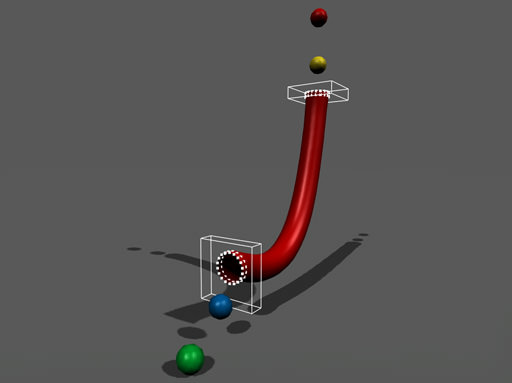

On the picture below you can see a dummy object with a dummy body and without any collision shape. It pins the physical cloth so it can hang without any rack. At the same time, it does not collide with balls that roll through it.
Dummy body
An invisible dummy body (with assigned shape) used to pin a cloth body to
