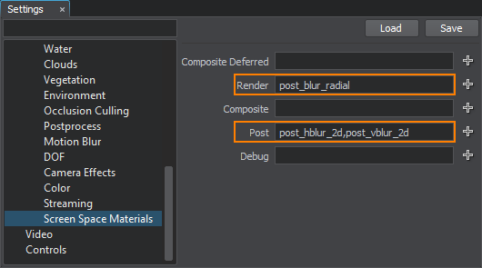

  3. Open Settings -> Screen Space Materials and write the name of the postprocess material you want to apply, in the Render or Post field, depending on the order it should be rendered in.
    • A postprocess material set in the Render field will be rendered before any other postprocesses (such as HDR, DOF, etc.) are applied.
      For example, we don't want subsurface scattering to be applied after the HDR blur. If we specify post_filter_scattering in the Render field, sub-surface scattering is rendered first and HDR is applied after it.
    • A postprocess material set in the Post field is rendered in the very end, after everything else has already been drawn. For example, such postprocess would also affect the color of glowing areas or HDR flares.
    If you want to use several postprocess materials at the same time, separate their names in either of these fields by a comma with no whitespace, and these materials will be rendered in the order they are positioned in the field.
    Copy postprocess materials into Render or Post field in Render settings

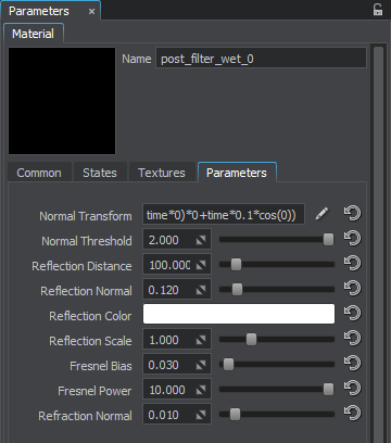

  4. The postprocess material settings can be modified in the Parameters tab of the postprocess material.
