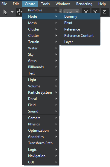

To add a dummy node to the scene via UnigineEditor do the following:
- Run UnigineEditor.
- On the Menu bar, click Create -> Node -> Dummy.
- Place the dummy node somewhere in the world.
