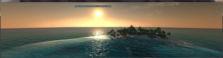

AppSurround on three monitors
AppSurround output onto three monitors
