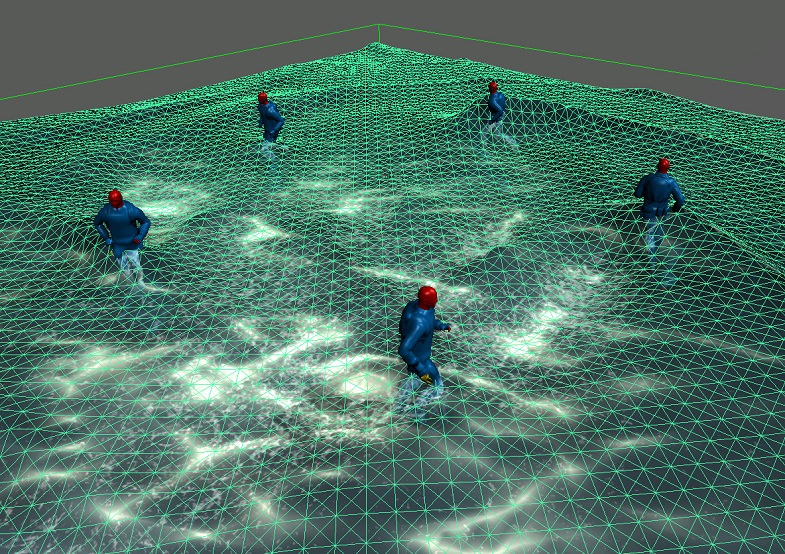

Two-way dynamic interaction provides both physically and visually convincing simulation of the waves from the physical bodies as they disturb the fluid. Imagine the moving boat that forms a wake behind it, or the character that ripples the water as the he wades through (see the picture above).

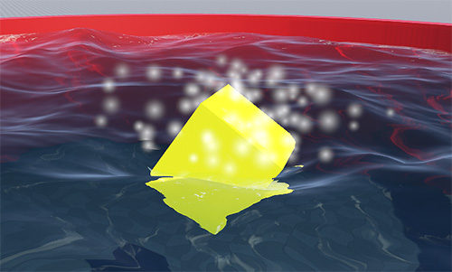

Emission of Particles#
It is possible to create an additional visual effect of small droplets, splashes or bubbles on the water when objects fall into it. To enable this effect perform the following steps:
  1. Create a particle system effect by clicking Create -> Effect -> Particle system in the main menu of the UnigineEditor.
  2. Go to the Particles tab in the Parameters window.
  3. In the Dynamic section choose a spark emitter to spawn particles by selecting Emitter -> Spark.
  4. Make particle system a child of the water mesh object.
Particles will be generated only when the object first contacts the water surface, while already submerged bodies will float without generating them.
Effect of water splashes
An example illustrating this effect can be found here.

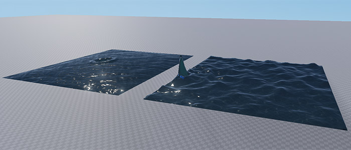

Water body absorption: enabled(left) and disabled(right)
