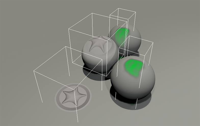

Orthographic decals
These decals are always of the same size regardless of the projection box location relatively to the projection surface.

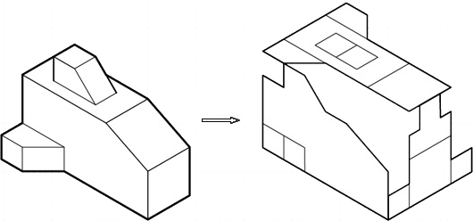

Orthographic projection is a form of parallel projection, where all the projection lines are orthogonal to the projection plane, resulting in every plane of the scene appearing in affine transformation on the viewing surface.

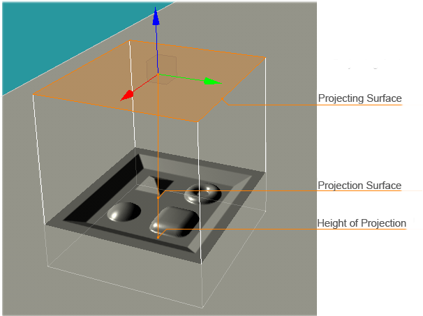

Orthographic decals are the most reliable ones as projected from a surface and cannot cause unexpected artifacts (as may perspective projected decals).
Orthographic Projection Box

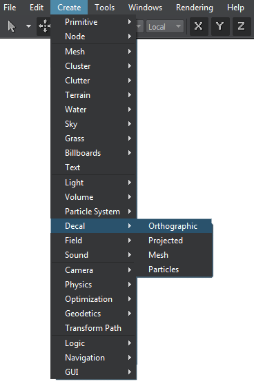

  1. On the Menu bar, choose Create -> Decal -> Orthographic.

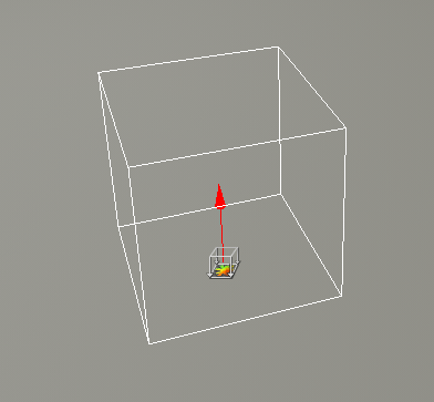

  2. Place the decal on the existing surface (for the decal to be projected, the projection box should intersect the surface) and specify the required settings:
    Placement of the Orthographic Decal

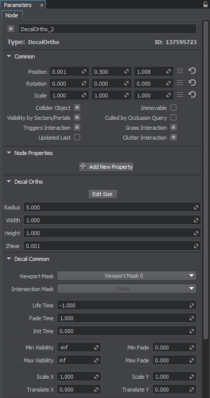

In the Node tab of the Parameters window, you can adjust the following parameters of the orthographic decal:
Decal Ortho tab
Decal Ortho#
Projection parameters of the orthographic decal:
Radius The length of the projection box along the Z axis, in units.
Radius = 0.5
Radius = 1
The second case shows that the decal is projected only if its projection box intersects the surface.
Width The length of the projection box along the X axis, in units.
Height The length of the projection box along the Y axis, in units.
ZNear The value of the near clipping plane, ranging from 0 to 1.
Decal Common#
Parameters common for all types of decals:
Bit Masks#
Viewport Mask A viewport mask, specifying if the decal can be seen in the camera's viewport.
Intersection Mask The decal's intersection mask is used paired with the cutout intersection mask of clutters and grass to cut out the clutter or grass in the areas of intersection with the decal (e.g. can be used to remove grass from the surface of a road projected using decal).
You can specify a shadow mask and a material mask in the decal_base material.
Life-Time Parameters#
Life-time and fade-out parameters:
Life time A time period during which the decal is projected, in seconds.
Fade time A time period during which the decal fades away (after its life time exceeds), in seconds.
Init time A time period after which the decal is projected, in seconds.
Visibility Parameters#
Parameters controlling decal's visibility depending on the distance:
Min visibility A minimum visibility distance, starting at which the decal begins to fade in and then becomes completely visible, in units.
Min Fade A minimum fade-in distance, across which the decal smoothly becomes visible due to the alpha fading. It is counted starting from the minimum visibility distance value, in units.
Max visibility A maximum visibility distance, starting at which the decal begins to fade out until becomes completely invisible, in units.
Max Fade A maximum fade-out distance, across which the decal smoothly becomes invisible due to the alpha fading. It is counted starting from the maximum visibility distance value, in units.
Texture Coordinates Transformation#
Decal's texture coordinates transformation (a texture atlas can also be used):
Scale X A texture scale along the X axis. For example, by the scale of 2 the texture is repeated twice on one decal.
Scale Y A texture scale along the Y axis.
Translate X A texture offset along the X axis. For example, by the offset of 0.5 along the X axis the texture is repositioned to the right (so that the edge of the texture is rendered in the center).
Translate Y A texture scale along the Y axis.
Setting a Material#
A material selection:
Material A new material of the decal.
