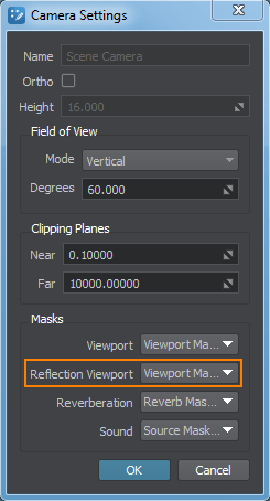

  2. Open the Camera Settings window and enable the selected bit in the Reflection Viewport mask of the camera.

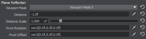

  3. In the Materials Hierarchy, select the reflective material and enable the same bit in the Planar Reflection Viewport Mask in the Parameters tab of the Material Editor.

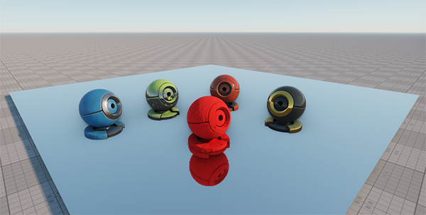

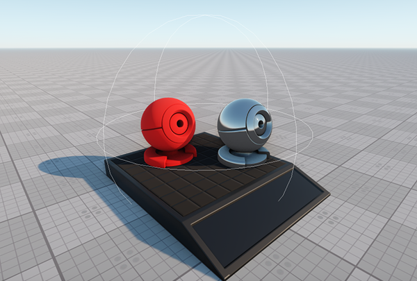

    In the picture below, the reflection viewport mask of the plane has the same matching bit (or bits) with the camera reflection viewport mask and the viewport masks of the red material ball and its material. The viewport masks of the other material balls don't have a matching bit with the reflection camera viewport mask and/or with the planar reflection viewport mask and, therefore, they aren't reflected:
    Masked planar reflection

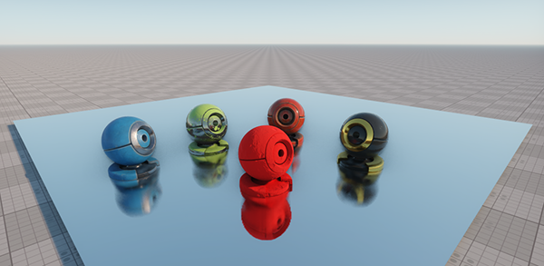

  7. Enable Screen Space Reflection to produce reflections of other nodes in the scene: on the Menu Bar, toggle the Rendering -> Features -> SSR option on.
    The SSR effect should be also enabled for the reflective material: go the Post Processing section of the States tab and check if the SSR option is enabled.
    Masked planar reflection + SSR

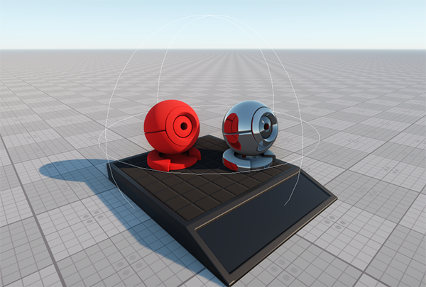

In the left picture below, the reflection viewport mask of the environment probe matches the camera's reflection viewport mask and the viewport masks of the red material ball and its material. In the right picture, the reflection viewport mask of the environment probe doesn't match the camera's reflection viewport mask:
Masked reflection provided by environment probe

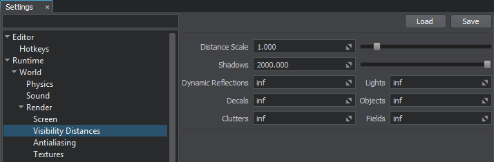

  1. In the Menu Bar, choose Windows -> Settings and go to the Visibility Distances section of the Settings window that opens.
  2. For the Dynamic Reflections parameter, specify the distance from the camera, starting from which the reflections aren't rendered.
