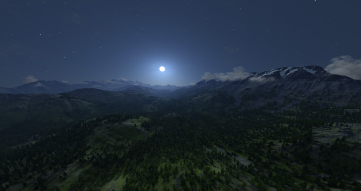

Curved Panorama
180 degree panorama with curved edges on 1 monitor

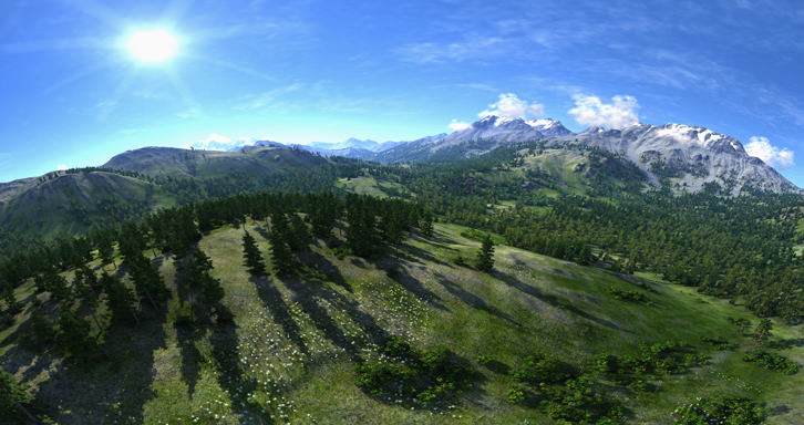

Linear Panorama#
Linear Panorama
180 degree linear panorama on 1 monitor

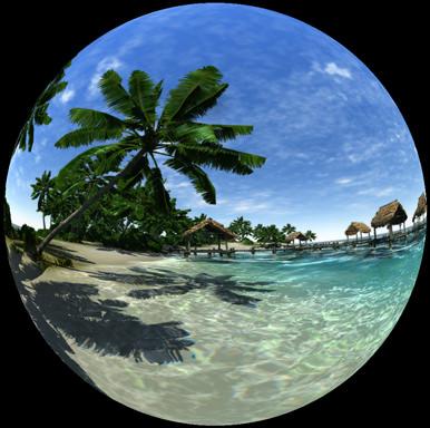

Fisheye#
Fisheye
180 degree spherical panorama

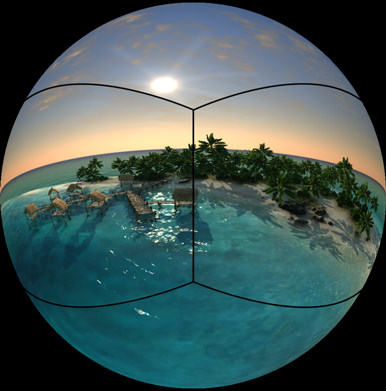

During panoramic rendering 4 viewports are seamlessly stitched into one for extra-wide field of view. Images are overlapped and blended along the border shown below.
4 viewports of panorama
Four viewports used to render panorama

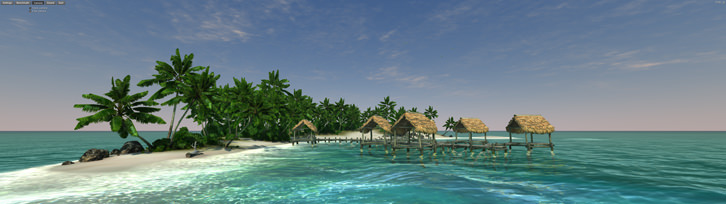

Multi-Monitor Mode#
It is also possible to span panorama across several identical monitors (only) in the fullscreen mode without decorations. For that, you need to specify on the start-up:
  • The summed resolution of two displays (for example, for two 1280x1024 displays, that would be 2560x1024)
  • video_fullscreen 2
For example (do not forget to specify other required start-up options):
Shell commands
main_x86.exe -video_mode -1 -video_width 2560 -video_height 1024 -video_fullscreen 2
Curved Panorama
