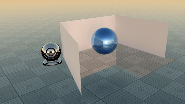

  • Box projection - works better for indoor scenes (when the room has a 3D box shape) or box-shaped outdoor scenes (back alley between buildings).
  • Spherical projection - works better for all other cases (reflections on car, spherical room, etc.).

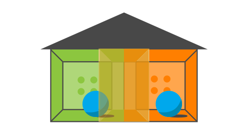

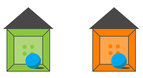

We have two houses with different color of the interior and put same objects (with reflection material, for example, metal) into these houses. What will happen?
If we don't speak about the dynamic reflections, you'll need to reflect the interior on each object. But interiors have different ambient color, and that is why you'll need to create 2 different materials for them. Not optimized at all.
Environment probes remove this flaw. Once you added an object, you don't think about the reflection material for it. The environment probe will map the cubemap to the object.

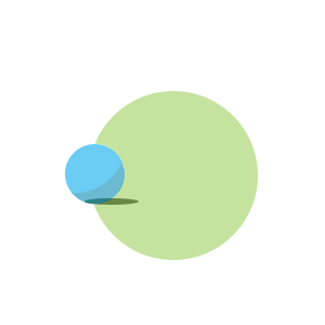

There is a difference in mapping cubemaps to transparent and non-transparent objects:
  • If an object is transparent, the environment probe will map the cubemap only if the entire object is inside the radius of the environment probe. Otherwise, the object won't be affected by the environment probe at all.
  • If an object is non-transparent, the environment probe will map the cubemap to any part of the object which is inside the radius of the probe.
Transparent object affected by environment probe
Non-transparent object affected by environment probe

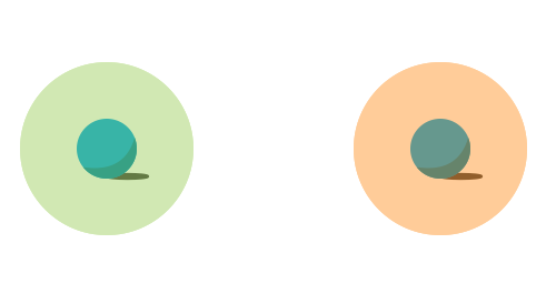

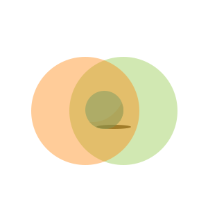

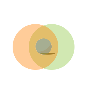

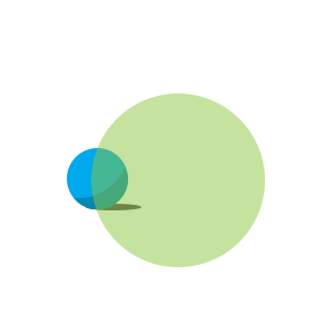

If you put several environment probes that affect a non-transparent object (rendered in the deferred pass) their cubemaps will be blended smoothly. Here is an example, a long corridor which has walls painted in different colors.
We put two environment probes and both of them affect the object (when the object will be in the intercrossing area). When you have large locations, you should use several environment probes instead of one to make the final image more realistic.

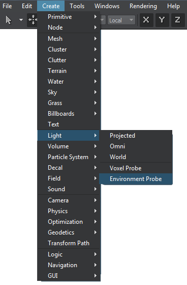

To add an Environment Probe object to the scene via UnigineEditor, do the following:
  2. On the Menu bar, click Create -> Light -> Environment Probe.
  3. Place the environment probe.
  4. Grab the cubemap texture for the environment probe. You can grab it in the Node tab of the Parameters window or you can bake lighting.
  5. Adjust the environment probe settings.

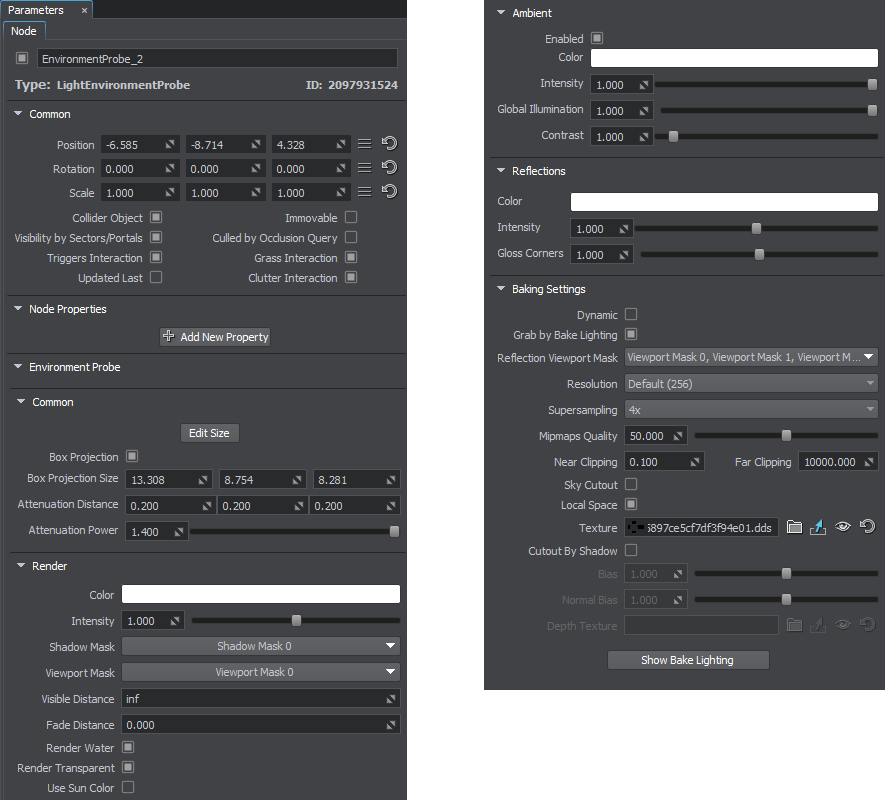

Environment Probe Settings#
The environment probe settings can be found in the Node tab of the Parameters window. This tab includes both the common parameters and the parameters specific for the environment probe. The specific ones are described below.

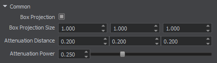

Common Parameters#
Box Projection Enables box projection mode for the Environment Probe.
Box Projection Size Specifies the size of the box projection.
Attenuation Power Sets the attenuation power for the light.
Attenuation Distance Sets the attenuation distance for the light.

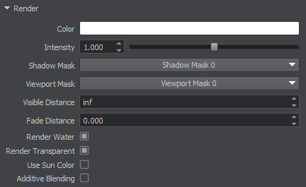

Render Parameters#
Color Sets the light color in the RGBA format. The color defines both the plausibility of virtual representation and its aesthetic component.
Intensity Sets the light color multiplier, which provides fine control over color intensity of the emitted light:
  • The minimum value of 1 corresponds to the least saturated light color.
  • The maximum value of 100 equals the most bright and intense color.
Shadow Mask The shadow mask controls rendering of a shadow cast by an object lit by a light source.
Viewport Mask Sets the viewport mask for the light.
Visibility Distance Distance from the camera, in units, up to which the environment probe will be rendered.
Fade Distance Distance from the camera, in units, starting from which the environment probe starts to fade out gradually.
Water Renders the environment probes on water.
Transparent Renders the environment probes on transparent object.
Use Sun Color Enables the influence of sun light color on the environment probe.
When enabled, this option makes the environment probe color black at night, or orange at sunset.
Additive Blending Enables the additive blending mode for the environment probe. This option offers more flexibility in lighting and reflections control. You can use it to blend lighting and reflections of several environment probes together and control them separately.

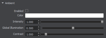

Ambient Parameters#
Enabled Enables ambient ligting for the Environment Probe. By default, Environment Probes are used for reflections only, as for lighting, it is recommended to simulate it using Voxel Probes. This approach ensures the best result, however you can still use Environment Probe for ambient lighting by enabling this option.
Color Sets the color of ambient lighting.
Intensity Sets the intensity of ambient lighting.
This parameter is used for manual adjustment in case if resulting intensity is too high or insufficient.
Global Illumination Enables the global illumination simulation. Environment probe generates fake GI by using given cubemap.
Contrast Sets the contrast of ambient lighting.

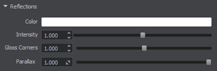

Reflection Parameters#
Color Sets the color of environment probe's reflection.
Intensity Sets the intensity of environment probe's reflection. 0 value means no reflection.
Gloss Corners Sets the intensity of reflection gloss near the box projection corners.
This parameter is available for box projection only.
Parallax
Parallax correction enables rendering of reflections taking into account the camera's position. When this option is disabled, reflection cubemaps are simply projected onto objects, and do not follow the viewer's perspective.
  • 0 (minimum) - parallax correction is disabled (reflections will look like objects are infinitely distant).
  • 1 (maximum) - parallax correction is enabled (reflections will look like objects are at the distance close to the radius of the environment probe).
  • Values in-between represent a linear interpolation factor for parallax correction and are to be set when the environment probe is used to fit a medium or small object into the environment for additional correction, if necessary.
  • This parameter is available for spherical projection only (Box Projection option must be disabled).
  • Parallax correction does not affect reflections on transparent objects.

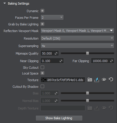

Baking Settings#
Re-grab the cubemap texture, when you make changes to these parameters
Dynamic Specifies if the reflection is dynamic.
The Dynamic Reflections option should be enabled: Rendering -> Features -> Dynamic Reflections.
Faces Per Frame Cubemap update interval.
Available for dynamic mode only.
  • 1 - Refresh only one face every frame.
  • 2 - Refresh two faces every frame.
  • 3 - Refresh three faces every frame.
  • 4 - Refresh four faces every frame.
  • 5 - Refresh five faces every frame.
  • 6 - Refresh all six faces every frame.
Grab by Bake Lighting Specifies if the cubemap texture is to be modified by the Bake Lighting Tool.
Reflection Viewport Mask The mask that controls rendering of the environment probe's reflections into the reflection camera viewport.
Resolution Resolution of the reflection texture, in pixels.
Setting too high resolution on a low-performance GPU with low memory capacity may cause engine crash.
Supersampling Number of samples per pixel used for image grabbing supersampling.
Mipmaps Quality Quality of mipmaps.
Setting too high quality on a low-performance GPU with low memory capacity may cause engine crash.
Near Clipping Distance to near clipping plane for image grabbing.
Recommended value for rooms is 0.01.
Far Clipping Distance to far clipping plane for image grabbing.
Recommended value for rooms is 1000.
Sky Cutout Cut out sky rendering in the environment probe and renders dynamic reflection instead of the sky.
This parameter can be used to render changes of the sky gradient in a window, when the time of the day changes.
Local Space Enable local space (local coordinates) for environment probes. Can be used for scenes with moving objects.
It is recommended to use this parameter, if you plan to rotate the environment probe after baking.
Texture Cubemap texture for reflection.
Every bake lighting procedure makes changes to the asset selected in this field when the Grab by Bake Lighting mode is enabled.
You can leave the field empty to avoid losing content. In this case a new generated lighting texture will be set for this parameter after the bake lighting procedure. Generated textures are stored in the data/bake_lighting folder.
Cutout By Shadow Enables clipping of reflections occluded by obstacles (located in shadowed areas relative to the light source). This feature uses the depth texture grabbed for the environment probe to determine reflections that should be visible.
This feature does not work with Dynamic option enabled and does not clip reflections for transparent objects.
When enabled the three parameters listed below (Bias, Normal bias, and Depth Texture) are available.
Bias Bias that is used to correct inexact shadowing of the scene objects for the Cutout By Shadow feature. It controls the depth offset added to the current depth value stored in the shadow map. Similar to Bias parameter for shadows.
Normal bias Bias obtained for the Cutout By Shadow feature by shifting the surface on which the shadow falls. The surface is shifted along normals stored in the normal map. Similar to Normal Bias parameter for shadows.
Depth Texture Depth texture used for clipping reflections occluded by obstacles.
This texture is static and requires re-generation each time the position or size of the environment probe are changed.
