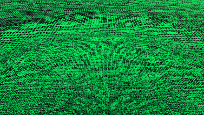

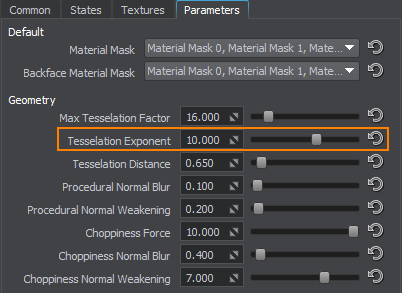

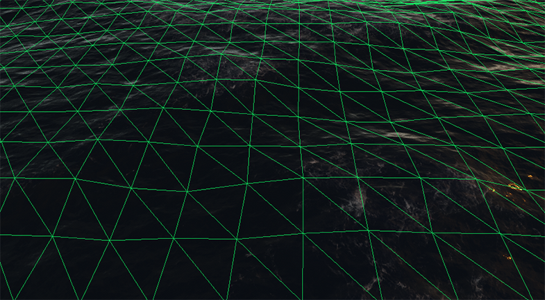

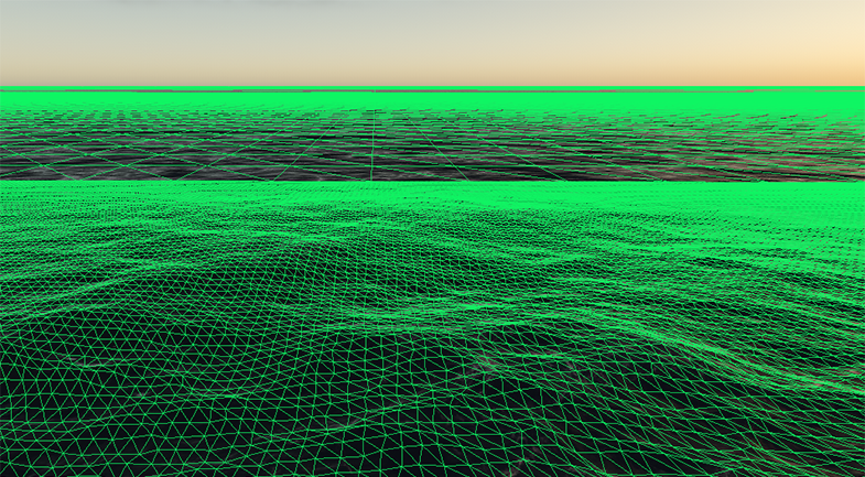

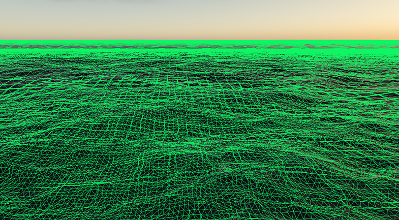

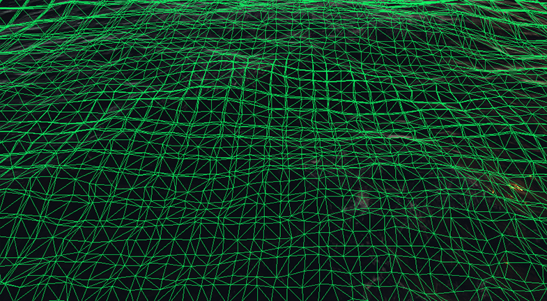

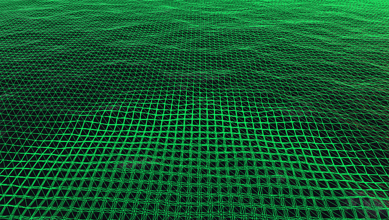

The Engine performs quad tessellation of the water surface. However, not the whole water surface is tessellated: only the inner part of the water that is always under the camera is. Tessellation that is set up properly allows you to increase the performance.

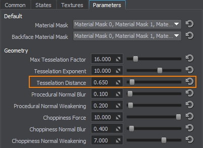

The water_global_base material provides the parameters that allow setting up water tessellation.
To specify the size of the water grid under the camera that should be tessellated, use the Tessellation Distance parameter. It can be found in the Parameters tab of the Materials Editor. Increasing the tessellation distance leads to decreasing the performance, so try to find the proper value.
There is also the Max Tessellation Factor parameter that allows specifying maximum subdivision of each tessellation patch. The higher the value, the more the number of rendered polygons, and, therefore, the lower the performance is.
The Max Tessellation Factor is used together with the Tessellation Exponent parameter that specifies the rate of decrementing the tessellation factor: i.e. how fast the tessellation will fades from the center point of inner water to outer. Increasing this value allows you to improve the performance as well.

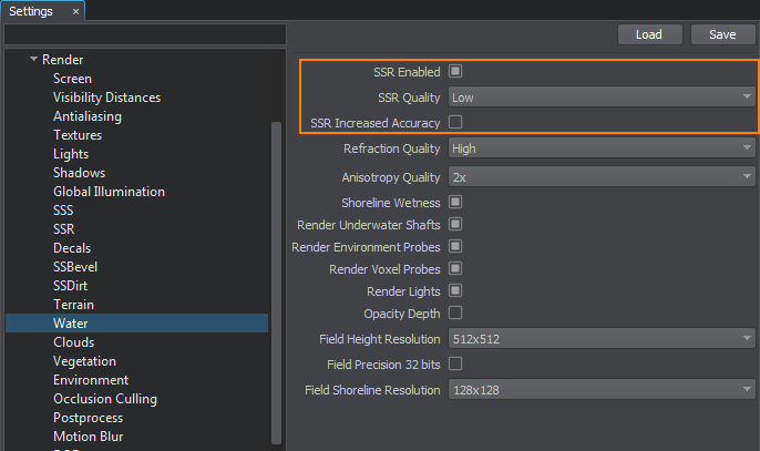

  • In the Menu Bar, choose Rendering -> Water -> SSR.
  • In the Menu Bar, choose Windows -> Settings and then go to the Water section. Here you can toggle the SSR Enabled parameter on.
In the Settings window, you can also specify the additional settings for SSR: set the quality of reflections and enable/disable increased accuracy.
Water SSR Settings
However, remember that these settings affect the performance as follows:
  • The higher the quality of the reflections, the lower the performance is.
  • Enabling the increased accuracy reduces the performance. However, some visual artifacts are reduced as well.

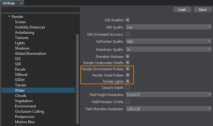

You can disable rendering of the all light sources of the certain type on the water surface to increase the performance.
To enable/disable rendering of a particular light source on the water, select it in the World Hierarchy, go to the type-specific tab of the Parameters window and check/uncheck the Render Water parameter.
  • Render Environment Probes toggles on/off rendering of all environment probes on the water surface.
  • Render Voxel Probes toggles on/off rendering of all voxel probes on the water surface.
  • Render Lights toggles on/off rendering of all omni and projected light sources on the water surface.

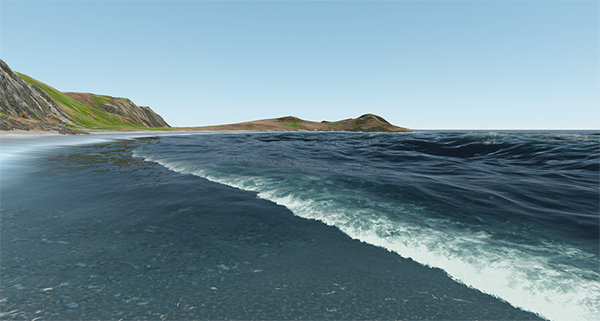

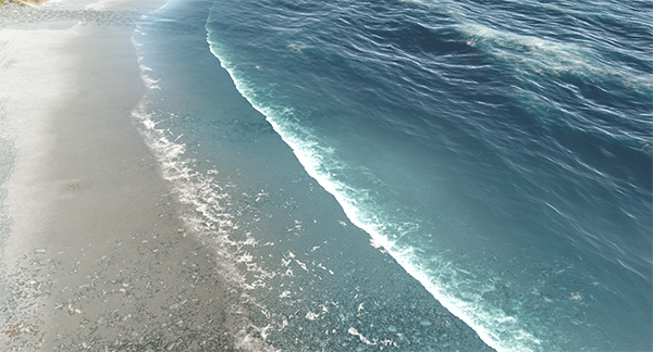

The shoreline areas created with the FieldShoreline object may reduce the water performance if set up improperly. The water_global_base material provides several shoreline-related states that can help to gain the performance.
The Normal and Geometry states affect rendering of wave geometry of shoreline waves. Disable them, when the waves are hardly noticeable (e.g., if the shoreline is observed from above only). In some cases, using only the Geometry state is enough to simulate distortion of the water surface.
If both states are disabled, disable also the High Precision state that allows improving interpolation between the adjacent pixels of the shoreline texture. This state reduces stepping artifacts that are noticeable at the waterline separating overwater and underwater. However, if rendering of the wave geometry is disabled for the shoreline waves, there is no need in such additional calculations.
As it was noticed above, rendering of the waves geometry is usually disabled when the water surface is observed from above. Therefore, you can disable the Caustic Distortion state that smooths caustics. It will gain the performance without visual losses.
You can disable the caustic distortion in any other case, if necessary.

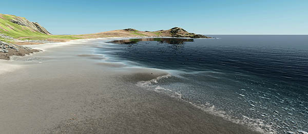

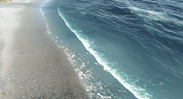

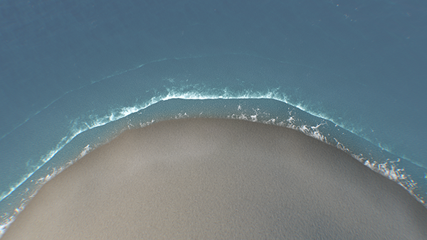

Another state that also affects the performance is Foam. It enables foam rendering for shoreline zones. If the foam simulation isn't necessary, disable the state to increase the performance.

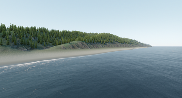

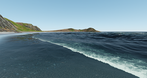

Thus, you can simulate shoreline areas, viewed from a plane, by just enabling the foam effect while disabling geometry, caustics and improved interpolation as they are hardly noticeable with a significant increase of performance.
As you can see, there is almost no visual difference between shorelines on the pictures above.

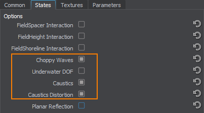

The water_global_base material provides several states that can also affect the water performance:
  • Choppy Waves creates waves with sharp crests. The waves look more realistic, however, you can disable this state if the water is observed from the large distance.
  • Underwater DOF provides the DOF effect for underwater and overwater splice. It can also be disabled, if the camera never gets under the water.
  • Caustics enables rendering of light rays refracted by the water surface. It can be disabled, if the effect isn't required.
  • Caustics Distortion smooths caustics. It is available only when the Caustics is enabled for the water. If smoothing isn't required, the state can be disabled to gain the performance.
The states are available in the States tab of the Materials Editor.

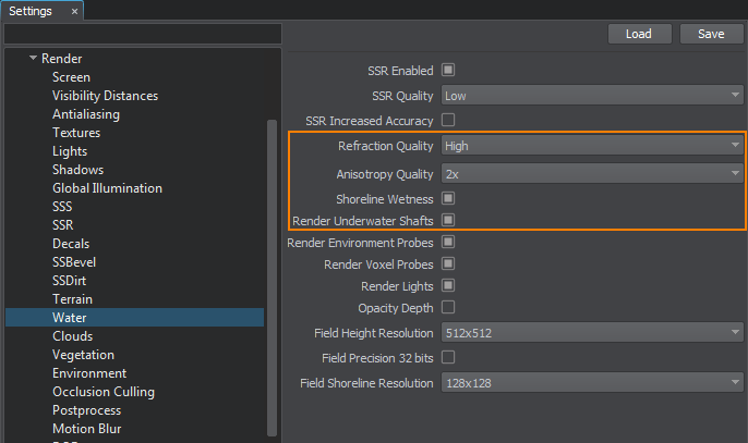

Adjusting Water Rendering Settings#
There is also a set of water rendering settings that may also reduce the performance. They can be found in the Water section of the Settings window.
Anisotropy Quality#
The Anisotropy Quality parameter specifies the anisotropy level (degree of anisotropic filtering) of the water textures. Increasing the quality provides better texture detail over a distance, however, it has a great impact on the performance. So, find the most appropriate value to keep the balance of the visual quality and the performance.
Refraction Quality#
The Refraction Quality parameter specifies the quality of water refraction: the higher the quality, the lower the performance is.
Shoreline Wetness#
The wetness effect enabled for objects near the shoreline may also affect the performance. Try to disable it, if possible, to improve the performance of water rendering.
Underwater Shafts#
Rendering of the underwater shafts can be disabled if the camera never gets under the water.
