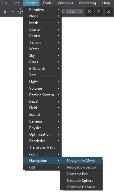

  2. On the Menu bar, click Create -> Navigation -> Navigation Mesh.

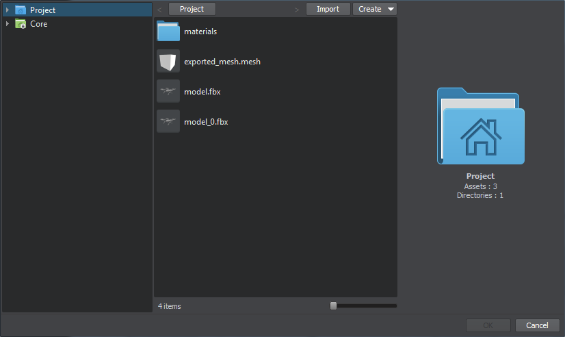

  3. In the file dialog window that opens, choose the required mesh to be used as a base for the new navigation area and click Ok.
  4. Click somewhere in the world to place the navigation mesh. A new navigation mesh is added to UnigineEditor and you can edit it via the Parameters window.

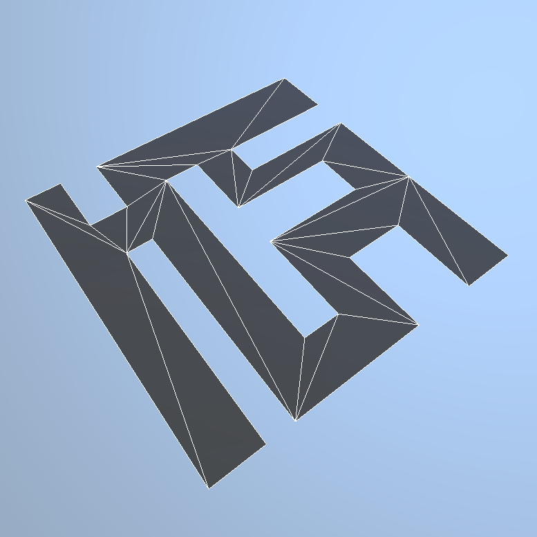

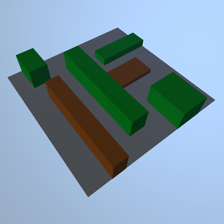

  1. Create a flat mesh with holes in places where the objects are positioned.
    The scene
    The mesh created for the navigation mesh

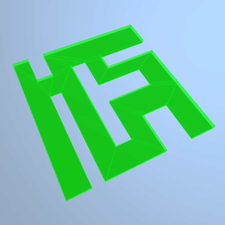

  2. Specify this mesh as a base for a navigation mesh within which the route is calculated, and add the navigation mesh to the world. It will be highlighted in green:
    A navigation mesh based on the flat mesh

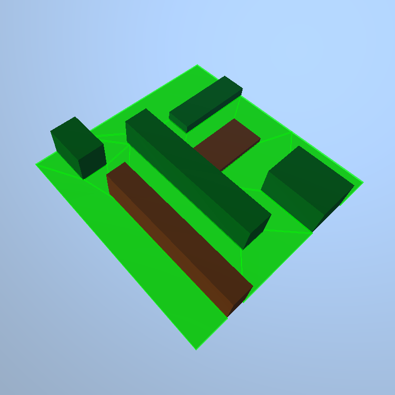

  3. Place the navigation mesh above the scene.
    The navigation mesh positioned above the scene

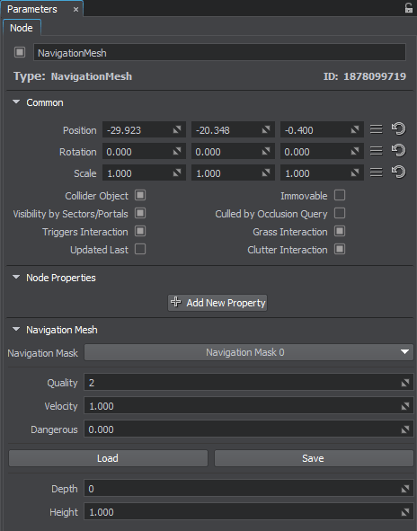

Editing Navigation Mesh#
In the Node tab of the Parameters window, you can adjust the following parameters of the navigation mesh:
Navigation Mask The navigation mask of the navigation mesh must match the navigation mask of the route that is calculated within it. Otherwise, the navigation mesh does not participate in pathfinding.
Quality Quality of optimization of the route that has already been calculated. This value specifies the number of iterations that are used for taking the short cut. The higher the value, the longer the route calculation takes.
Velocity Scaling factor for velocity of the point that moves inside the navigation mesh.
Dangerous Danger factor that indicates if the moving point should try to avoid the navigation mesh.
If the danger factor exceeds the maximum danger factor set for the route, the navigation mesh is excluded from pathfinding calculations.
Depth Depth value. This value affects the quality of the route that is currently calculated. The more the depth value, the better control over accuracy and speed of route calculation is provided. The depth can take integer value in range [0;4]. By default, the depth is set to 0 for a new navigation mesh. The 2, 3, 4 values are used for deeper heuristics.
Height Distance above the mesh polygons available for pathfinding. By default, the height is set to 1 for a new navigation mesh.
