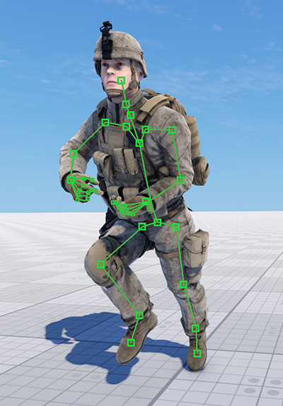

Bone-based animation is a technique in which animated object is represented by two components:
  • Surface representation used to draw the object (called skin or mesh)
  • Hierarchical set of interconnected bones (called the skeleton or rig) used to animate (pose and keyframe) the mesh
Mesh and skeleton
Mesh and skeleton
This technique serves to make the animation process more convenient. Each bone of the rig is associated with some part of the object's mesh. Skinning is the process of creating this association. Changing bone transformations modifies the mesh.

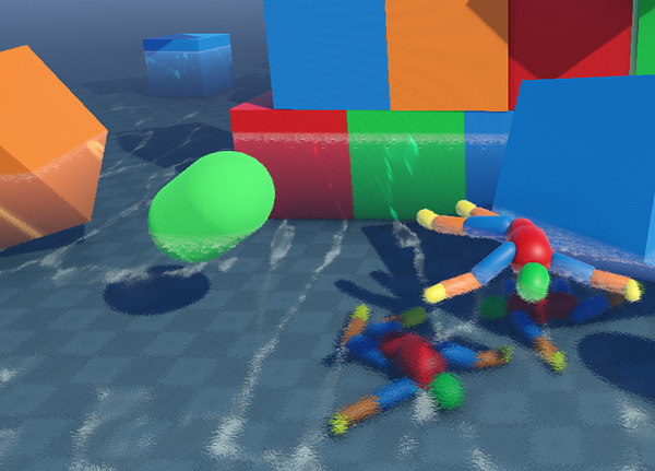

To interact with other objects as well as external physical forces, an object must have a body. The body can be considered a physical approximation of the object, it describes its behavior and represents a set of its dynamic parameters, such as mass, velocity, etc. There are several types of bodies: dummy, rigid, ragdoll, fracture, rope, cloth, water, and path. Each type of body is used for simulation of a specific type of object.
Scene with several types of bodies
Scene with several types of bodies: water, ragdoll, rigid

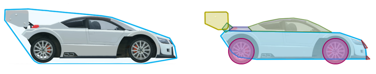

While the body determines the object’s behavior, the shape represents the volume of space occupied by a physical body. The shape is invisible and doesn’t have to be the same as the object’s mesh. Actually a rough approximation (sphere, capsule, cylinder, box, or convex hull) is often more efficient and indistinguishable. A physical body has one or several collision shapes allowing objects to collide with each other.
A car approximation using one and several shapes
Objects with shapes also fall down under gravity, bounce off static surfaces, or slide along them. Sliding and bouncing are determined by restitution and friction coefficients included in the list of shape parameters. A body without a single shape assigned behaves as a dummy body that can be connected to other bodies using joints, but does not collide and is immune to gravity.

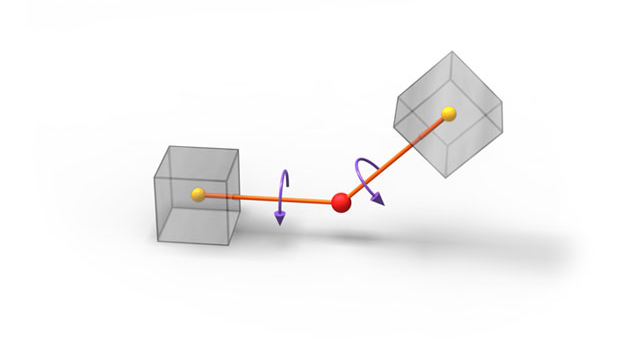

In virtual worlds, like in the real world, we would like to have complex objects consisting of several interconnected parts (for example, a robotic arm or a car). That’s exactly what the joints are used for.
A joint connecting two rigid bodies
A joint connects two rigid bodies and represents certain constraints i.e. it restricts the movement of connected bodies relative to each other. When the force applied to a joint is too much, the joint breaks. The implementation of destructible joints includes the limits of linear and angular motion, so if a force exceeds these limits, the joint is broken. There are several types of joints: fixed, hinge, ball, prismatic, cylindrical, suspension, wheel, and path.
When using joints, it is very important to ensure mass balance — avoid connection of too heavy bodies to light ones, otherwise the system may become unstable. As mentioned before, physics simulation uses approximate calculations, therefore, if the difference of mass between two connected bodies is significant, accumulation of errors and precision issues lead to instability of the result.
Thus, when making a car model, do not set the mass of the car body equal to 2000 kg and the wheels — to 10 kg, it might be better to use 5 kg for the body and 1 kg for each wheel to provide realistic behavior.

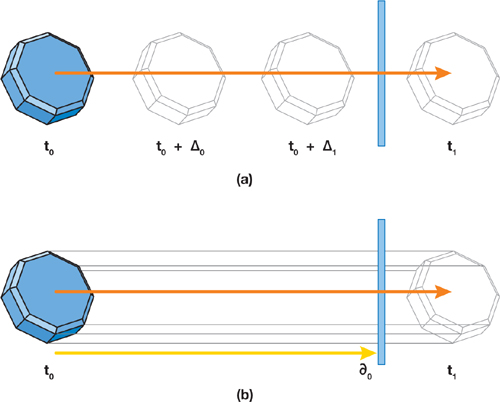

  • Discrete collision detection is performed in certain intervals of time and each frame is treated separately from others. In general, discretization improves performance. However, when a project framerate is already low, a small fast-moving object is likely to teleport from one point to another instead of moving there smoothly, and a collision will not be detected.
  • Continuous collision detection does not suffer this problem as the moving body is extruded along its trajectory (between two adjacent frames). If something gets into this volume and a collision is detected, the body is taken back in time to correct the collision reaction.
    Continuous collision detection is available for sphere and capsule shapes only.
Discrete and continuous collision detection
Discrete (a) and continuous (b) collision detection

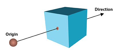

Intersection detection lies at the heart of collision detection, but is a particular case of ray intersection (ray casting) that serves slightly different purposes. Calculation of the intersection between a ray cast from a certain point in a certain direction and a surface is fast and inexpensive and therefore sometimes can be used instead of computing a collision. For example, calculation of collisions of car wheels with the ground takes time and decreases framerate. In this case we can use intersection of rays cast from the bottom of the car with the ground instead of precise collision detection using collision shapes, thus reducing computational costs and increasing performance.
Ray-box intersection

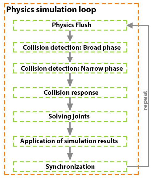

Simulation of Physics#
Simulation of physics is performed in a looped sequence of the following stages on a per-frame basis:
Physics simulation loop

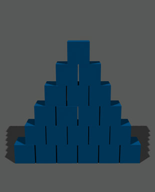

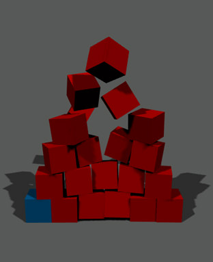

  • When a body is moving slower than a specified minimum linear or angular velocity for a specified period (freeze frames), it is assumed that it has come to a halt. During this period of inactivity, there is actually no need to simulate it. If this happens, the object remains in a resting state until it is affected by another object or force. Therefore, such object is excluded from all steps of the simulation except collision detection. This state is called freezing and it allows to save a great deal of computational resources.
    Frozen boxes     Simulation starts again as the impulse unfreezes boxes
    Frozen blue and unfrozen red boxes: the impulse applied to the pyramid of boxes unfroze all but one
