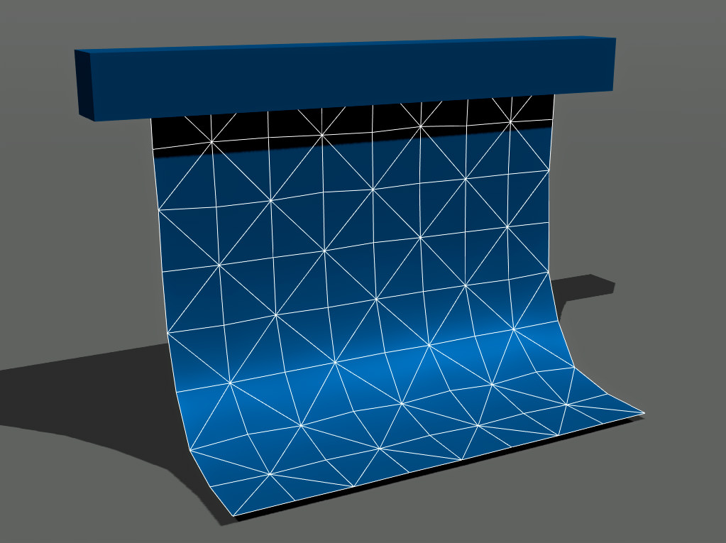

In most cases, it is important that polygon triangulation of the mesh, for which cloth body is generated, is as illustrated! Otherwise, it may not stretch properly and evenly in all directions.
Required mesh triangulation
For example, in 3ds Max mesh topology needs to be edited manually: choose Modify panel > Selection > Edit Edges rollout and click Turn to turn the triangles in a poly.

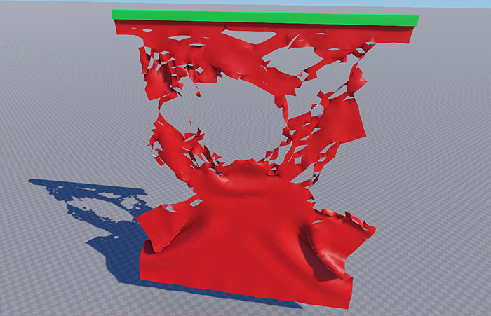

When the cloth is stretched beyond its elastic limit or folded, it tears and shreds into pieces. Tearing is caused by applying the force or collision with a physical body, and depends on the cloth stiffness (controlled by linear and angular restitution parameters). For example, imagine the cannonball hitting the sail and leaving the hole in it. The cloth is torn only along the edges of cloth triangles, splitting mesh vertices and duplicating particles.
Cloth tearing
Tearing of cloth
If torn pieces of cloth fall onto one plane, they cause z-fighting.

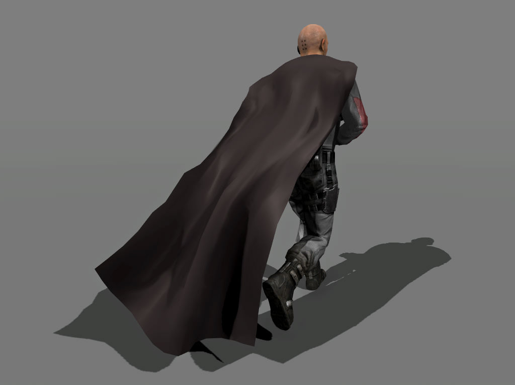

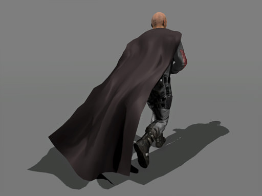

I'm Batman!
Cloth attached to animated character
A cloth can be attached to the following types of bodies:
To attach a cloth to a body use a particles joint. In case of rigid bodies (either static or dynamic) and dummy bodies, pinned particles stay fixed in their position and follow transformations of attached objects pulling the cloth with it.
