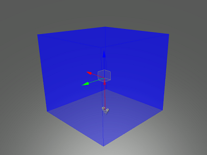

A physical noise is a cuboid shaped area that adds a distribution flow based on a volumetric noise texture. The physical noise enables to simulate a force field that affects particles and physical bodies with a spatial 3D noise.
The physical noise can affect only a cloth, a rope or a rigid body. Also you should remember that a rigid body requires a shape to be assigned.

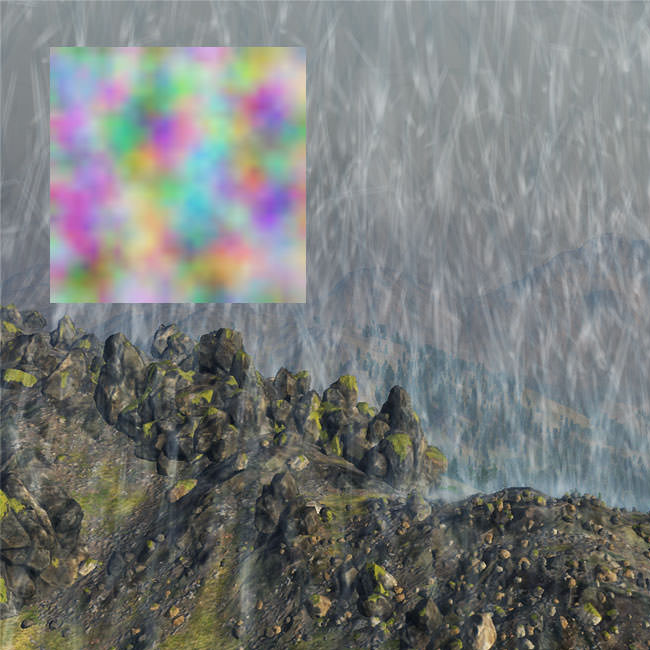

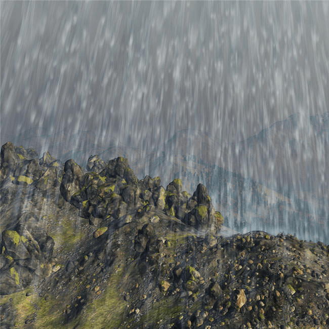

For example, if you add the physical noise for particles, you can get the following:
Noise is disabled
Noise is enabled. A colored square is a noise image texture.
The physical noise will affect particles only if their physical mass is nonzero. The physical mass for the particles can be set on the Particles tab of the Parameters panel.

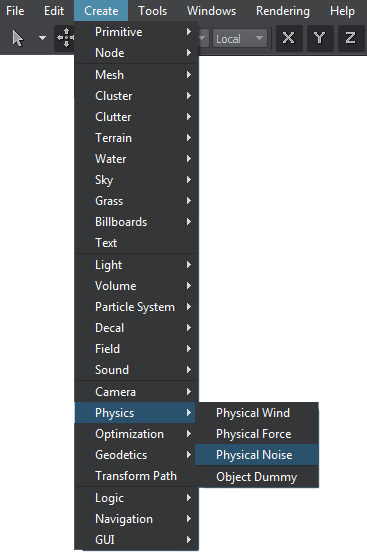

To add a physical noise to the scene via UnigineEditor:
  2. On the Menu bar, click Create -> Physics -> Physical Noise.
  3. Click somewhere in the world to place the physical noise.
The new physical noise node will be added to UnigineEditor and you will be able to edit it via the Parameters window.

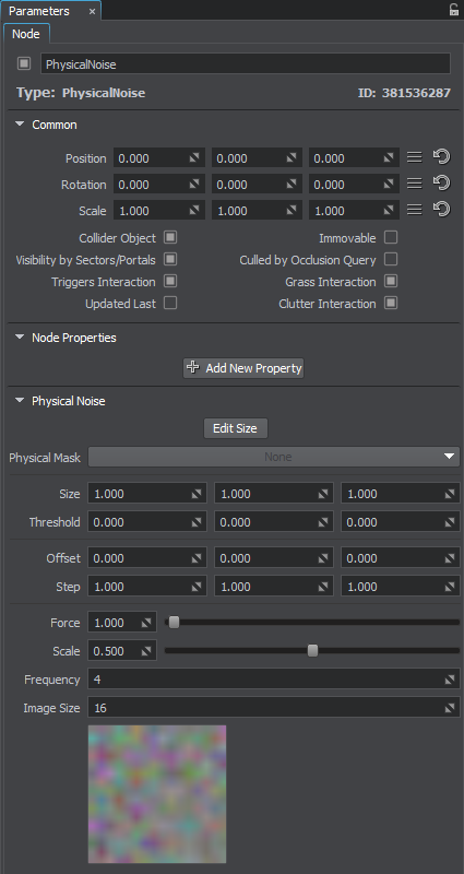

In the Physical Noise section (Parameters window -> Node tab), you can adjust parameters of the physical noise.
To have a more clear understanding how the following parameters affect the resulting force inside the physical noise node, see Main Concepts.
Node Parameters#
The following parameters are used to set conditions of the size of the physical noise node.

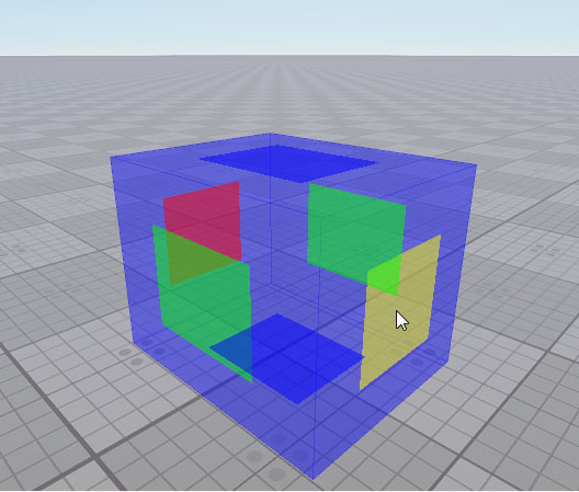

Edit Size Toggles the editing mode for the physical noise node. When enabled, the physical noise box sides that can be resized are highlighted with the colored rectangles. To change the size of a side, drag the corresponding rectangle.
Physical Mask Physical mask. The physical mask of the physical noise must match the physical mask of the physical object. Otherwise, the physical noise won't affect the object.
Size Size of the physical noise box along the axes in units.
Threshold Threshold distance along the axes. The threshold determines the distance of gradual change from zero to full force value. This values are relative to the size of the physical noise box. It means that the threshold values should be less than the size of the physical noise box.
Texture Sampling Parameters#
The following parameters are used for pixel sampling from the generated noise texture.
You can animate a force field in run-time by changing these parameters.
Offset Sampling offset along the axes.
Step Size of the sampling step along the axes.
Force Multiplier#
Force Force multiplier. The higher the value is, the higher the value of the resulting force that affects an object inside the physical noise node will be.
Texture Generation Parameters#
The following parameters are used to generate a noise texture that will be used in run-time.
It is not recommended to change values of the following parameters in run-time as the noise texture will be regenerated and the performance will decrease.
Scale Scale of the noise texture. The minimum value is 0, the maximum value is 1.
Frequency Number of octaves for the Perlin noise. The higher the value is, the more details the noise texture has. The minimum value is 0, the maximum value is 16.
Frequency = 1
Frequency = 16
Image Size Size of the noise texture image in pixels.
