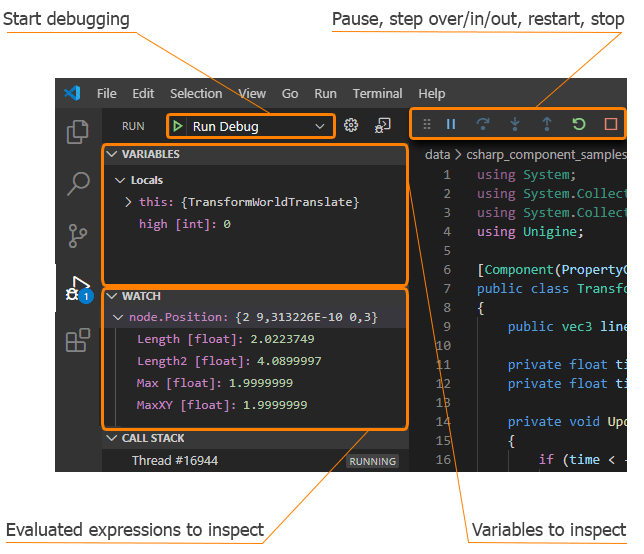

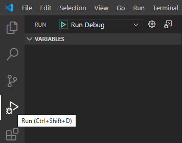

To start debugging you should bring up the Run view first. To do this select the Run icon in the Activity Bar on the side of VS Code or use the keyboard shortcut Ctrl+Shift+D.
Debugging in IDE#
To compile all your components, build your application, and debug it running right from the IDE (without switching to UnigineEditor and clicking the Play button) you should select Run Debug in the Run dropdown:
Now you can add necessary breakpoints and simply hit F5 to launch the debugging process.
By default your application will run with the default world set for your project by the SDK Browser upon creation.
If the default world is not set, after launching your application you'll see a black screen. In this case you can open the console (press "~" on the keyboard) and load the desired world via the world_load console command or via API.

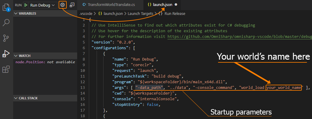

To change or specify the default world, as well as the path to the data folder, or any other startup parameters click the Gear button. This will open the launch.json file containing debugger configuration. Startup parameters of the target application (your project) can be specified in the "args" element.

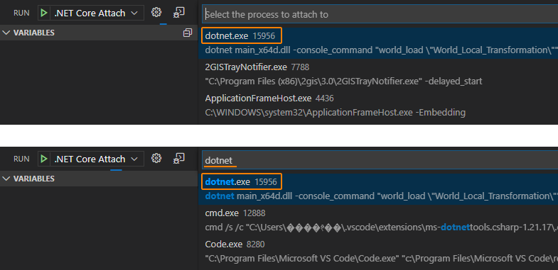

You can also connect VS Code debugger to an instance of your application that is already running - the most common case is launching it via the Play button in the UnigineEditor. In this case you should select .NET Attach in the Run dropdown:
Now you can add necessary breakpoints and simply hit F5 to launch the debugging process. The only difference here is that you should select the application to attach to. You should select the first process in the list named dotnet.exe (type "dotnet" in the search field to find it quickly).

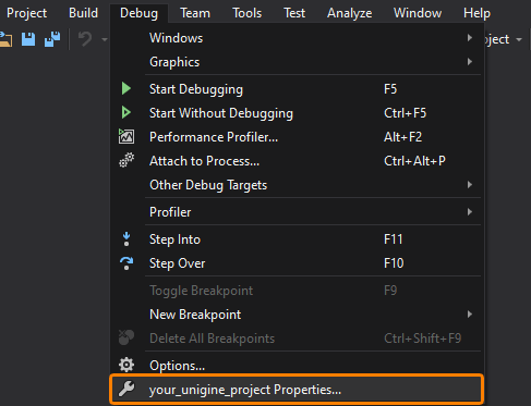

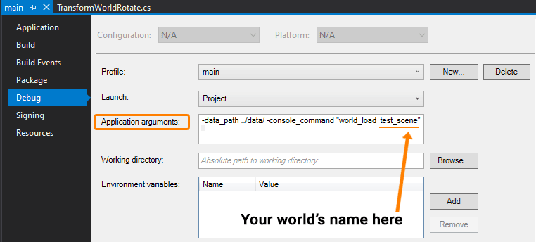

To change or specify the default world, as well as the path to the data folder, or any other startup parameters choose Debug -> your_project_name Properties in the main menu.
This will open the following window with debugger configuration for your project. Startup parameters of the target application (your project) can be specified in the Application arguments field.

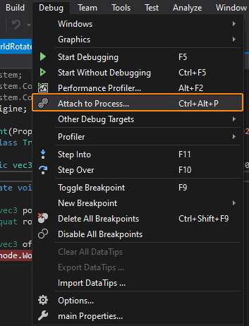

First, you should add necessary breakpoints. Then you can choose Debug -> Attach to Process in the main menu (or hit Ctrl + Alt + P) to launch the debugging process.

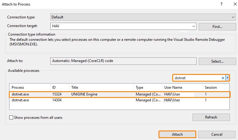

The next thing you should do is select the application to attach to. You should select the first process named dotnet.exe in the Available processes list (type dotnet" in the filter field to find it quickly). Then click Attach.

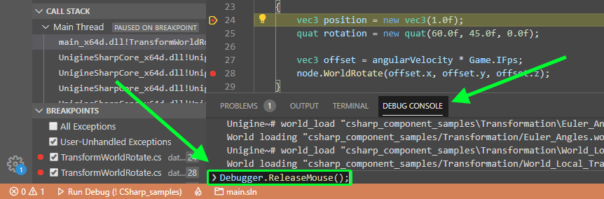

Debugging on Linux#
There is an issue taking place when debugging your application on Linux. After reaching a breakpoint the mouse cursor is grabbed by the Engine making it impossible to switch back to code editor. This section describes a workaround helping you overcome this issue.
The workflow is as follows:

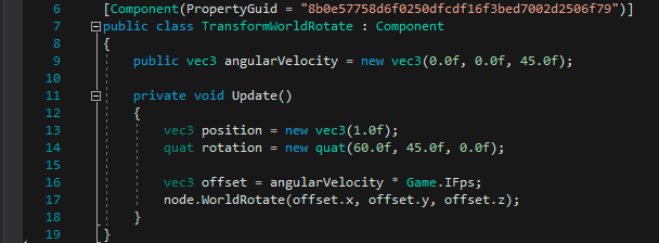

  1. Insert the following code to AppSystemLogic.cs or to any component's code:
    Source code (C#)
    public class Debugger
        public static void ReleaseMouse()
            App.MouseGrab = false;
            App.MouseCursorHide = false;
            App.MouseCursorNeedUpdate = true;
            App.UpdateMouseCursor();
  2. Then we can put a breakpoint anywhere in the code, launch the debug process as described above, and test our application
  3. After reaching the breakpoint, switch focus to the Debug Console window by hitting Ctrl + Shift + Y on the keyboard
  4. Type the following line in the console:
    Source code (C#)
    Debugger.ReleaseMouse();
    and press Enter
  5. Mouse cursor is unlocked!
You have to type this only once, then you can perform these actions via hotkeys:
[Ctrl + Shift + Y] -> Arrow_Up -> [Enter] (Visual Studio Code).
The same approach works for other IDEs as well. Each of them has its own "Debug Console", enabling you to execute code when the application is paused. So, you should locate it, open, and execute this code: Debugger.ReleaseMouse();.
