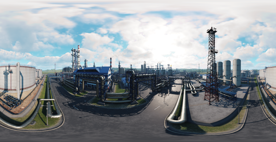

Panoramic Rendering Modes#
The following rendering modes are supported:
  • 180 or 360 degree panorama with curved edges
  • 180 or 360 degree linear panorama without distortion at the edges

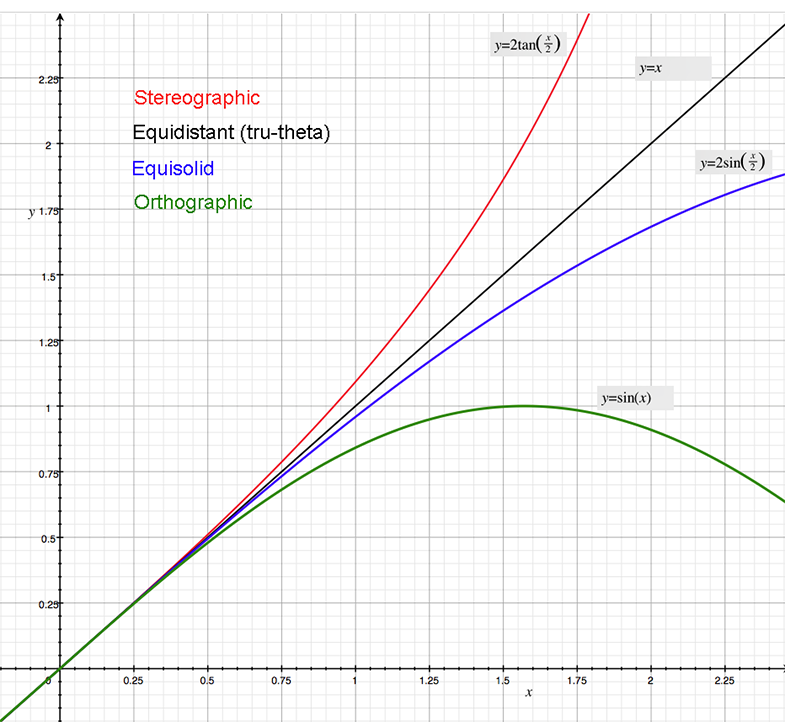

  • Orthographic fisheye panorama with an adjustable field of view
  • Equidistant (tru-theta or f-theta) fisheye panorama with an adjustable field of view
  • Stereographic fisheye panorama with an adjustable field of view
  • Equisolid (equal-area) fisheye panorama with an adjustable field of view
The horizontal axis on the chart above is the angle (radians) of incident light on the lens where 0 degrees is along the lens axis. The vertical axis is proportional to the radius on the fisheye image where that light exits the lens.

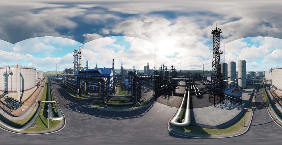

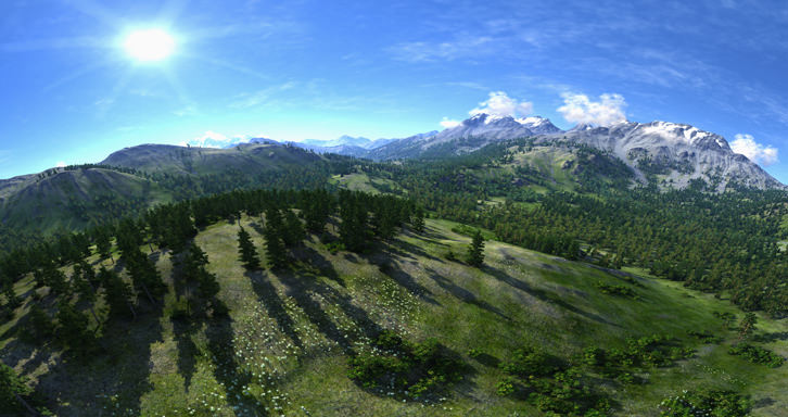

Curved Panorama#
Curved Panorama
180 degree panorama with curved edges on 1 monitor

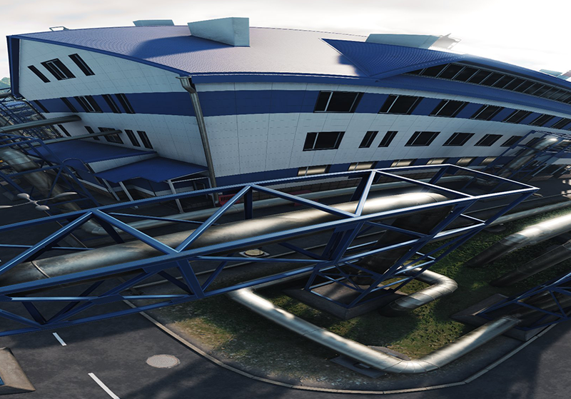

Linear Panorama#
Linear Panorama
180 degree linear panorama on 1 monitor

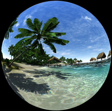

Fisheye#
Fisheye
180 degree spherical panorama

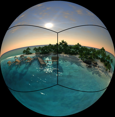

How Panoramic Rendering Works#
During panoramic rendering 4 viewports are seamlessly stitched into one for extra-wide field of view. Images are overlapped and blended along the border shown below.
4 viewports of panorama
4 viewports used to render panorama

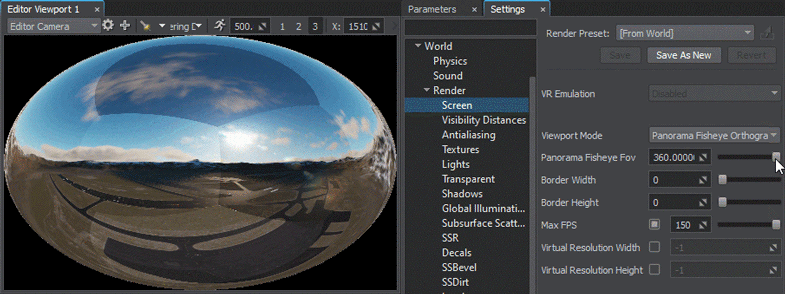

To adjust FOV for fisheye panoramic rendering modes, select one of the Fisheye modes and set the desired Panorama Fisheye FOV via the Screen Settings or using the corresponding console commands:
Source code
Unigine~# render_viewport_mode 7 render_panorama_fisheye_fov 30
Available only when render_viewport_mode is set to one of the fisheye panorama modes (5-8).

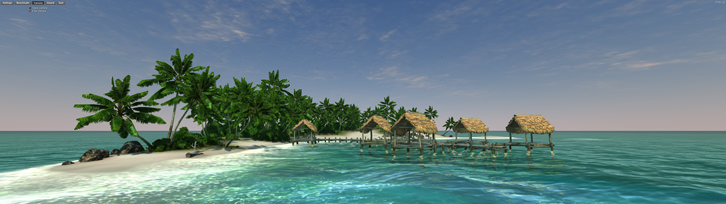

Multi-Monitor Mode#
It is also possible to span panorama across several identical monitors (only) in the fullscreen mode without decorations. For that, you need to specify on the start-up:
  • The summed resolution of two displays (for example, for two 1280x1024 displays, that would be 2560x1024)
  • video_fullscreen 2
For example (do not forget to specify other required start-up options):
Shell commands
main_x64.exe -video_mode -1 -video_width 2560 -video_height 1024 -video_fullscreen 2
