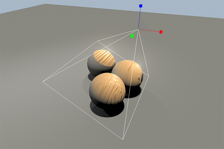

Projected Decal with normal map
Types of Decals#
UNIGINE features the following types of decals:
  •   Orthographic Decal is a decal projected onto a surface by means of orthographic projection.
  •   Projected Decal is a decal projected onto a surface by means of the perspective projection.
