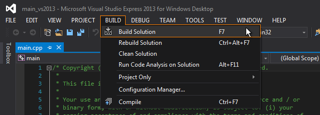

To rebuild engine C++ plugins, perform one of the following: >To rebuild a plugin with Microsoft Visual Studio, do the following:
  • Open the solution of the necessary plugin to rebuild. All plugins are located in <UNIGINE_SDK>\source\plugins\.

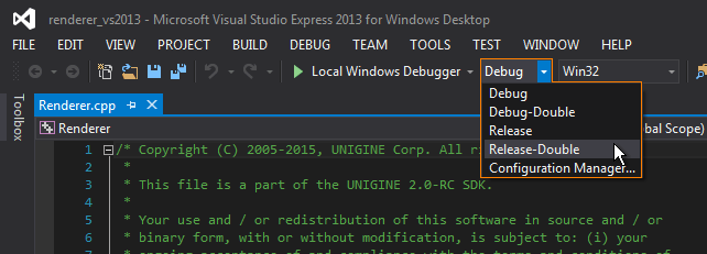

  • Specify the solution configuration: Debug, Debug-Double, Release or Release-Double.
  • Choose Build -> Build Solution in the menu or press F7.

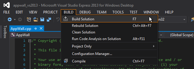

To rebuild athe task-specific application with Microsoft Visual Studio, do the following:
  1. Open the solution of the necessary plugin to rebuild. All plugins are located in <UNIGINE_SDK>\source\plugins\.

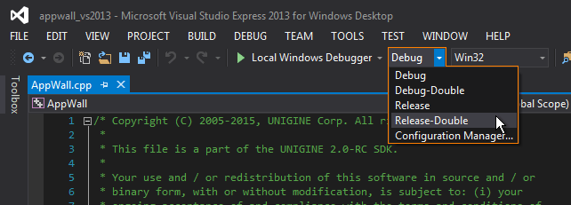

  2. Specify the solution configuration: Debug, Debug-Double, Release or Release-Double.
  3. Choose Build -> Build Solution in the menu or press F7.

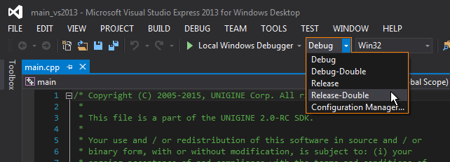

To rebuild UNIGINE samples, you should do the following:
  1. Open the Visual Studio project file of the sample. Samples are located in the<UnigineSDK>\source\samples\ directory.
