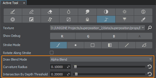

Settings#
Draw Blend Mode Sets a blending mode used for painting. For more details, see the Brush tool settings.
Curvature Radius Radius of the curvature mapping.
Intersection By Depth Threshold Depth threshold (in units) limits curvature mapping in areas where information cannot be obtained. The higher the value, the less pronounced the curvature effect is.
You can use the Fill stroke mode for fast texture painting.
