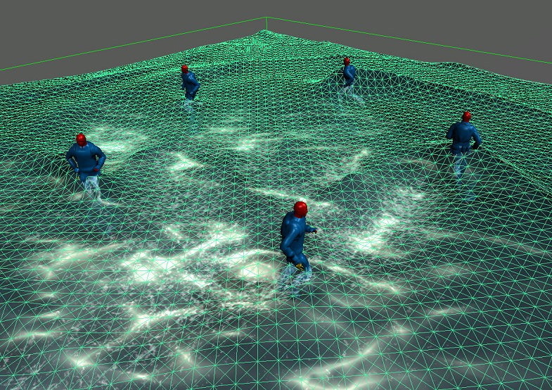

Two-way dynamic interaction provides both physically and visually convincing simulation of the waves from the physical bodies as they disturb the fluid. Imagine a moving boat that forms a wake wave behind it, or a character creating ripples while moving in the water (see the picture above).

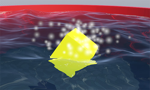

Emission of Particles#
It is possible to create an additional visual effect of small droplets, splashes or bubbles on the water when objects fall into it. To enable this effect perform the following steps:
  1. Create a Particle system effect by clicking Create -> Effect -> Particle system in the main menu of UnigineEditor.
  2. Go to the Parameters window.
  3. In the Dynamic section, choose the Spark Emitter to spawn particles by selecting Emitter -> Spark.
  4. Make Particle system a child of the Water Mesh object.
Particles will be generated only when the object first contacts the water surface, while already submerged bodies will float without generating them.
Effect of water splashes

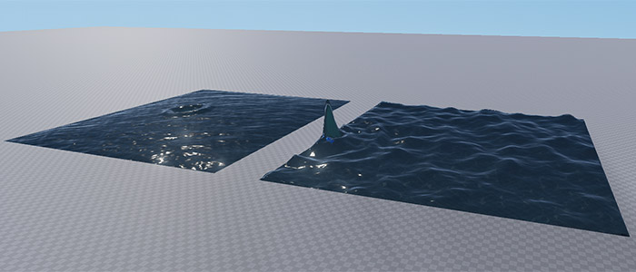

Absorption#
Absorption is an option that creates either an effect of a limited basin or, on the contrary, of an open water surface that does not have marked boundaries.
  • If Absorption is enabled, the waves are dispersed along the mesh perimeter. In this case the water level at mesh edges will gradually fall down to zero level.
  • If disabled, the backwash from the wall is simulated: the wave when reaching the brink of the water is reflected and returns in the reversed direction.
Water body absorption: enabled(left) and disabled(right)
