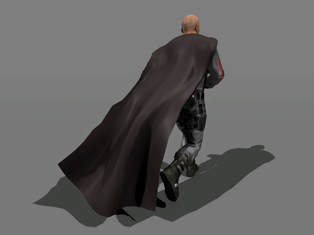

Cloth body greatly enhances the appearance of dressed characters (otherwise entirely animated) and saves the time of game artists. However, simulation of this type of body is quite costly and it is strongly recommended to use distance optimization to avoid performance hits.

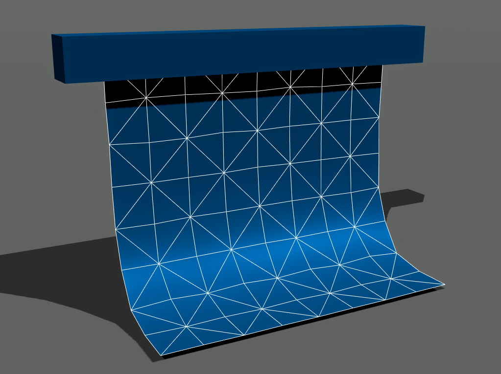

In most cases, it is important that polygon triangulation of the mesh, for which Cloth body is generated, is as illustrated! Otherwise, it may not stretch properly and evenly in all directions.
Required mesh triangulation
For example in 3ds Max, mesh topology needs to be edited manually: choose Modify > Selection > Edit Edges rollout and click Turn to turn the triangles in a poly.

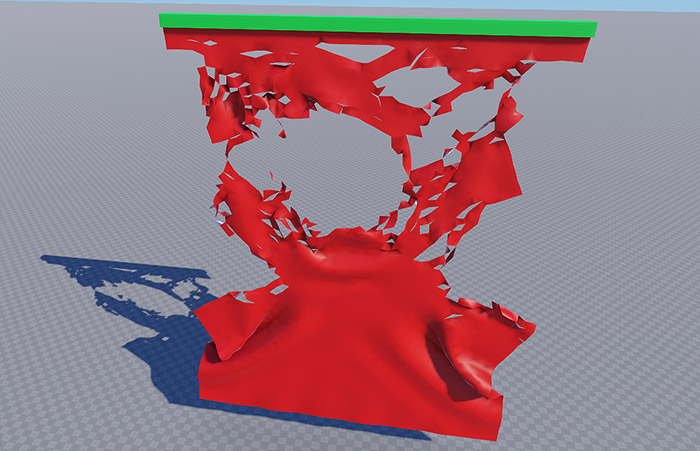

When the cloth is stretched beyond its elastic limit or folded, it tears and shreds into pieces. Tearing is caused by applying the force or collision with a physical body, and depends on the cloth stiffness (controlled by linear and angular restitution parameters). For example, imagine the cannonball hitting the sail and leaving the hole in it. The cloth is torn only along the edges of cloth triangles, splitting mesh vertices and duplicating particles.
Cloth tearing
Tearing of cloth

Cloth attached to animated character
A cloth can be attached to the following types of bodies:
To attach a cloth to a body use a Particles Joint. In case of Rigid bodies (either static, or dynamic) and Dummy bodies, pinned particles stay fixed in their position and follow transformations of attached objects pulling the cloth with it.

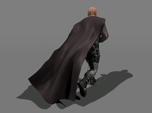

Convincing simulation of the clothing on a skinned character requires a different approach. To follow bones transformations, each vertex of the cloth that is found in the Particles Joint area is mapped to the nearest skinned mesh vertex (up to the distance specified by the Threshold parameter of the particles joint).
It is not recommended to attach the cloth directly to the skinned character, because difference in topologies may result in visual artifacts. Instead of it, it is better to create an identical cloth surface on the skinned mesh character, make it invisible and attach a physical cloth to it.
For example, we need to create a cape that is glued to the shoulders of a skinned character while the rest flaps and folds loosely. It is done in the following steps:
  1. When creating a Mesh Skinned, add a cape surface identical to the cape that the character would wear. It can be either a whole cape, or only its clipped part that needs to be pinned. The latter is preferable when complex clothing is simulated, which requires more flexible control over which parts to simulate physically and which ones to move with skinned character. In our case, it's cloth part over the shoulders.
  2. Add skinned mesh that has a Ragdoll body assigned. Make sure that the cape surface is enabled.
  3. Add a separate dynamic cloth mesh and synchronize its position with skinned character. Turn off physical simulation (CTRL + SPACE) and assign a Cloth body.
  4. Attach Cloth body to Ragdoll body. If the Threshold distance of the particles joint is set low enough, the physical cape will be automatically attached only to the cape surface (i.e. shoulders). After that, the cape surface is simply disabled and does not provide any load at all.
