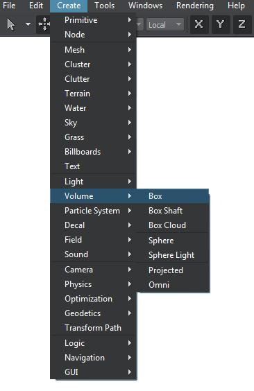

To create a Box object, perform the following steps:
  1. On the Menu bar, click Create -> Volume -> Box.
  2. Place the Box object somewhere in the world.
  3. Specify the Box object parameters.

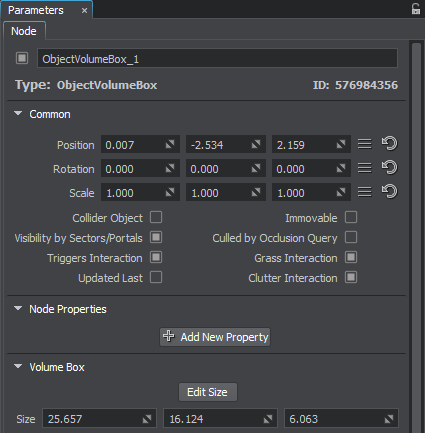

In the Volume Box section (Parameters window -> Node tab), you can adjust the following parameters of the Volume Box:

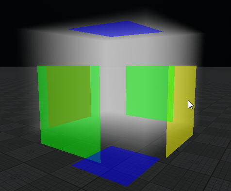

Edit Size Toggles the editing mode for the Volume Box node. When enabled, the Volume Box sides that can be resized are highlighted with the colored rectangles. To change the size of a side, drag the corresponding rectangle.
Size Length, width, and height of the box (in units) along X, Y, and Z axes.
