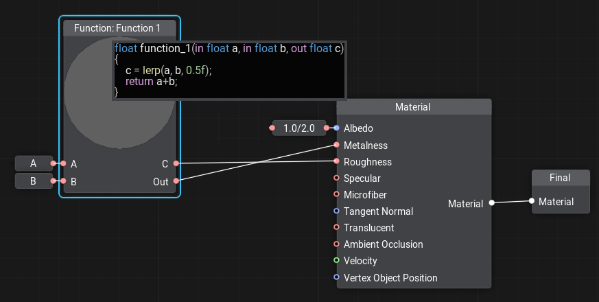

  • Ability to write code in a special Function node, here you can implement even multiple functions calling each other.

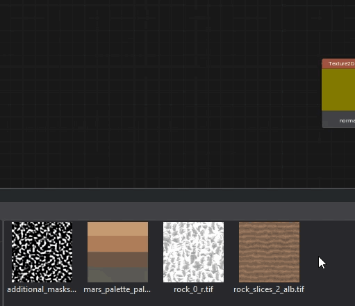

  • You can drag-n-drop textures from the Asset Browser or directly from your file manager, and they will be automatically imported with the corresponding nodes added to the graph.

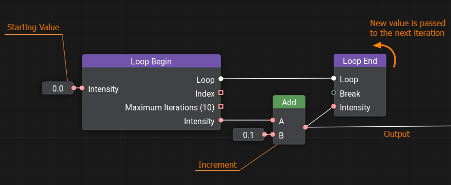

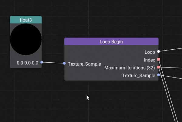

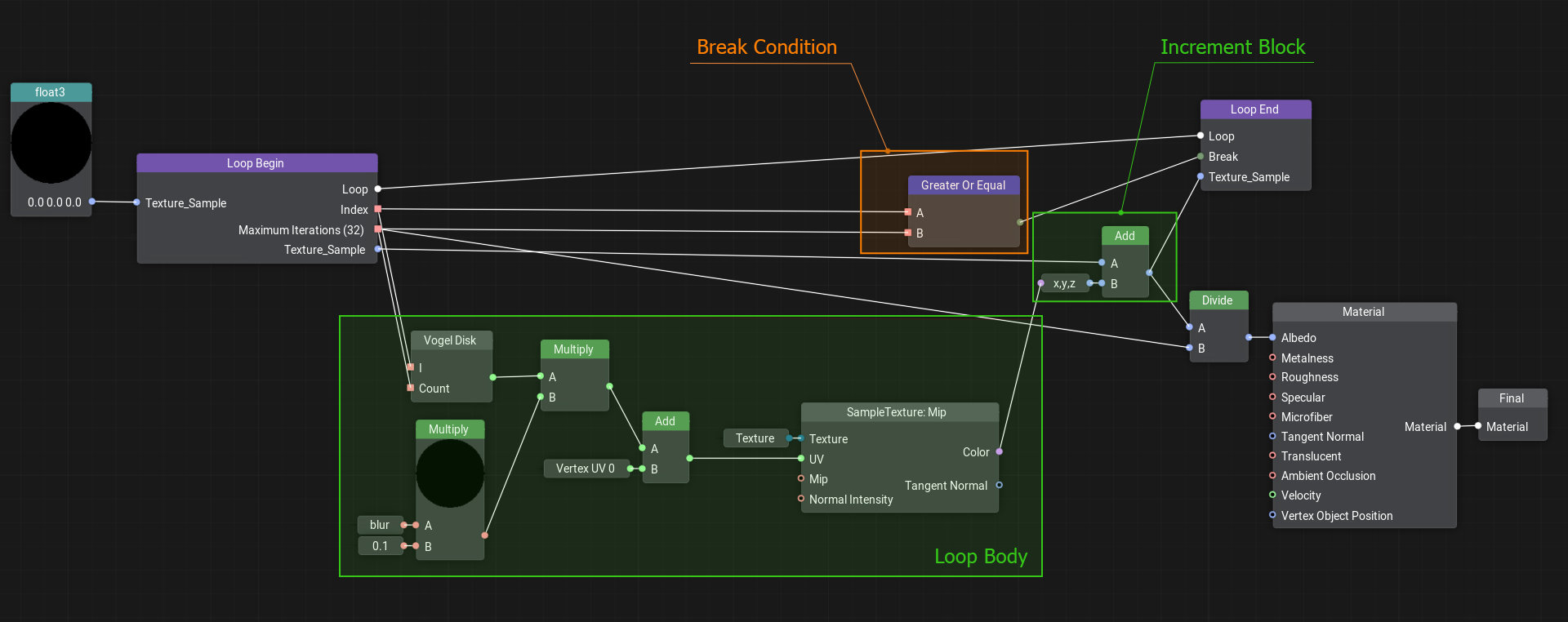

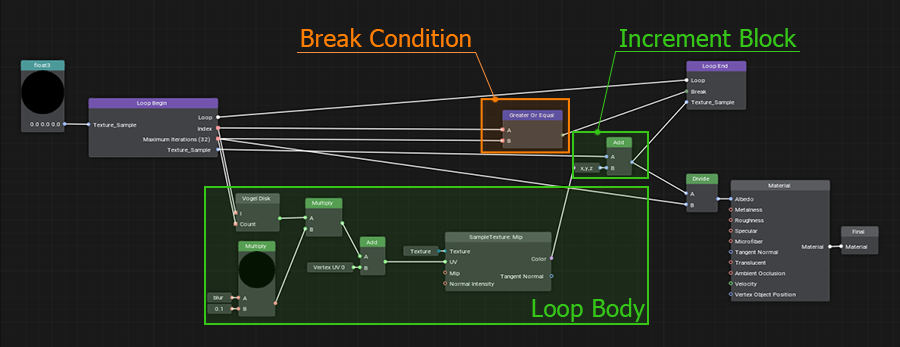

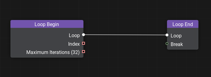

  • Loops — a complex, but very cool feature enabling you to repeat an arbitrary sequence of actions multiple times. We have analyzed multiple existing implementations of graph loops and invented a new one that is almost on par with loops in code. Why not write loops in code then? Because using a graph makes implementation of complex things inside a loop much easier than doing the same in code.

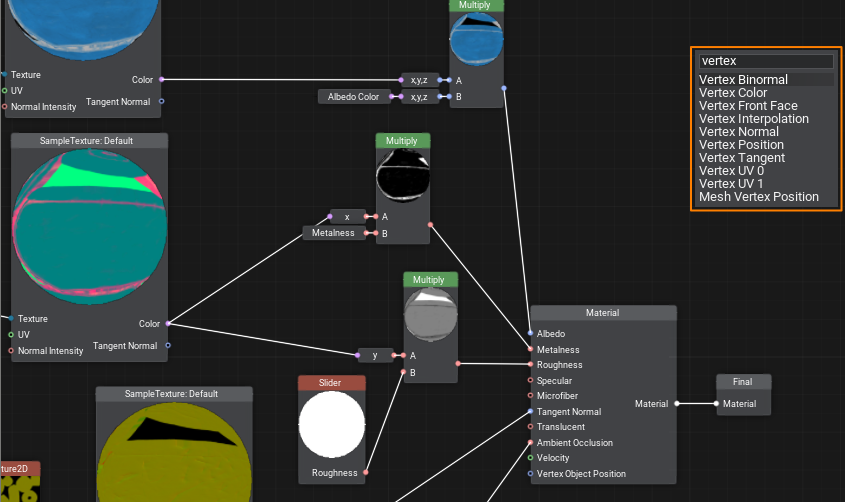

  • When working with complex or large graphs, you may end up with your wires are all over the place crisscrossing each other and you may want more visual clarity. That's when portals come into play. You can connect a wire to a Portal In node at one location and then place a Portal Out node at any other location you need and take what you've supplied to Portal In from a Portal Out (like you dug a tunnel for your wire under the node graph).

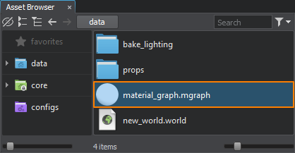

Material Graph Asset#
A Material Graph asset (.mgraph) is both a source material network (node-based description to be compiled into a material) and a normal base material that can be assigned to a mesh surface.

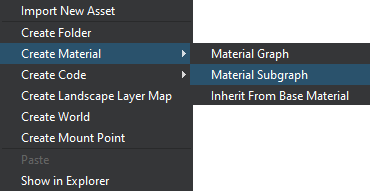

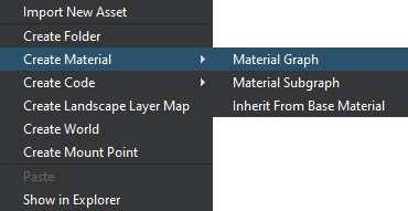

To create a new Material Graph, right-click in the Asset Browser to open the Create menu, then select Create Material -> Material Graph.
Specify a name for your graph asset. A new *.mgraph asset will be created in the current folder of your project.
As the Material Graph asset represents a base material, it is also available in the root of the Materials Hierarchy and can be assigned to supported surfaces and objects. Depending on the material's type it can be assigned to the following objects:

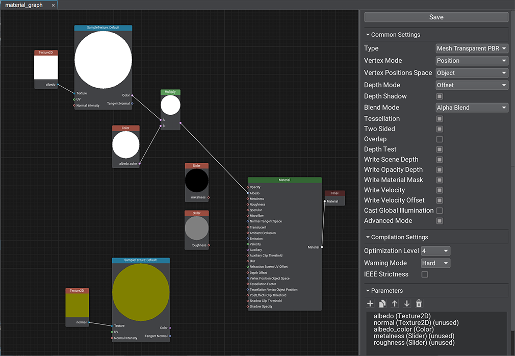

Working with Material Graphs#
Right-click on the *.mgraph asset and choose Edit Graph or simply double-click the asset to open it in the Material Editor window.
The Material Editor window includes the Graph View displaying the material graph network and the settings panel.
The material graph network consists of nodes — functional blocks accountable for processing input data. By composing the graph network, you define the look of your material.

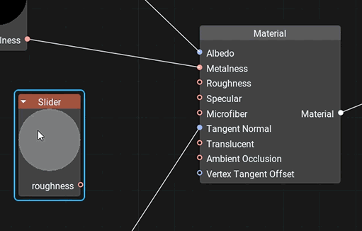

The Material node is the master node of your material. It provides a set of inputs for graphic data and generates a material of a specific type depending on the current settings.
Finally, the output from the Master Node is connected to the Final node — the primary output material node.
A material graph can contain several Material nodes, but only the one connected to the Final node will be used.
Press the Save button to save changes and compile the material graph to a base material. Compilation errors, if any, will be listed in the Warnings and Errors panel and in the Console window.

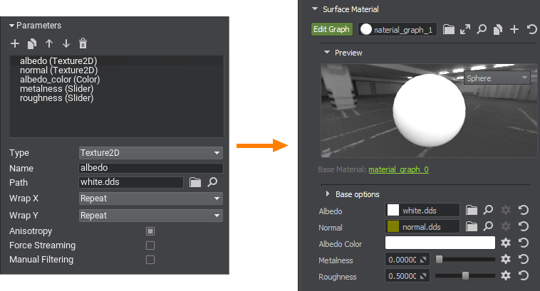

Parameters#

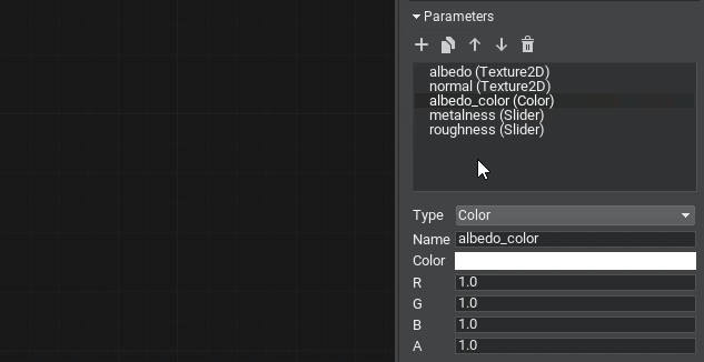

In the Parameters panel, you define the list of material parameters.
The following controls are available:
  • Add — add a new parameter.
  • Clone — clone the selected parameter.
  • Move Up — move the selected parameter up in the list.
  • Move Down — move the selected parameter down in the list.
  • Remove — remove the selected parameter.
When adding a new parameter, you should specify the parameter's Name, Type, and default settings in the parameter creation dialog. The following set of parameter types is provided:
  • Slider — a float value within the specified range ([0.0f; 1.0f] by default).
  • Color — a float vector of 4 components representing a color value.
  • Texture2D, Texture3D, Texture2DArray, Texture2DInt, TextureCube — a texture of the corresponding type.
  • Group — an auxiliary type for grouping parameters. Use the and buttons to rearrange and group parameters.
  • Float, Float2, Float3, Float4 — a float value or a vector of N float values.
  • Int, Int2, Int3, Int4 — an integer value or a vector of N integer values.
To use a parameter in your material graph, drag the item to the Graph View to create a node of the corresponding type:

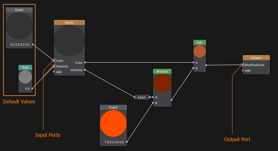

Nodes of Material Editor are functional blocks that represent data sources and processing instructions similar to variables and functions in shader programming.
Most nodes have the output preview shown on a preview sphere (for most nodes) or a plane (for textures).
Some nodes have a set of settings defining their behavior. Double-clicking the node opens the dialog for adjustment of the node's settings.
Nodes that have no more than one input and one output port have a special connector mode — they are collapsible for convenience. A collapsed node connected to another node becomes attached to it. Drag the collapsed node to break the connection and detach the node.

Adding New Nodes#
In order to add a new node, right-click on the background or press Space and select a node type from the palette or type its name in the Search field to find it.
Dragging an edge from an input port opens a node creation palette with a pre-set filter to the required data type for the corresponding port.
Textures can be dragged directly from the Asset Browser. In this case, a Sample Texture node with corresponding settings will be added automatically.
Loops#
Sometimes you need to perform certain actions multiple times, cloning the relevant groups of nodes will make your graph overcomplicated very quickly, even if only 10 iterations are required. In UNIGINE, you can create loops for that, just like in programming.
To create a loop, add the Loop Begin and Loop End nodes and connect their Loop ports.
By double-clicking the Loop Begin node, you can open the Input Constructor enabling you to add, rearrange, rename, delete inputs (changing variables or other auxiliary values) and implicitly set their type as well as set the maximum number of iterations.
Then, build a graph implementing the functionality of a single iteration, the result of which should be passed to the Loop End node for further iterations. You can use the result of all iterations further in your graph.
You can use the Index of the current iteration and the Maximum Iterations values in your logic. The Index starts with 0 and is equal to Maximum Iterations-1 at the last iteration.
Here's an example of a simple loop, incrementing a value by 0.1 10 times:
The Loop End node has the break input port that takes a boolean value, false by default. Passing a truth value (e.g., obtained via Logical Nodes) will interrupt the loop and exit the current iteration.
Custom Code#
No matter how advanced the materials system is, you might want something specific, maybe too complicated to implement via basic nodes. Or sometimes, it might be quicker to write several lines of code for mathematical operations instead of spawning a bunch of nodes and connecting them. The solution is simple — create a Function node and wrap any shader function into it. Input and output ports for the node shall be automatically generated according to the function's signature.
To add or edit code to the node double-click on the node, the Code Editor window will open. You can write as many functions as you need, the last function in the code will be considered the main one.

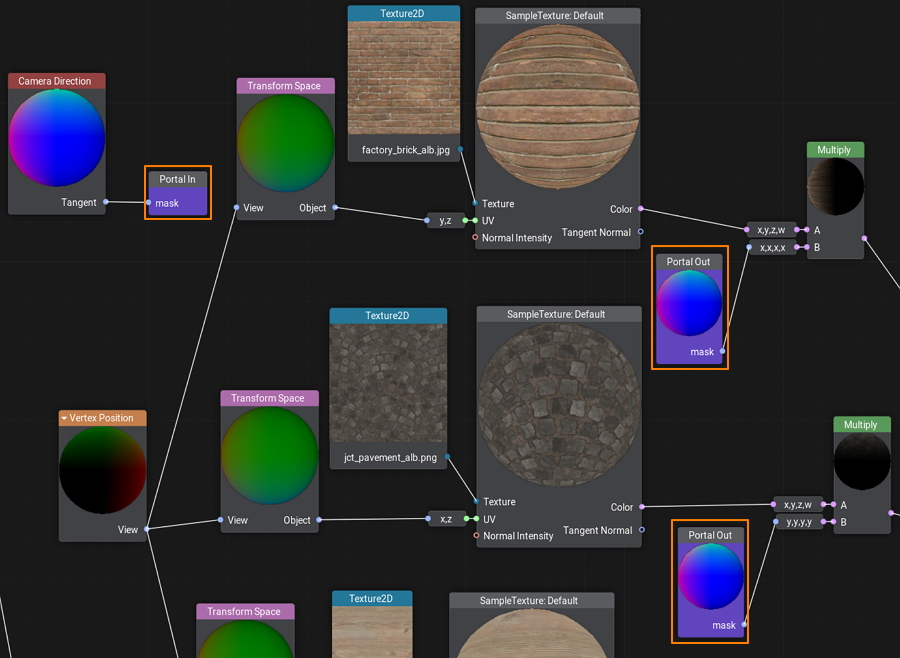

Portals#
Sometimes, especially in complex material graphs, there are too many crisscrossing edges making the whole graph look like a spiderweb, and the data flow very hard to understand. A portal is a set of special nodes including a single input and one or more outputs, all having the same name. Portals serve to reduce the number of edges and make the graph more 'readable'.
To create a portal, start with adding a Portal In node. Connect an input to the new node and double-click on it to adjust its color and name.
And then you can create as many Portal Out nodes as you need. By double-clicking on a Portal Out node you can select the name of the desired input portal in case several portals are used.

To create a new Subgraph, right-click in the Asset Browser to open the Create menu, then select Create Material -> Material Graph.
Click Save to apply and save changes.

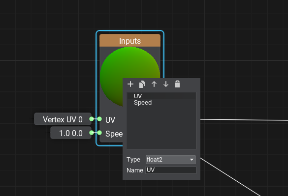

Configuring Inputs and Outputs#
Double click on the Inputs node or the Outputs node to open the constructor panel enabling you to add, rearrange, delete and set the name and type of input and output ports of the subgraph correspondingly.
By connecting nodes to the ports of the Inputs node, you specify the optional ports of the subgraph having default values.
