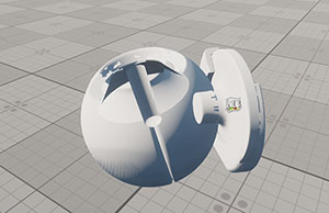

  • The mesh shouldn't be two-sided or have any overlapping parts — this causes sorting artifacts. The mesh, however, may be curved in order to be applied to the sides of the object onto which it is projected by enabling the Screen Projection option.
    Mesh used for projection has overlapping parts of surface that cause artifacts
    Any unnecessary surfaces are cut off the mesh to have it projected correctly

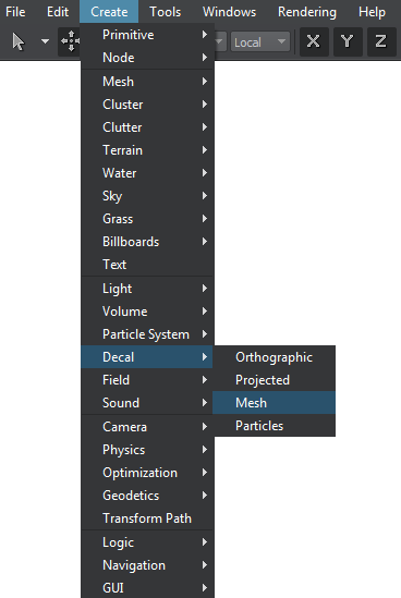

To create a Mesh Decal:
  1. On the Menu bar, choose Create -> Decal -> Mesh.

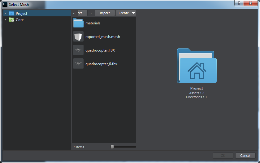

  2. In the file dialog window that opens, choose a mesh for the decal that is in line with the mesh requirements:
  3. Press the OK button and place the decal somewhere in the world (for the decal to be projected, the mesh should intersect the surface).

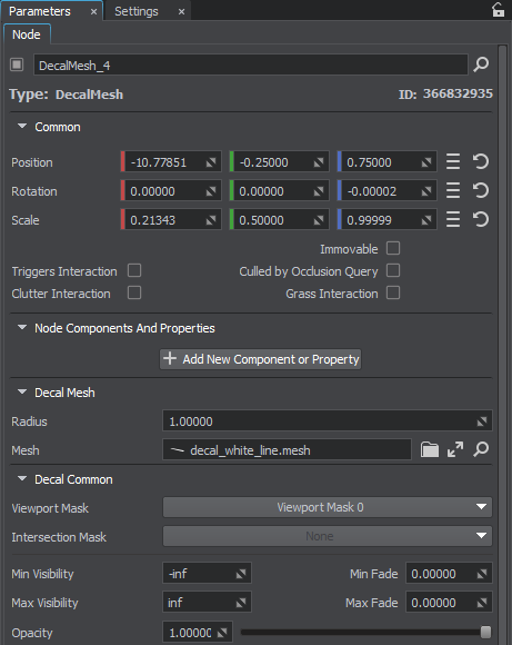

In the Node tab of the Parameters window, you can adjust the following parameters of the Mesh Decal:
Node tab
Decal Mesh#
Projection parameters of the Mesh Decal:
Radius
The height of the projection box along the Z axis, in units.
Radius = 10
Radius = 20
Mesh Path to the .mesh file on which the decal is based.
