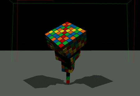

Mesh Dynamic nodes added as children to the nested World Expression nodes

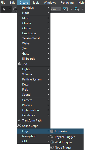

To create World Expression via UnigineEditor:
  1. On the Menu bar, click Create -> Logic -> Expression.
  2. Place the World Expression somewhere in the world.

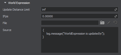

  • Directly in UnigineEditor in the Source field of the World Expression section in the Parameters window. Source code must be inside the curly braces {}, as they define the World Expression scope.

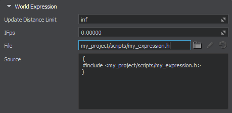

  • Attached as a script file in the File field of the World Expression section. The script file should be included in the World Expression scope in the Source field using the curly braces {}:
    In this case, the my_expression.h file should contain the following code:
    Source code (UnigineScript)
    log.message("WorldExpression is updated\n");

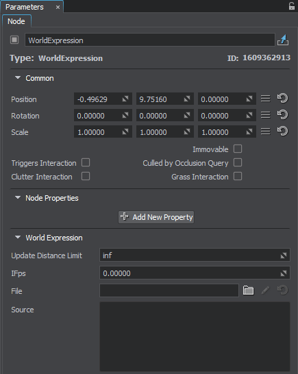

You can adjust the following parameters of World Expression in the Node tab:
Update Distance Limit Distance from the camera, within which the expression is executed.
IFps A constant frame duration (inverse FPS, 1/FPS) used to execute the expression. If 0 is set, the expression is executed at the same frame rate as the main application.
File
A path to a file with a World Expression script to be executed. The path is relative to the data directory. This file should be included in the World Expression scope in the Source field. This field is optional as the World Expression script can be implemented directly via the UnigineEditor interface.
If the script file is changed, it should be refreshed via UnigineEditor: click to the right of the File field.
Source
Source code of a World Expression script. This field can contain:
  • Direct implementation of the World Expression script
  • The #include directive that loads the script file specified in the File field.
