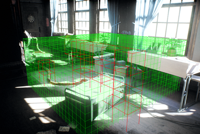

  2. Create and place voxel probes at the places where the lighting remains relatively static (e.g. interiors, outdoor buildings, and immovable objects). Select Half or Full Bake Internal Volume mode for voxel probes to illuminate dynamic objects that move within their volume.
    Place voxel probes inside other voxel probes to create insets defining the areas that require higher detail. Note that voxel probes with the additive blending mode enabled cannot be used for this purpose, as they are blended instead of replacing each other.

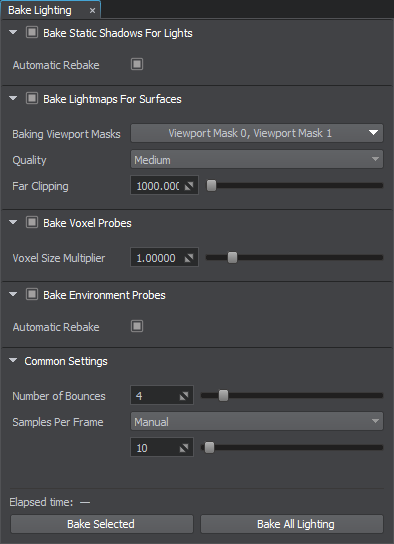

Bake Lighting Settings#
Bake Static Shadows For Lights#
Bake Static Shadows For Lights Enable baking of cached shadows for static light sources.
Automatic Rebake Enable auto-rebake of shadows on transforming a static light source or changing its parameters.

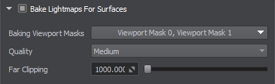

Bake Lightmaps For Surfaces#
Bake Lightmaps For Surfaces Enable baking of lightmaps for surfaces.
Baking Viewport Masks For the light or surface to contribute to static GI, their viewport masks should match the Baking Viewport Mask.
Quality Baking quality preset.
Far Clipping Far clipping distance for light rays.
Bake Voxel Probes#
Bake Voxel Probes Enable baking of voxel-based GI to voxel probes.
Voxel Size Multiplier Multiplier for the Voxel Size parameter for each voxel probe.
Bake Environment Probes#
Bake Environment Probes Enable baking of reflection cubemaps to environment probes.
Automatic Rebake Enable auto-rebake of the cubemap of an Environment Probe on transforming it or changing its parameters.

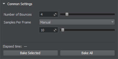

Common Settings#
Number of Bounces Number of light ray bounces.
Samples per Frame Number of sampling units processed and visualized simultaneously each frame (samples for lightmaps and voxels for Voxel Probes):
  • Auto - the number of samples is adjusted automatically to optimize performance of baking process.
  • Manual - the number of samples is set manually.
The parameter is available for changing during the baking process. Higher values cause longer user interface response but accelerate the calculations.
