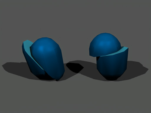

Slicing#
Slicing is a fracture pattern separating the mesh volume into two pieces by a plane. The plane passes through a specified point of the body. Slicing angle is determined by a specified normal.
Slice Pieces
Fracturing body into two slice pieces
To slice a Fracture body use the createSlicePieces() method.

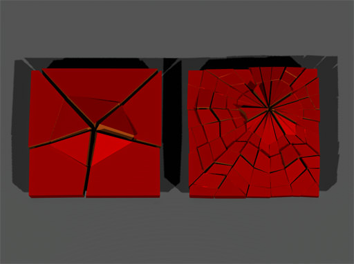

Cracking#
Cracking is a fracture pattern involving formation of radial cracks from the point of collision. All of the crack pieces slightly vary in size to ensure visual realism. Moreover, the mesh can be additionally fractured along concentric rings, simulating spread of the impulse. The thiner and more brittle the material is (e.g., glass), the more rings tend to be formed by fracturing. The specified distance between the rings is also randomly varied to provide convincing result.
Crack Pieces
Creating crack pieces with different number of radial cracks and concentric rings
To crack a Fracture body use the createCrackPieces() method.

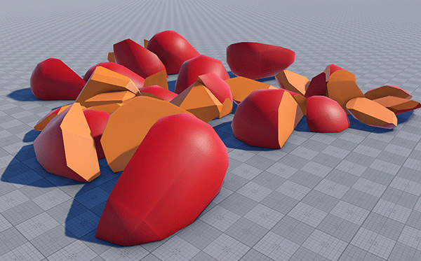

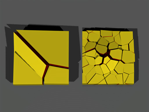

Shattering#
Shattering is a fracture pattern randomly dividing the mesh volume into the specified number of convex chunks.
Shatter Pieces
Creating different number of shatter pieces
To shatter a Fracture body use the createShatterPieces() method.
