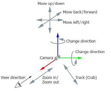

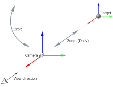

The following schemes demonstrate the main navigation controls that are used in UnigineEditor:
Navigation controls used to freely move the camera in the scene
Additional navigation controls used to move the camera relative to the target

Moving the Camera#
To move in the scene, you can use the following default controls:
Control Description
RIGHT-CLICK + Drag
Change the camera direction.
  • Press and hold this key and drag the mouse left or right to change the yaw angle. In this case, the camera will rotate around its vertical axis.
  • Press and hold this key and drag the mouse up or down to change the pitch angle. In this case, the camera will rotate around its horizontal axis.
RIGHT-CLICK + W Move the camera forward.
RIGHT-CLICK + S Move the camera backward.
RIGHT-CLICK + A Move the camera left.
RIGHT-CLICK + D Move the camera right.
RIGHT-CLICK + Q Move the camera down.
RIGHT-CLICK + E Move the camera up.
Alt + MIDDLE CLICK + Drag Track (crab) the camera in the plane which is perpendicular to the view direction.
Alt + LEFT CLICK + Drag Orbit the camera about the target.

Alt + RIGHT-CLICK + Drag Zoom (dolly) the camera toward or away from the target by using the dolly zoom.

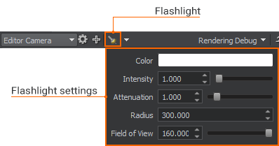

Flashlight Settings
Control Description
L Toggle a flashlight attached to the camera.
Flashlight Settings#
Color A flashlight color.
Intensity A flashlight color intensity. The higher the value, the brighter the light is.
Attenuation A flashlight attenuation power. It simulates light intensity gradual fading.
Radius A radius of the area illuminated by the flashlight.
Field of View A field of view of the flashlight. This parameter defines the angle of the light clipping in range from 10 to 160 degrees.

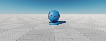

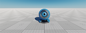

The following pictures show 2 cameras positioned in different points in the world:
camera_0 camera used as watch-point
camera_0 camera view
camera_1 camera used as watch-point
camera_1 camera view
When you switch to one of the saved cameras, you can freely move it in the world: changes in its position and orientation won't be saved. To return to the saved position and orientation of the camera, switch to another camera and then choose the required camera again.
