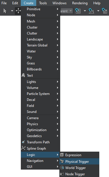

To add a Physical Trigger to the scene via UnigineEditor:
  2. On the Menu bar, click Create -> Logic -> Physical Trigger.
  3. Click somewhere in the world to place the Physical Trigger.

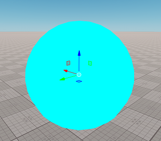

A new Physical Trigger node will be added to UnigineEditor, and you will be able to edit it via the Parameters window. By default, the sphere trigger with 1-unit radius is created.

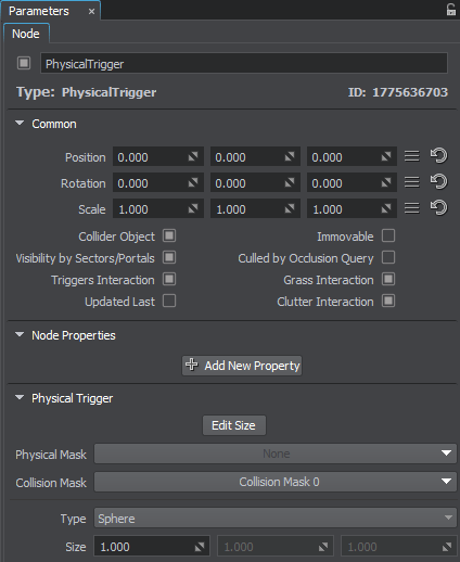

In the Physical Trigger section (Parameters window -> Node tab), you can adjust the following parameters of the physical trigger:

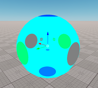

Edit Size
Toggles the editing mode for the Physical Trigger node. When enabled, the size or the radius of the node (depending on its type) can be changed: each side/axis is highlighted with the colored rectangle/circle. To change the size/radius, drag the corresponding rectangle/circle.
Editing of sphere-shaped physical trigger
Physical Mask The Physical mask of the Physical Trigger must match the Physical mask of the physical object. Otherwise, the Physical Trigger won't trigger events when the object enters or leaves it.
Collision Mask
  • In case of the physical object, the Collision mask of the Physical Trigger must match the Collision mask of the physical object's shape.
  • In case of the non-physical collider object, the Collision mask of the Physical Trigger must match the Collision mask of the object's surface.
Type Type of the Physical Trigger: sphere, capsule, cylinder, or box.
Size
Size of the Physical Trigger, namely:
  • Radius in case of a sphere
  • Radius and height in case of a capsule or a cylinder
  • Dimensions in case of a box
