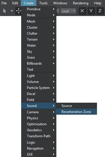

To create a sound reverberation zone via UnigineEditor:
  1. In the Menu bar, click Create -> Sound -> Reverberation Zone.
  2. Place the sound reverberation zone somewhere in the world.

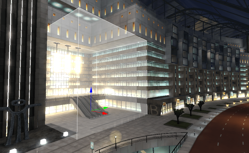

Reverberation Zone Size#
The reverberation zone represents a separate acoustic enclosure in the virtual world. It limits the perimeter in which reverberation will be added to the sound. Outside this zone, the sound emitted by sources will not undergo reverberation modification. If two zones overlap, their parameters are interpolated linearly for proper physical simulation of the mixed characteristics.
The size of the zone (in units) is set along three coordinates axes: X, Y, and Z.
