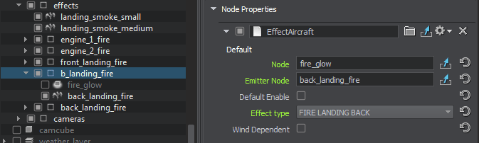

Aircraft Effects#
To set up various aircraft effects (engine or landing gear fire, smoke, contrail, etc.):
  1. Assign the EffectAircraftController property to the parent node (aircraft) and leave all parameters unchanged.
  2. Assign the EffectAircraft property to each node representing visual effects of various types.
    The following property parameters are available:
    • Node — a node to be enabled/disabled
    • Emitter Node — a node emitting particles for the effect
    • Default Enable — indicates whether the effect should be enabled by default
    • Effect Type — aircraft effect type selection (engine or landing gear fire, smoke, contrail, etc.)
    • Wind Dependent — indicates whether the effect is affected by wind or not

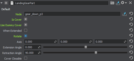

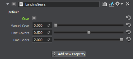

Landing Gears#
This component allows controlling the landing gears. It contains several properties that shall be assigned as follows:
  1. Assign the LandingGears property to the parent node (aircraft).
    • Gear — indicates that gears are extended
    • Time Covers — cover opening time, in seconds
    • Time Gears — gear extension time, in seconds
    Make sure all pivots are set up properly.
  2. Define which nodes represent parts of landing gears and assign the LandingGearPart property to them.
    • Node — the node to be moved (usually the node to which this property is assigned)
    • Is Cover — indicates whether the part is a cover or not (a cover is opened prior to gear extension)
    • Use Dummy Cover — indicates whether the wheel well is to be covered with a dummy cover after gear retraction. When enabled, an additional When Extended option is displayed. It is used to specify whether the dummy cover shall be visible when the gear is extended.
      If this option is enabled, the Node field should not contain the node to which this property is assigned, as the component will be disabled forever after retraction.
    • Rotate — indicates whether the part should rotate
    • Axis — coordinates of the part's rotation axis
    • Extension Angle — rotation angle of the part, when the gear is extended, in degrees
    • Retraction Angle — rotation angle of the part, when the gear is retracted, in degrees
    • Cover Closable — indicates whether the cover should close after gear extension, or to stay open

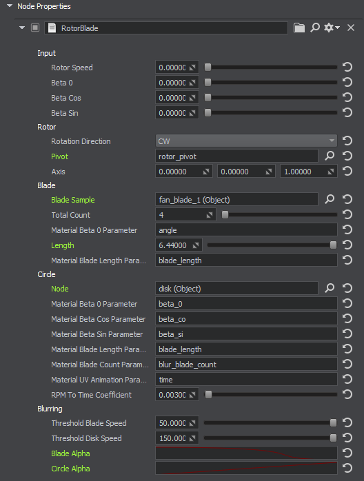

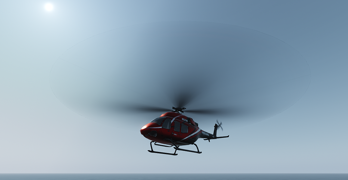

Rotor Blade#
The RotorBlade property controls the coning of the helicopter rotor blades and creates blurring to disk due to the blade rotation. To use this property, the rotor blade in your helicopter model should have a separate mesh and material.
Using this property also implies that you have the blade material (mesh_blade.mgraph in the add-on) and the node and material for circle into which the blades blur when rotating fast (check the disk node and mesh_blur_blades.mgraph material of the helicopter_simple Node Reference in the add-on).
Assign the RotorBlade property to the parent node (rotor node).
RotorBlade property
Speed Rotor rotation speed, in RPM. This is the default value that can be changed at runtime.
Beta 0 Parameter defining the coning angle. This is the default value that can be changed at runtime.
Beta Cos Parameter used for the longitudinal flapping. This is the default value that can be changed at runtime.
Beta Sin Parameter used for the lateral flapping. This is the default value that can be changed at runtime.
Rotor
Rotation Direction Direction of the rotor rotation.
Pivot Node to be rotated with the given RPM.
Axis Rotation axis of the pivot node.
Blade
Sample Single blade sample. The model should have only one blade, the number of blades is controlled by the Total Count parameter. The blade should have its own mesh and material independent from the helicopter model body. The material should provide for the blade bending visualization.
Length Blade length, in meters.
Total Count Total number of rotor blades. The blade sample is cloned the required number of times, equally spaced, and arranged in a circle.
Material Beta 0
Parameter
Name of the blade material parameter used to control the coning angle visualization.
Material Blade
Length Parameter
Name of the blade material parameter used to set the blade length.
Circle
Node The blurred circle node that replaces the blades at high RPM values.
Material Beta 0
Parameter
Name of the circle material parameter used to control the coning angle visualization.
Material Beta Cos
Parameter
Name of the circle material parameter used to control the longitudinal flapping visualization.
Material Beta Sin
Parameter
Name of the circle material parameter used to control the lateral flapping visualization.
Material Blade
Length Parameter
Name of the circle material parameter used to set the blade length.
Material Blade
Count Parameter
Name of the circle material parameter used to set the blade count.
Material UV Animation
Parameter
Name of the circle material parameter used to control the circle UV animation depending on the rotor RPM value.
RPM To Time
Coefficient
Multiplier to translate the RPM value to the UV animation parameter value.
Blurring
Threshold Blade Speed Rotation speed before which only blades are visible, and starting from which the blades begin to blur. The bottom value of the rotation speed interval at which both the blades and the blurred circle are visible.
Threshold Circle Speed Rotation speed starting from which only the blurred circle is rendered, the blades are no longer visible. The top value of the rotation speed interval at which both the blades and the blurred circle are visible.
Blade Alpha Curve controlling the blade transparency during the interval at which both the blades and the blurred circle are visible.
Circle Alpha Curve controlling the circle transparency during the interval at which both the blades and the blurred circle are visible.

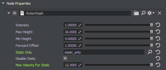

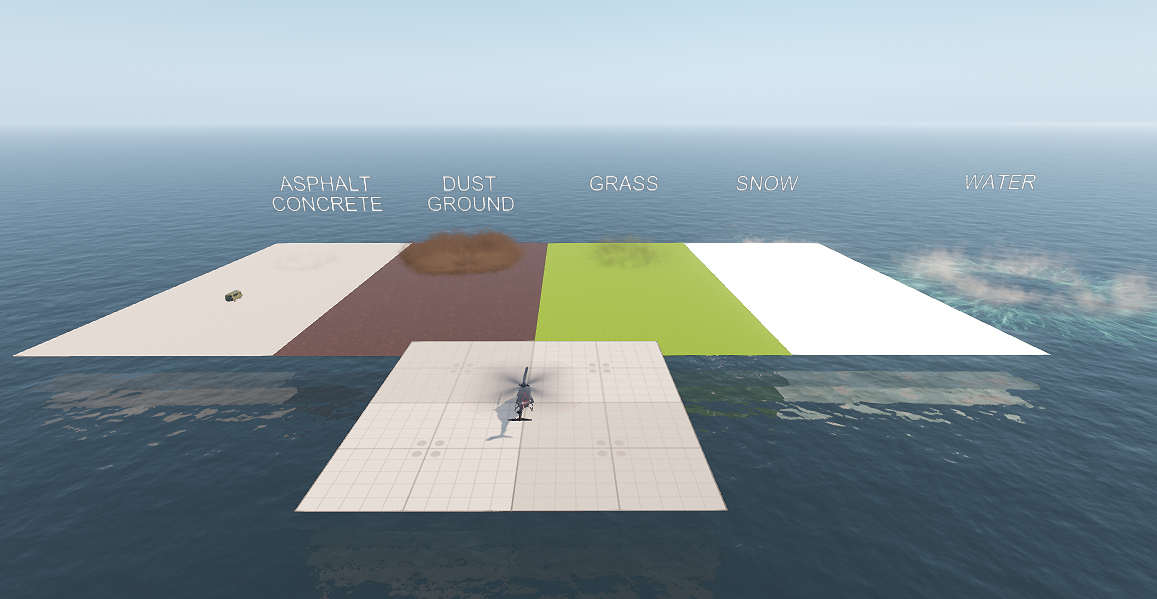

Rotor Wash Effect#
This component allows creating the effect of dust clouds raised up by the rotor wash when the helicopter is standing on the ground, taking off or landing, or flies close to the surface.
  1. Create the effects for each type of surface in UNIGINE Editor and assign the RotorWashEffect property to each of them. The following parameters are available:
    Intensity Rotor wash visibility intensity value. With the minimum value of 0 the effect is completely invisible. With the maximum value of 1 — completely visible. This is the default value that can be changed at runtime.
    Max Height Height of the node from the ground, at which the effect disappears.
    Min Height Height of the node from the ground, at which the effect has the maximum intensity.
    Forward Offset Multiplier to move the effect forward relative to the helicopter. The offset distance depends on the movement speed. This setting is intended to make the effect visible for the cockpit view.
    Static Only Root node for effects that are only displayed when the helicopter is not moving.
    Disable Static Disable the static effect node when the helicopter is moving. If the option is disabled (i.e. the static effect is enabled), the static effect is displayed throughout the whole life time of its particle systems. In most cases disabling this option (i.e. enabling the static effect visibility throughout the particles life time) is unnecessary, because the effect won’t be seen from the cockpit.
    Max Static Velocity Upper speed limit at which the helicopter is considered static (m/s).

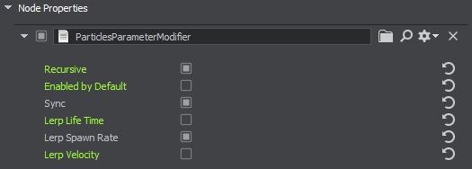

  2. Assign the modifier depending on the effect node type: ParticlesParameterModifier / DecalParameterModifier / FieldHeightParameterModifier. The modifiers are required for the alignment of the corresponding node (Particles/Decal/FieldHeight) with the effect.
    ParticlesParameterModifier has the following parameters:
    Recursive Toggles synchronization of child particle systems.
    Enabled by Default Toggles the node default state. If the node is disabled by default, you need to enable it via code after adding to the scene.
    Sync Synchronization of particles via Syncker. Recommended to enable only if synchronization via network is critical, because it may affect performance.
    Lerp Life Time Lerp the particles life time value with the effect intensity. If the effect intensity is equal to 0, the life time value also equals to 0.
    Lerp Spawn Rate Lerp the particles spawn rate value with the effect intensity. If the effect intensity is equal to 0, the spawn rate value also equals to 0.
    Lerp Velocity Lerp the particles velocity value with the effect intensity. If the effect intensity is equal to 0, the velocity value also equals to 0.
  3. Assign the RotorWashController property to the helicopter and select the type of surface corresponding to each effect.
  4. Set the surface type via code for each surface.

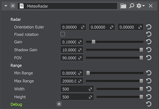

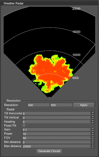

Weather Radar#
Weather radar (aka WSR) used to monitor weather ahead of the aircraft (clouds and precipitation) is an integral part of a professional flight simulator enabling pilots to train strategic and tactical planning of a safe flight trajectory. It is implemented as a MeteoRadar component and requires adequate skills to use it efficiently — accurately tune this system and interpret the weather radar display correctly. All key parameters of the radar are available for adjustment including display range (to monitor both the short-distance and long-distance weather), gain (for weather severity assessment), as well as tilt angles, FOV, and others. The radar works with 3D volumetric clouds generated by UNIGINE's advanced Clouds System ensuring consistency of radar readouts with the view from the aircraft cabin.
The intensity of clouds displayed on the radar is calculated as the cloud density at each point multiplied by the current humidity.
To use the weather radar, create a dummy node and assign the MeteoRadar component to it. The following parameters are available:
Radar
Orientation Euler Vector of Euler angles (pitch, roll, yaw).
Fixed Rotation Toggles the hiroscope for the meteo radar on and off.
Gain Sensitivity of the meteo radar. The higher the value, the less sensitive the radar (it shows only dangerous regions).
Shadow Gain Power of the meteo radar.
FOV FOV angle of the meteo radar in degrees.
Range
Min Range Minimum distance at which the radar displays the weather information (the lower limit of display range).
Max Range Maximum distance at which the radar displays the weather information (the upper limit of display range).
Width Width of the image on the radar display (number of horizontal lines).
Height Height of the image on the radar display (number of vertical lines).
Debug Toggles on and off visualization of the current direction of the radar.
The add-on includes an example of the meteo radar UI represented as the MeteoRadarWidget component and available in the Debug mode of the application. The interface example includes a display with a scan effect and a set of parameters that control radar settings and scan range.
