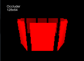

Occluder is rendered by the CPU and stored in a separate buffer. Only the Occluder nodes that are displayed in the viewport are saved to the buffer.
To display the buffer, you should pass 1 to the render_show_occluder console command:
Shell commands
render_show_occluder 1
The buffer will open in the upper left corner:
Simplified Occluder that is stored in the buffer
The buffer is rendered in a low resolution.
