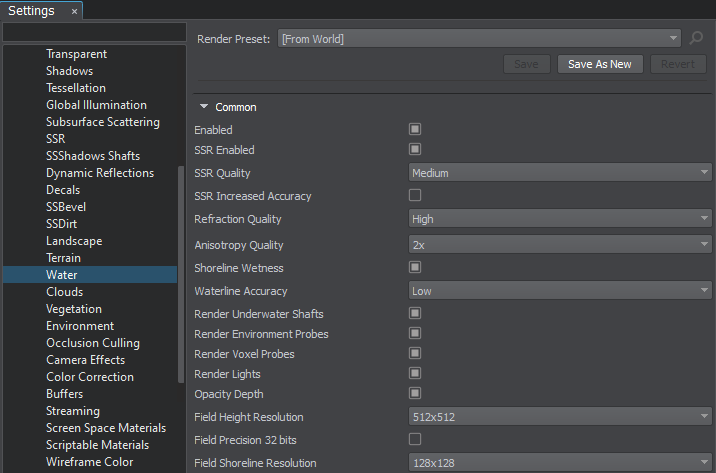

Common Settings#
Common Settings
Common Settings
Enabled The value indicating if rendering of water is enabled. enabled by default.
Console access: render_water_enabled (API control)
SSR Enabled The value indicating if the SSR (Screen Space Reflections) effect is enabled for water. enabled by default.
Console access: render_water_ssr (API control)
SSR Quality The resolution of water SSR (Screen Space Reflections). One of the following values:
  • Low - low quality
  • High - high quality
  • Ultra - ultra quality
Console access: render_water_ssr_quality (API control)
SSR Increased Accuracy The value indicating if increased accuracy for the water SSR (Screen Space Reflections). This option reduces visual artifacts by increasing accuracy of the last step. disabled by default.
Console access: render_water_ssr_increased_accuracy (API control)
Refraction Quality The quality of water refraction. One of the following values:
  • Low - low quality
  • Medium - medium quality
  • High - high quality (by default)
Console access: render_water_refraction_quality (API control)
Anisotropy Quality The water texture anisotropy level. The following values are available:
  • 1x — anisotropy level 1
  • 2x — anisotropy level 2
  • 4x — anisotropy level 4
  • 8x — anisotropy level 8
  • 16x — anisotropy level 16
Console access: render_water_anisotropy (API control)
Shoreline Wetness The value indicating if the wetness effect for objects near the shoreline is enabled. enabled by default.
Console access: render_water_shoreline_wetness (API control)
Waterline Accuracy The quality of underwater and waterline determination. Use high quality only if you need to submerge underwater (to see the waterline) and at medium and high Beaufort values. One of the following values:
  • Low - low quality (by default)
Console access: render_water_waterline_accuracy (API control)
Render Underwater Shafts The value indicating if rendering of underwater shafts is enabled. enabled by default.
Console access: render_water_shafts (API control)
Render Environment Probes The value indicating if rendering of environment probes on the water surface is enabled. enabled by default.
Console access: render_water_environment_probes (API control)
Render Voxel Probes The value indicating if voxel probes are enabled for water rendering. enabled by default.
Console access: render_water_voxel_probes (API control)
Render Lights The value indicating if rendering of lights on the water surface is enabled.
enabled by default.
Console access: render_water_lights (API control)
Opacity Depth The value indicating if depth data for water is written to the opacity buffer. enabled by default.
Console access: render_water_opacity_depth (API control)
Field Height Resolution The resolution of the texture into which all textures set for all FieldHeight objects are rendered.
  • 128 x 128
  • 256 x 256
  • 512 x 512 (by default)
  • 1024 x 1024
  • 2048 x 2048
  • 4096 x 4096
  • 8192 x 8192
Console access: render_field_height_resolution (API control)
Field Precision 32 bits The value indicating the precision of textures used for field objects. Either of the following:
  • 16-bit precision R16 texture
  • 32-bit precision R32F texture
Console access: render_field_precision (API control)
Field Shoreline Resolution The resolution of the texture into which all textures set for all FieldShoreline objects are rendered.
  • 128x128 (by default)
  • 256x256
  • 512x512
  • 1024x1024
  • 2048x2048
  • 4096x4096
  • 8192x8192
Console access: render_field_shoreline_resolution (API control)

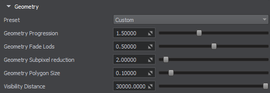

Geometry Settings#
Geometry Settings
Geometry Settings
Preset The index of the Global Water geometry preset used at the moment. To customize the Global Water geometry preset options at run time you should activate the Custom preset: One of the following values:
  • Low (by default)
  • Medium
  • High
  • Ultra
  • Extreme
  • Custom
Console access: render_water_geometry_preset (API control)
Customizable Settings#
Geometry Progression The progression of Global Water geometry tessellation.
Range of values: [0.0f, 50.0f]. The default value is : 1.5f.
Console access: render_water_geometry_progression (API control)
Geometry Fade Lods The intensity of fading between levels of Global Water geometry tessellation. This value can be increased to remove sharp edges between areas with different geometry density.
Console access: render_water_geometry_fade_lods (API control)
Geometry Subpixel Reduction The minimum ratio of a polygon size (in screen space) to the size of an area seen in the viewport. If the ratio calculated for the polygon is less than this value, such polygon will be removed.
Range of values: [0.0f, 50.0f]. The default value is : 6.0f.
Console access: render_water_geometry_subpixel_reduction (API control)
Geometry Polygon Size The size of Global Water polygons. The value defines the maximum allowed density of Global Water geometry. If the polygon size is large, small waves will be lost. It is better to set this parameter to about 1/3 or 1/4 of the smallest wavelength.
Range of values: [0.0f, 1000.0f]. The default value is : 0.01f.
Console access: render_water_geometry_polygon_size (API control)
Visibility Distance The maximum visibility distance for the Global Water. The water is visible, as long as the distance between the camera and the water object does not exceed this value.
Range of values: [0.0f, inf]. The default value is : 30000.0f.
Console access: render_water_visible_distance (API control)
