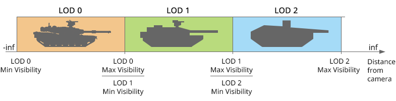

Visibility Distances
The LODs visibility parameters are defined by the visibility range. It is set by two parameters: the minimum visibility and maximum visibility distances measured from the camera. If the surface is within the range specified by these bounds, it is displayed, otherwise, it is hidden.
  • The minimum visibility distance is the distance from the camera when a surface starts to appear on the screen. By default it is -inf.
  • The maximum visibility distance is the distance when a surface is no longer fully visible: it can either disappear completely or start to fade out. By default it is inf.
Ranges for surfaces that represent different LODs of the same object should not overlap.

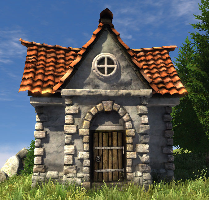

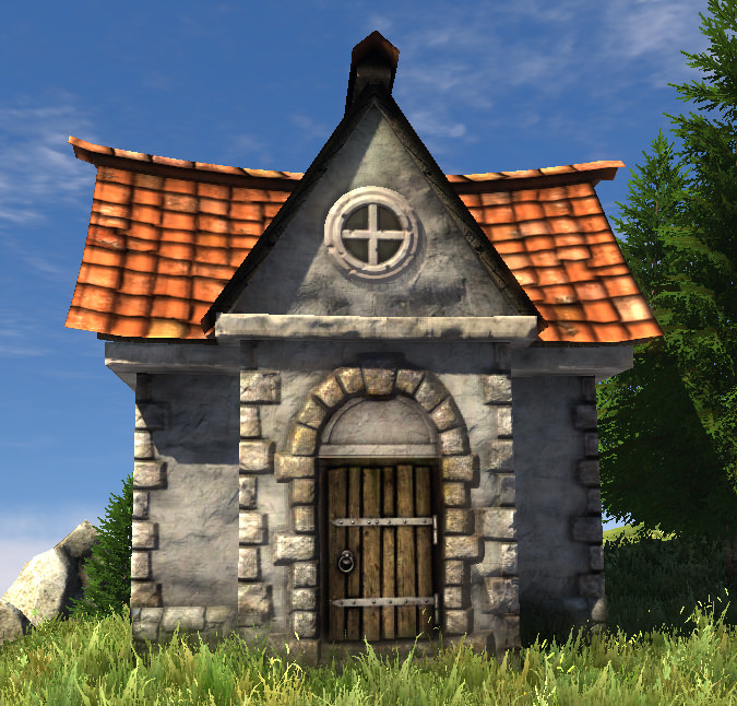

Let's take a model of the house, for example. When the camera is close by, the high-poly detail surfaces are seen, such as the door arch, stone corners, round window and roof tiles. When we move away, all these surfaces should be simultaneously changed by one united low-poly LOD surface.
Merging several surfaces into one reduces the number of objects to draw, hence, it reduces the number of DIP requests and speeds up rendering.
High-poly model
High-poly model
Low-poly model
Low-poly model to be used as distant LOD

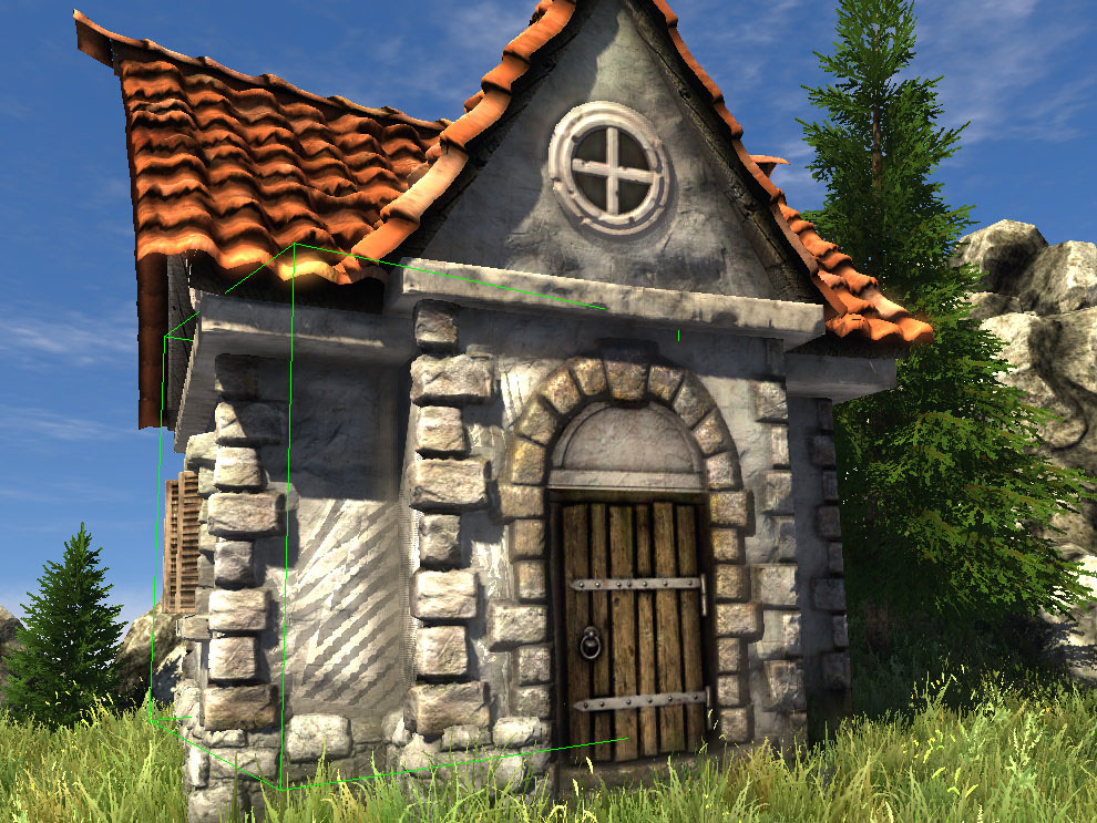

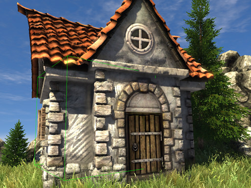

The problem is, all these detailed surfaces have different bounding boxes. So if their distances are checked for themselves (0 as min and max parents), we can have a situation when LODs of different parts of the house are turned on (or off) unequally, because their bounding boxes will be closer to the camera. This may cause z-fighting artifacts. Here the distant corner has not yet switched to a more detailed LOD, while the close one is drawn twice: as a high-poly corner LOD and at the same time the united low-poly house LOD.
Two LODs switched on at once
Measuring LODs distance to surfaces can cause artifacts: two LODs switched on at once

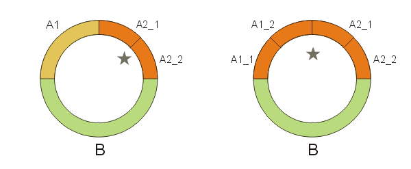

If we set a bounding box of the whole house to be a reference object (min and max parent to 1), all surfaces will switch on simultaneously no matter what side we approach the house from.
One more option is to use different reference objects when check. For example, the lower bound (minimum distance) is checked for the surface itself, and the upper bound (maximum distance) is checked for the parent. This may sound complicated, so take a look at the pictures below. The first picture shows a ring, which is split into surfaces according to levels of details.

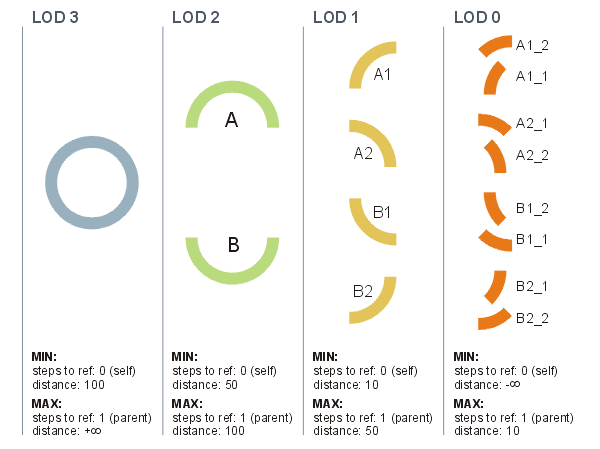

Levels of details of a ring
Levels of details of a ring. Surfaces on the left are parents to surfaces on the right
Here, surfaces from the rightmost column will be displayed, when the camera is very close to them. The leftmost surfaces will be displayed, when the camera is very far from them. Merging of several surfaces into one reduces the number of objects to draw, hence, reduces the number of DIP requests and speeds up rendering.
Note that all of the minimum distances here are measured to the surface itself, but almost all of the maximum distances are measured to another reference object, a parent. One more picture will help you to understand, why it is so.
Usage of different reference objects
An example of using measurements of distances to different reference objects.
A star is the camera; it doesn't matter now what exactly the camera will be looking at. On both images, required surfaces are drawn according to the camera position and distances from the camera to the corresponding reference objects. For example, on the left image, the upper left part of the ring is a single surface, the upper right part is split in two separate surfaces, and the bottom part is also a single surface. On the right image, the whole upper part is divided into the smallest possible sectors.
Here, distances are measured to different reference objects to properly "turn off" smaller single sectors and display a larger sector instead. The maximum distance is calculated to the parent sector, because the distances to the neighboring subsectors may differ too much. The minimum distance is calculated to the current sector, because we need to show it, if the camera is too close to it.

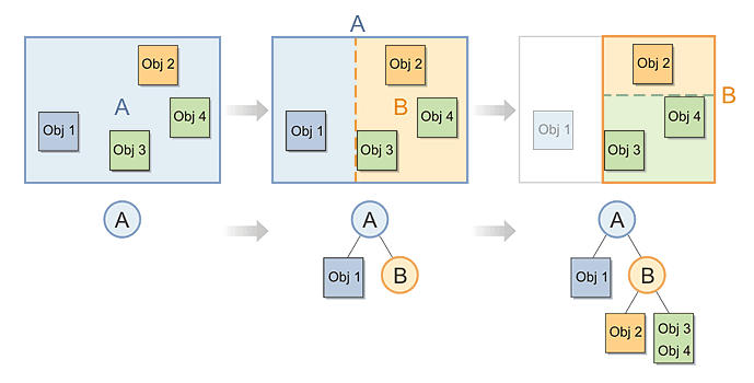

Binary space partitioning is a method for dividing the scene along the axes into the regions that are dealt with individually and thus are easier to manage. BSP tree is a hierarchical structure obtained by division and organizing all the scene data. The adaptive behavior allows to optimize the BSP algorithm by adjusting sizes of the regions to the processed geometry and distribution of objects in the world.
The BSP tree is built in the following way:
Binary space partitioning tree
  1. The root node is created. It is done by simply spanning an axis-aligned bounding box over the whole scene.
  2. The space of the bounding box is recursively subdivided into two regions by a partitioning plane that is perpendicular to one of the three major axes. As a result, two nodes of the tree are created. Each of these nodes is again enclosed in an axis-aligned bounding box and this step is repeated for each of them until the whole scene geometry is represented.
  3. The subdivision is stopped when the level with required number of editor nodes is reached.
    If the partitioning plane at a certain level splits an object, such object stays at the previous level and does not slide down the tree. It often happens with big and extensive objects, like sky or huge buildings.
During rendering, the engine loops through the BSP nodes to determine whether their bounding boxes are intersected by the viewing frustum. If a node passes this test, the same action is repeated for its children until a leaf node or a node that is outside the viewing frustum is reached. All necessary calculations are performed for visible regions, while the rest of the scene (i.e. objects and their lighting ) is discarded.
The tree is regenerated on the fly each time an object is added or removed from the world as well as when the object changes its status to collider or clutter object. If there were no changes, the tree remains the same. This quality makes adaptive BSP efficient not only when rendering static geometry, but also for handling dynamic objects.

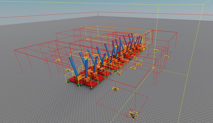

Use the world_show_spatial console command to enable spatial tree visualization.
Spatial tree visualization

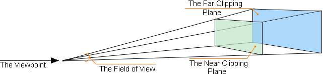

A viewing frustum (or a view frustum) is a field of view of the virtual camera for the perspective projection; in other words, it is the part of the world space that is seen on the screen. Its exact shape depends on the camera being simulated, but often it is simply a frustum of a rectangular pyramid. The planes of the viewing frustum that are parallel to the screen are called the near plane and the far plane.
Viewing frustum
The Viewing Frustum
As the field of view of the camera is not infinite, there are objects that do not get inside it. For example, objects that are closer to the viewer than the near plane will not be visible. The same is true for the objects beyond the far plane, if it is not placed at infinity, or for the objects cut off by the side faces. As such objects are invisible anyway, one can skip their drawing. The process of discarding unseen objects is called viewing frustum culling.

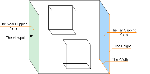

Orthographic Projection#
When the human eye looks at a scene, objects in the distance appear smaller than objects close by. Orthographic projection ignores this effect to allow the creation of to-scale drawings for construction and engineering.
With an orthographic projection, the viewing volume is a rectangular parallelepiped, or more informally, a box. Unlike perspective projection, the size of the viewing volume doesn't change from one end to the other, so distance from the camera doesn't affect how large an object appears.
Viewing box
The Viewing Box
To activate the orthographic mode for the camera, check the Ortho option in the Camera Settings window.

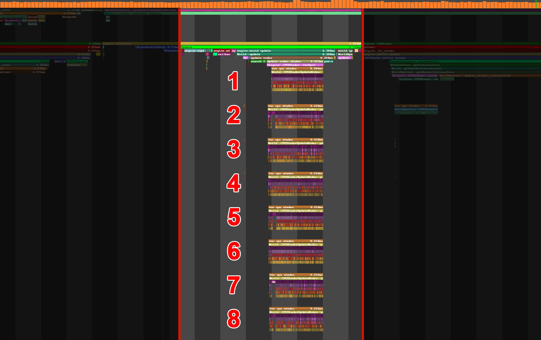

Multi-threaded Update of Nodes#
Nodes are updated in the multi-threaded mode, which can substantially increase performance. For example, this can be very handy when a big number of particle systems or dynamic meshes are rendered in the world.
Multi-threaded update of nodes.
Asynchronous update of nodes in the world depends on their type and hierarchy. It's important to take this into consideration for the most performance-demanding projects.
There are three modes for different types of nodes:
Nodes can change their update mode at run time, for example, assigning a physical body to an ObjectDummy switches its update mode to dependent. Visibility of an object (be it a particle system or a skinned mesh with animation played) has an impact on how often it is updated.
Extended use of multithreading in combination with an internal task system ensures that load is distributed evenly between all available threads.
