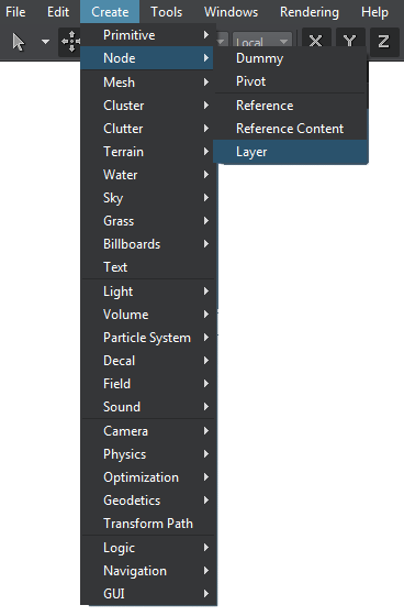

To add a new layer via UnigineEditor do the following:
  1. Run UnigineEditor.
  2. On the Menu bar, click Create -> Node -> Layer.
  3. In the Save Node file dialog window that opens, specify a name for the .node file into which child nodes of the layer will be saved.
  4. Place the layer node in the world.

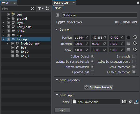

Editing a Layer Node#
Changes made in the child nodes of the layer node are saved on the disk when:
  • Clicking Save in the Node tab of the Parameters window.
  • Saving the world via File -> Save World or by pressing Ctrl+S.
In both cases only the .node file will be updated.
Node Tab
The .node file contains all child nodes of the layer node. All changes made in child nodes of the layer node do not affect the source .world file.
The layer node itself is not stored in the .node file.
