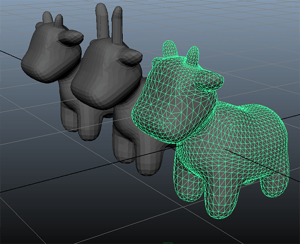

This section shows the way of exporting meshes with blend shapes in the FBX format from Autodesk Maya. It contains an example mesh of a calf, which has 2 blend shapes (morph targets).

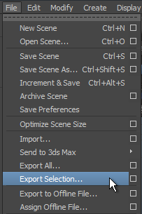

  1. In Autodesk Maya, select the mesh with blend shapes to be exported.
  2. In the main menu, click File -> Export Selection...

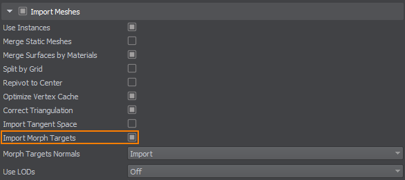

  1. Import the *.fbx file with the Import Morph Targets option enabled.

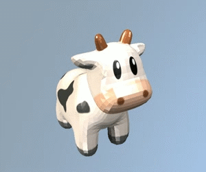

After assigning the component to the mesh, the result looks as follows:
