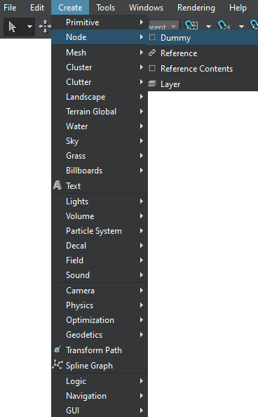

To add a Node Dummy to the scene via UnigineEditor do the following:
  1. Run UnigineEditor.
  2. On the Menu bar, click Create -> Node -> Dummy.
  3. Place the Node Dummy somewhere in the world.
