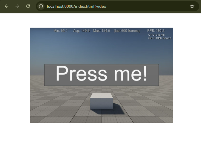

If the player name is not set in the address at all, i.e. the link looks like:
  • localhost:8000/index.html?video=
    or
  • localhost:8000
the image is streamed as rendered by Main Player.

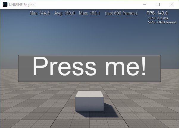

Engine image: Streamed image:

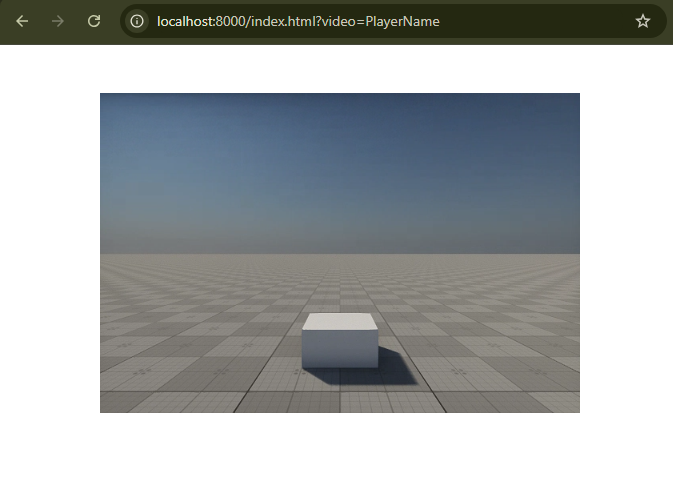

If the player with the specified name does not exist in the current world on the streaming server computer, you'll see a fallback view from the current camera on the streaming server, but without any post-effects and GUI.
Image streamed without GUI because the specified player has not been found
