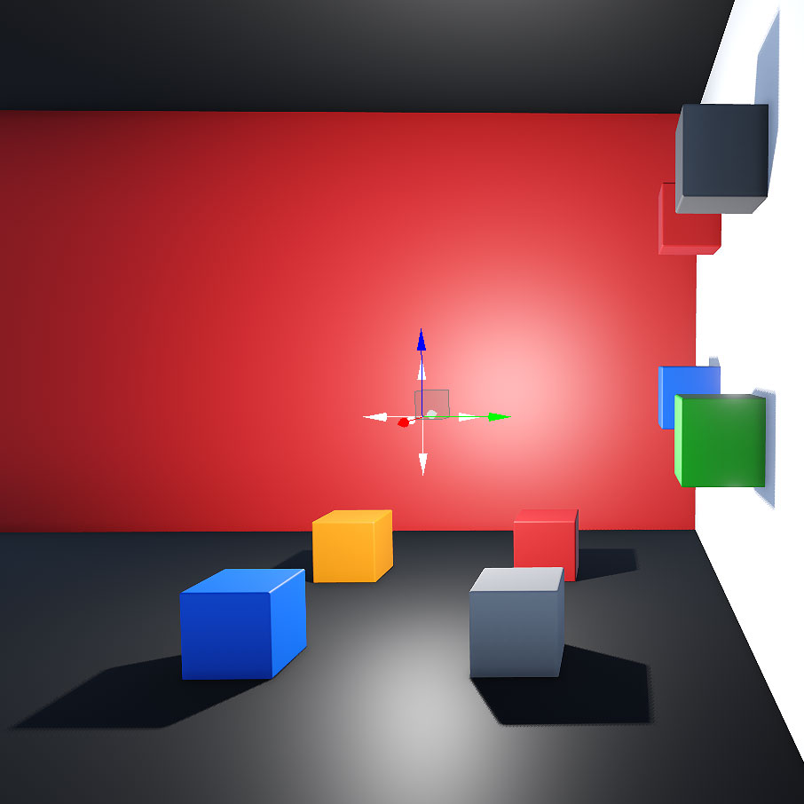

LightOmni
(omnidirectional point light)
Emits light from a point source in all directions. Emits light from a point source in all directions and uses a prebaked shadow cubemap for static objects lit by Omni Light.

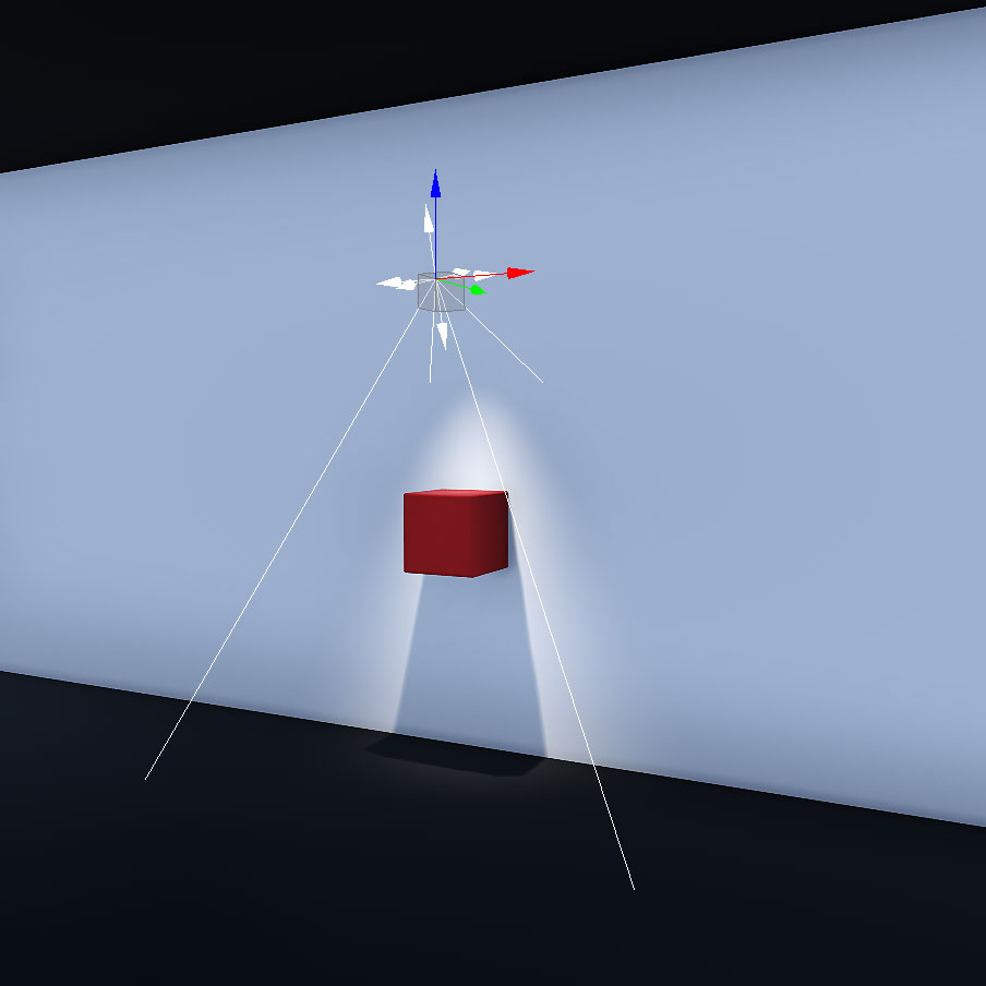

LightProj
(projected light)
Emits light from a single point forming a focused beam aimed in a specific direction. Emits light from a single point forming a focused beam aimed in a specific direction and uses a prebaked 2D depth texture to store shadows of static objects lit by Projected Light.

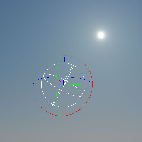

LightWorld
(sun light)
Casts parallel beams onto the scene from an infinitely remote point.

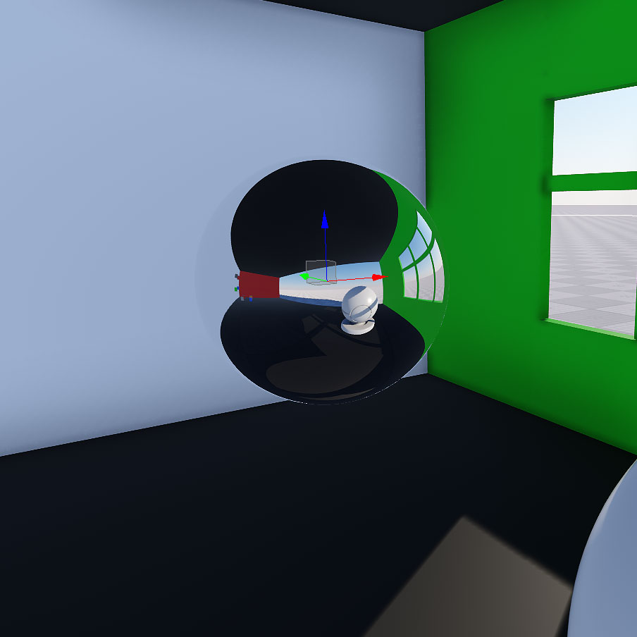

LightEnvironmentProbe
(Environment Probe)
Grabs a cubemap each frame thus providing objects in the scene with dynamic reflections from a point source in all directions. Uses a prebaked cubemap to provide objects in the scene with reflections from a point source in all directions.

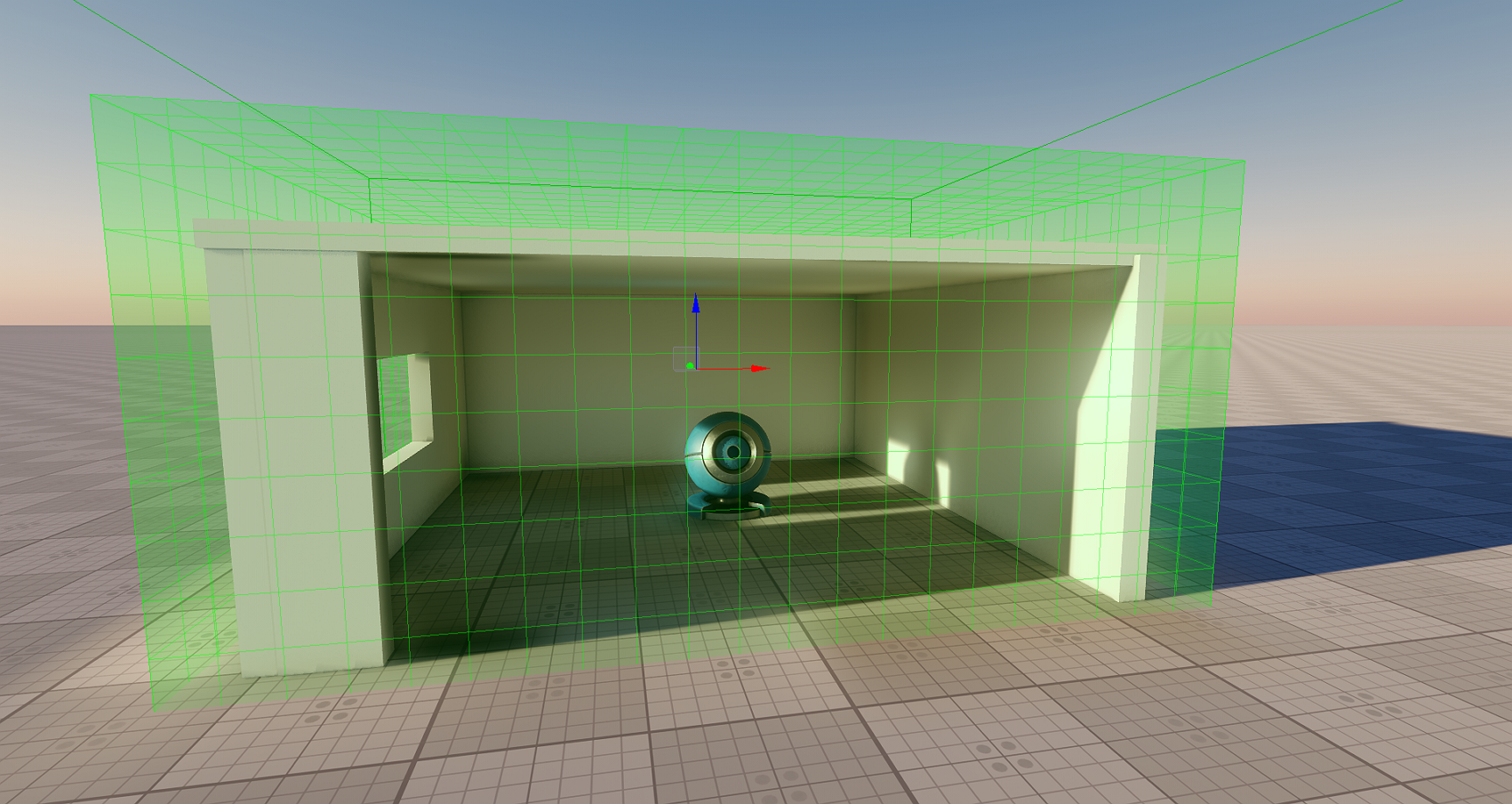

LightVoxelProbe
(Voxel Probe)
Provides volume to bake lighting. Uses a prebaked voxel map to provide objects in the scene with indirect lighting from any light source.

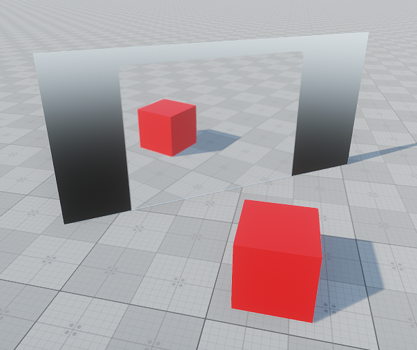

LightPlanarProbe
(Planar Reflection Probe)
Сaptures and projects a reflection relative to the camera onto a surface like a mirror. Uses a temporary texture created every frame.

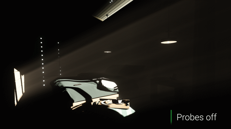

The basic workflow is to use dynamic light sources and Voxel Probe for lighting, and Environment Probe for reflections. This approach ensures the best result, however, you can also enable both lighting and reflections for Voxel or Environment Probe via the corresponding options.
Light sources provide lighting to surfaces in the following priority:
  1. Omni, Projected and World light sources' dynamic direct light.
  2. Voxel probe's ambient light and/or reflection.
  3. Environment probe's ambient light and/or reflection.
