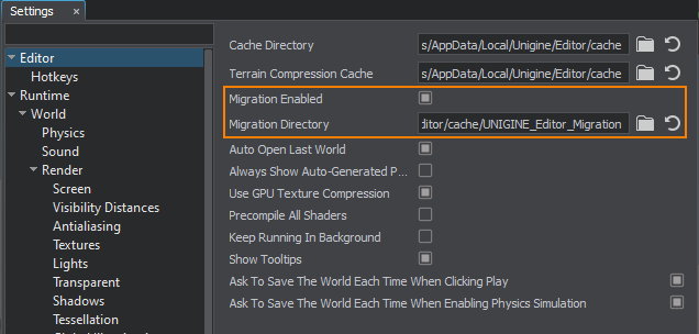

To toggle upgrading on and off and specify the migration folder, go to the Editor section of the Settings window:
The Migration Directory is a temporary folder for the outdated assets: they are copied into this folder and processed by the upgrade script. Then the upgraded assets replace the original ones.
